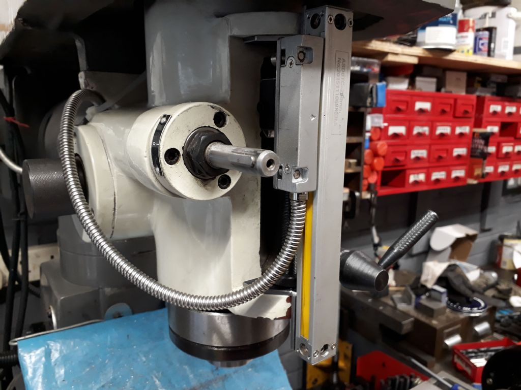

          Admittedly they look like glassin their example, not magnetic scales, but the mounting principle is similar. Have you contacted them for their views on the subject?
          I have a Warco VMC; virtually identical to the Myford version and I had to fabricate all the mounting brackets from angle aluminium that I happened to have lying around. Not aesthetically pleasing, perhaps, but functional and robust for all that. There are some pictures in my Warco VMC album. The Z-axis was a little awkward in as much as the vertical face of the body to which the scale is attached is NOT vertical. I measured the angular difference with a digital angle gauge and made up a couple of spacers with one side machined to that angle and drilled through to accept the mounting screws, thus providing mountings which were truly parallel with the Z-axis slide ways.
          z-axis mounting
          The right angle joints are secured with elongated slots so as to obtain articulation of the mounting to assist in the alignment.
          It doesn't answer your original question, but I think you are going to have to bite the bullet and be a trailblazer for your particular machine/DRO combination. If you do, share your results on here, for the benefit others in the same position.
          Afterthought: Granted the magnetic scales are smaller and, arguably, easier to mount, but I have found that glass scales, though bulkier, can be accommodated reasonably easily on the VMC. It's a hefty bit of kit for a home workshop. And they're cheaper!
          Hope that helps,

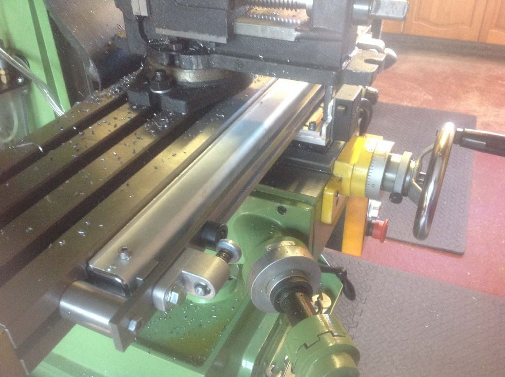

                                    I see that you have the same x-axis power as me. The following photo may give you some food for thought on mounting the travel stops and power feed limit switch stops
                                    x-axis scale 2
                                    To clarify; it consists of a BMS strip mounted on stand-offs bolted to the dovetail in the front face of the table. The strip is drilled to accept the power feed limit switch actuators and slotted to accept the travel limit stops. It helped that Warco supplied a 400mm scale for the x-axis, which left room at the ends to fix the stand-offs. The travel stop actuator was incorporated into the x-axis read head mount, seen more clearly in another of the photos in my Warco VMC album.
                                    In practice, I have found I never used any of these stops and removed the set-up very soon after fitting it, to be replaced with a longer, 600mm glass scale. That was prompted by the failure of the 400mm z-axis scale, so the original 400mm unit was repurposed in that position.

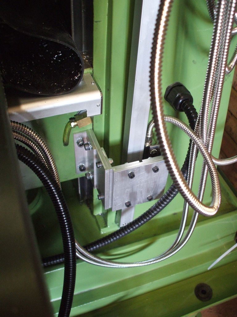

                                            Only just seen this post. There are photos of a Machine-DRO installation on my Warco VMC in one of my albums.

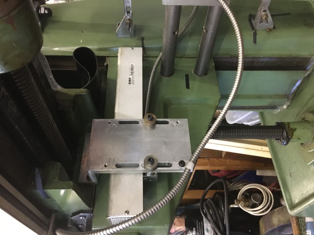

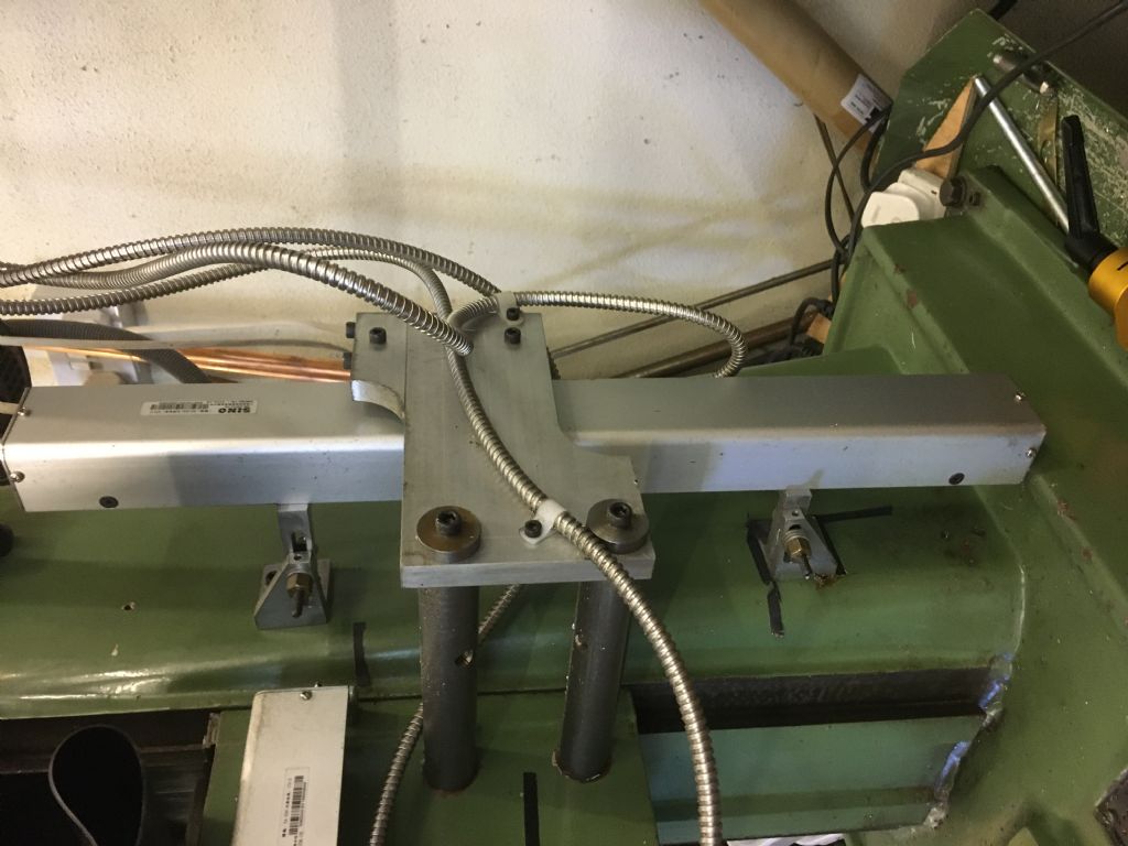

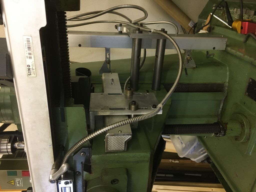

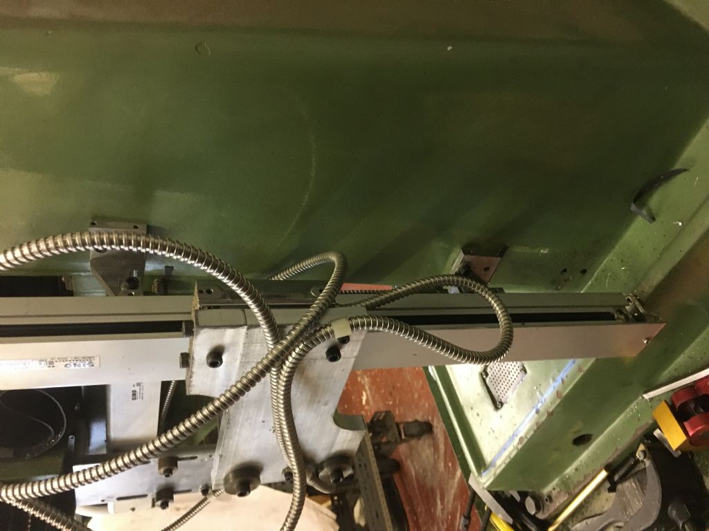

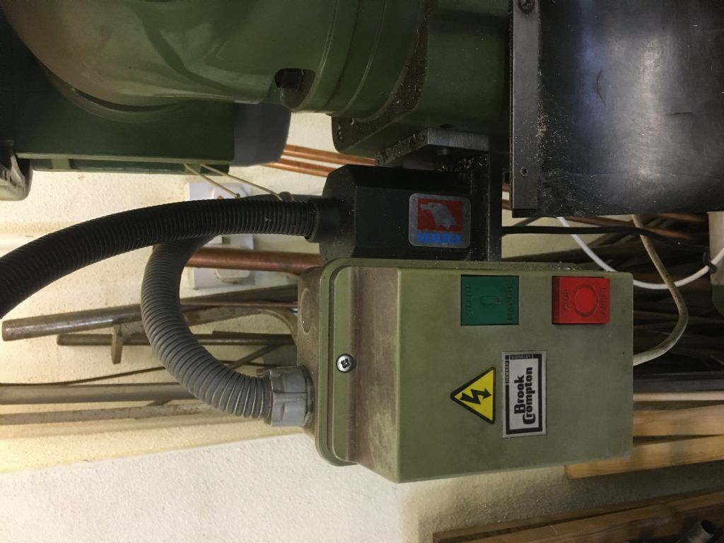

                                                I have a green Myford VMC purchased in 1991. I fitted a 3-axis set of encoders supplied by Machine DRO/Allendale some 10 years ago. I believe these were the glass type as the magnetic encoders were not on the market at that time. It took a long time to fit and I enclose a few photos which I hope you find useful. As previously mentioned, if the X scale is mounted on the front face of the table, then you will lose the end stops and possibly the oil holes. If you fit it on the rear of the table you will lose Y travel.
                                                I have also made a minor modification to the VMC On/Off switch mounting using spare brackets from the DRO mounting kit so the switch faces forwards.
                                                The Sinho DRO display box I purchased has a problem where if you are using any of the special functions such as Pocket Milling, it will not function correctly unless all the measurements are entered in metric. This will hopefully have been addressed by the manufacturers over the years but it did fox me at first! Normal X, Y, Z DRO operation work well. It may be worth checking this before you get going.
                                                Now with apologies for the orientation I include the photos. I have tried rotating these photos both in Windows and the tools in this web site with no luck!

                                                  Hi Ian,
                                                  Thank you for the series of photos. All really clear and the right way up. Its really helpful to see the choices you made – I am now considering going on the front of the table rather thank losing Y axis travel. I think i will end up directly lubricating the table ways so not too worried about obscuring the oiling points. I am not sure how much i would have trusted. used the end stops too. Y axis travel is more valuable i think.
                                                  I love what you did with the power switch/ lamp mounting,
                                                  One question – was there a reason you ended up with the fairly large degree of stand off on the z axis strip? I was planning on keeping it snog to the pillar withe the stand off dictated only by the slope at the top.
                                                  #615705

                                                    Brian, thank you for the photos. I love the way you mounted the Y axis encoder, really nice. Can i ask what you used for the z axis mountings onto the pillar – i.e. how you kept everything so close/ adjustable? Do you miss Y axis travel or not a problem in reality?

                                                      Pleased the photos are of some help. Yes, you could possibly mount the Z scale a little nearer the column and save around 1" in its current orientation. It may also be possible to rotate the Z scale vertically clockwise by 90 deg avoiding the large bracket taking the movement to the slide. This would allow you to move the scale even nearer, but at the expense of more complicated fixing brackets. I try to mount the scales with the reading head facing away from the source of the swarf etc.
                                                      Not really for this thread, but I have had the Y nut come loose. I noticed this when the DRO Y display showed a different value to what the thimble was showing. When I strip the table to correct this I am hoping to fit a manual pumped oil feed system to all the slides. Lastly, I have also noticed that some R8 tooling has developed a burr on the keyway slot, so something may have damaged the locating pin in the spindle bore.
