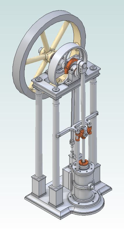

        Although I do a 3D model of all my engines and check holes line up and moving parts like cranks and conrods won't hit anything when turning I seldom print off drawings for use in the workshop to actually make the thing from. Typical 3D of the one I'm currently working on. I just take off what sizes I need from the 3D part and get on with making it
        I hope this won't make anyone choke on theirbeer but this is what it's built from, I think there is even an envelope or two in there and just one printed drawing.blush
        But it seems to work for me as yesterdays little video shows. If it's going in the mag or for work then I'll approach things a bit differently

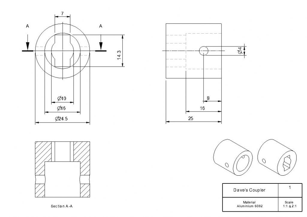

                              This is the fruit of this afternoon's interrupted labours, no peace for the wicked:
                              Happier with this, done by spreading the dimensions across views. Need to try a more complex example though – the coupler is pretty simple. Delighted to get more suggestions.

                                        Dave, looking at your drawing there are a few points
                                        I still think it looks a bit cluttered, if the isometric views were separated from the actual 2D working drawings you could lay it out better, maybe make the iso ones smaller.
                                        The 4.00dia as close to the 8.00mm dimension and also the opposite end of the 16dia arrow
                                        The 4mm hole does not have a dimension from the end of the workpiece.
                                        This has lost a bit of clarity being snipped but clearer if clicked on. I think just the two elevations can hold all the dimensions needed buy have added a section for good measure. Isometric have been made smaller and away from the 2D. Dimension lines on the two elevations have been lined up with each other which looks neater. All on an A4 sheet

                                            Ian's post above sums it up for me, as I'm only ever going to be making stuff for me. So it simply isn't worth the time to learn how to make any drawings match a standard other than the one that makes sense to me.
                                            So while Jason's latest revision is clear, I would still change it to suit the way I would make the part:
                                            the diameters would be moved to the top right, along with the lengths, as they're all done as part of the same setup.
                                            I would move all of the dimensions for the 4mm cross-hole to the the section, because it's another setup.
                                            And the top left would only have the dimension for the slot – width, height and hole diameter.
                                            All of that would immediately make sense to me when I come to make the part 18months after designing it…
                                            After all, the drawing is only a step on the way to having the actual part working.
                                            As for tolerances, I would suggest that the only bits that matter are the slot and the cross-hole; everything else is either there to place the holes, or for clearance around the coupled parts so appropriate methods apply – like starting the 16mm bore with a 5/8" drill then finishing and flattening the bottom with a 16mm endmill, or cleaning up the outside diameter of 1" bar with some emery tape.

                                              Yes we can all do it as suits our needs as per my rouch sketches.
                                              Regarding The post above I personally try to avoid dimensioning hidden detail and if you look at some of my drawings in the mag I may well have called out "16dia x 16deep" .Or dimentioned the section and not had the side elevation.
                                              Also if grouping for setup then I would have the 10mm hole with the other concentric diameters and have drilled right through 10mm then opened up the 16mm. all while in the lathe.

                                                    Special Mention in Despatches for Nicholas. His version gets the prize for maximum information in the smallest spacer without clutter:
                                                    Unfortunately, it's a little unexpected, and as Nicholas says: 'Doing that simple part was tedious, it isn't practical for a complicated one.' One oddity, when I first looked at it I saw an Einstein's Head inversion! Despite the brief optical illusion I like it. I believe FreeCAD/TechDraw could create most of the drawing automatically, so it may be more practical than Nick believes. I'll try it later.
                                                    First prize goes to Jason.
                                                    It's cleaner than my attempt and I'm sure TechDraw can do the same. Watch this space.
