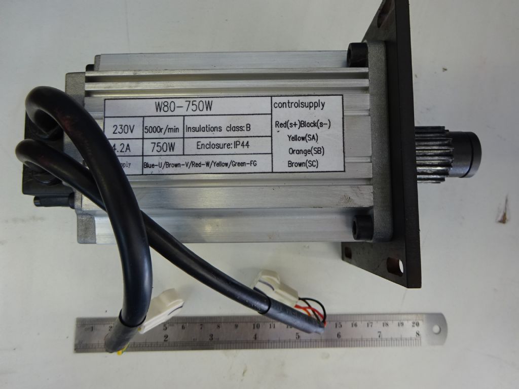

                      #402830
                        And if you look on some of the brushless motors they have 230V on the label.
