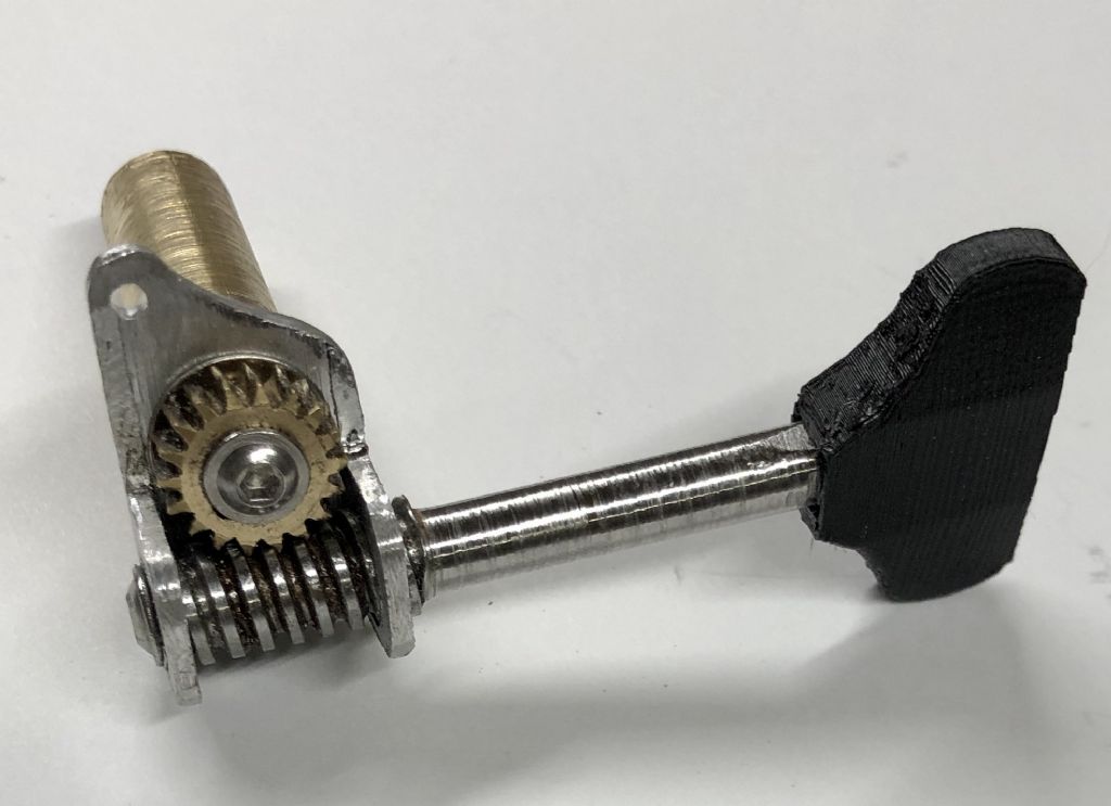

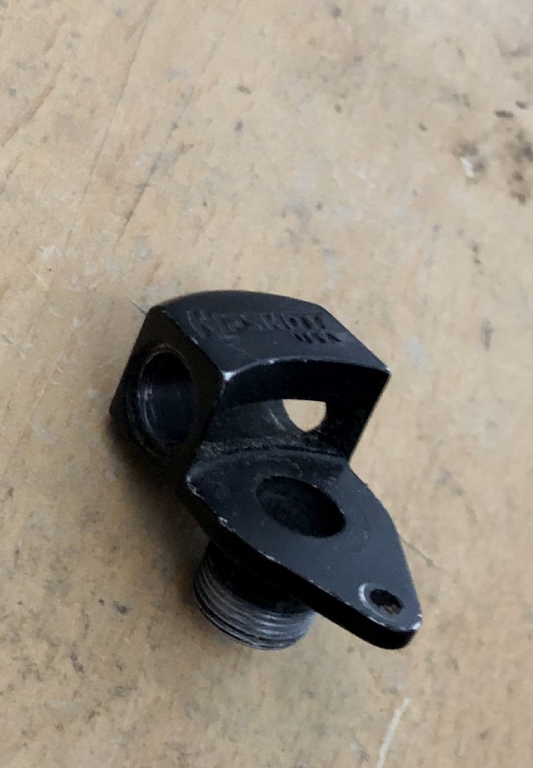

        Im looking to buy a milling machine – never operated one before and i can't wait to start learning (I have milled on my lathe to a fashion so not entirely green).
        However….. just through searching & reading posts on here i've already changed my mind a few times, so some advice off you good people is in order i believe….
        I started off wanting the Clarke CL500 with milling attachment – a very capable machine no doubt, but having read some of the issues people have had with the build quality & fettling to get it set up right i've had second thoughts – plus the fact that the ebay crowd are asking 100 quid short of the RRP for a second & third hand machine really takes the biscuit! So i've decided that i'll get a mill & upgrade my lathe at a later date.
        I've looked on Axminster – always thought they were a bit pricey with woodworking tools so never really had much off them & the mills they have in my price range are about as inspiring as the machine mart catalogue, so thats a no go.
        Warco – really impressed but a bit out of my price range, same as the Seig machines from ARC,
        But…
        I have £500 at the mo & i would say £600 – £650 is my limit, i've seen some nice Warco machines, one at £650 i would love but its over a 4hr drive & my car & funds won't stretch that far, so do i hold out for one close to me or do i buy new?
        The only new ones i can afford are the micro range, i'm not planning on machining big stuff but i also don't want to buy one that i will want to upgrade after a year or two – although the Clarke CMD300 is online for £637, but is it worth it?
        Extra tooling is a bonus, but its also something i can buy as i go along so i'm not too fussed about that.
        In reality this is what i will be making, i use stainless steel, brass & aluminium, when i make a bridge (the stainless angle thing) i cut it from angle & hand finish it, but it would be nice to have the option to mill it from a solid block if i could
        The other two pics are what i need the accuracy for, making my own tuners is where i'm at now & for that i need to be able to mill accurately, preferably from aluminium but most likely from stainless or brass (not the worm gear & drive just yet).
        I'd welcome any advice you may have for me as i'm at a loss & don't fancy buying something that i'll regret when i get it home & try to work on it (just like i did with my lathe…)

          Hello Paul, I'm surprised that no one has chipped in yet!
          I think that the stainless steel will be the deciding factor, you need quite a rigid machine to tackle this, even the free cutting varieties.
          For the budget I suspect that a used machine would be the answer, the problem being to get a good one.
          ! could suggest a couple of suppliers in the Nottingham area who are reliable and I'm sure others could recommend suppliers elsewhere.

                                Paul: Your idea of milling stainless parts (as your picture) from solid will take hours, and is likely to wear out your cutters and your patience. Cutting away most of a solid block, when angled stock of the right thickness is available (as your picture) offers no advantages, and is likely to end with distortion of the workpiece as you have removed any internal stresses. If good finish is what you seek, I suggest a polishing spindle and a selection of mops.

                                  I can't help with the core question. I have recently bought a Seig SX1LP from ARC. It meets my needs fine.
                                  One thing I would say is to remember to budget for tooling, clamping, vices etc. I was warned to budget for at least as much again as the mill for a decent set of tooling and work holding. I can believe it from what I have spent so far!! When keeping your eye out, look for something that comes with a reasonable amount of tooling.
                                  That curved top edge on the bridge is going to need some sort of rotating work holding (or a CNC setup – which is a whole different game!)

                                      Do you just want to make components of similar size and complexity to those in your pictures or do you want to go the whole hog and get into home shop / hobby machining?
                                      Thinking out of the box.
                                      If you only want to make a few varieties of parts like those in your pictures I wonder if one of the more rigid varieties of small desktop CNC router devices might be up to the job. There seem to be a number of versions built in Plano-Mill style with the side arms fixed and the table moving in both X and Y which should be much more rigid than the original versions where the side arms move.
                                      Working areas look to be maybe 9" square by 3" deep. Which might be enough. Obviously not up to heavy, proper engineering level, cuts but a carbide cutter whizzing round at high speed will get the job done, eventually. Especially if you saw out most of the waste first. Hardly matters if it takes 3 or 4 hours to do something you could do in half an hour on a ME size bench mill as you don't have to stand over it. Light alloy should be well within the capabilities of a decent one. Steel and stainless steel ought to be possible with a well made one.

                                          Tim – I realise that now and would only be looking to mill that from brass – which i would cut the 'L' shape with my bandsaw & then finish the surfaces off by milling, i can buy the stainless angle so i'm good with that and i have a polisher that i use, although i currently have a thing for the brushed look, so i'm looking at buying some coarse mops to help with this.
