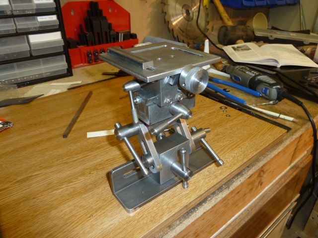

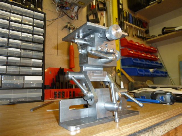

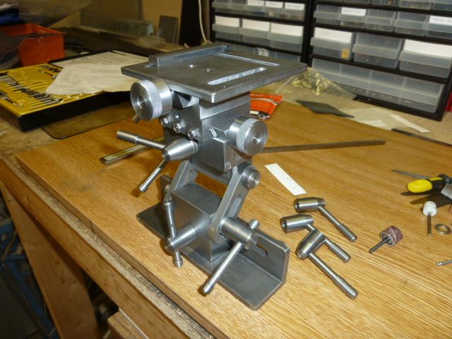

      And my wife thought that I was wasting my time in the garage for the last six weekssmileyp1040932.jpgp1040933.jpgp1040934.jpg

                  please tell me that Dremel sanding drum is not what this is going to be used for…..

                    My wife did say that it would look nice on the mantle piece, and I have been coursed into making a rotary table for cake decorating.
                    I have to make all the attachments to go with the grinding rest, then the next project is the end mill grinding fixture as I have quite a collection of them that need done up.

                        Well done John, you have made a fine example of the rest, certainly better than mine! My excuse though is that I would have been in a hurry to get it off to the magazine for publication. This particularly as it was part of a series and I never sent a series off to the editor until it was fully complete. Seriously though, with all the time in the world I doubt if I would have produced such a pristine result as yourself. I do particularly like your modified locking handles.
                        I assume from the photographs that you still have to make the accessories, some of which are essential to get the best from the device. However, with them complete you may like to look at my web site for the pages on using it. Whilst there are others the following two will help you for starters, as they will for others who have made the rest or the simpler rest which I have had published.
                        Shaping and Sharpening High Speed Steel Boring Tools at- **LINK**
                        Tool and Cutter Sharpening at- **LINK**
                        Perhaps these pages will also encourage others to make either of my two rests, both working in much the same way and using the same accessories.

                          Thanks Harold, I found your pages on modifications to the rest after I had almost completed it. Your quick change tool post and holders also made the job easier.
