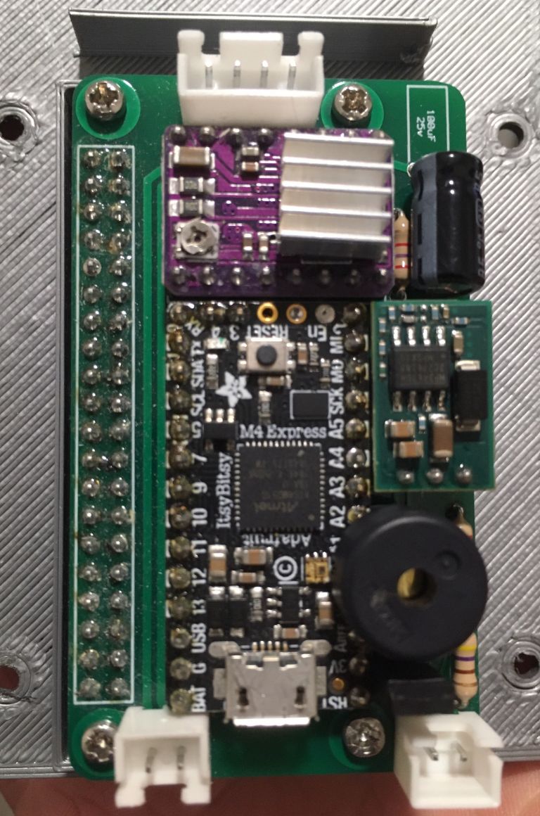

          Nice project but isn't a Raspberry Pi somewhat overkill? An Arduino Nano would eat the dividing task
          Dons tin hate etc.

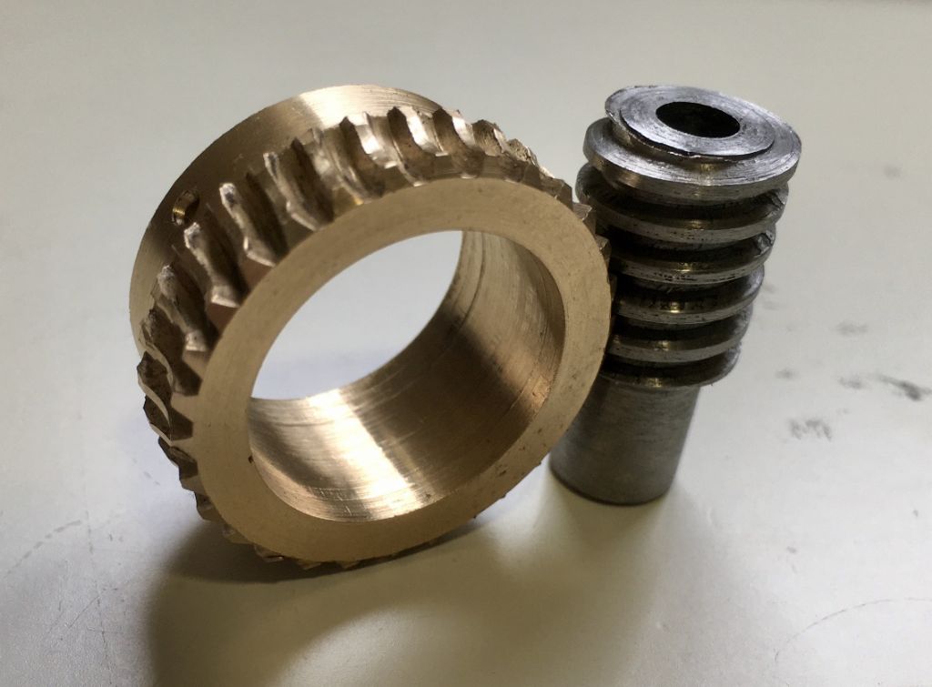

                Brian is right, a Raspberry Pi is overkill, so since submitting the article to the magazine I've changed the brain to an ATSAMD device which is smaller and starts up much more quickly. Also it gave me the opportunity to modify the software quite a bit. I've also changed the worm gear to a heavier 30 tooth setup, which with a 400 step motor gives the same accuracy as before. I'm currently working on a mount to enable it to drive the tail stock directly.
                #487886
                Adrian Rawson
                  @adrianrawson27430
                  I meant to say drive the head stock directly – sorry. Anyway here are photos of the current worm drive and electronics.

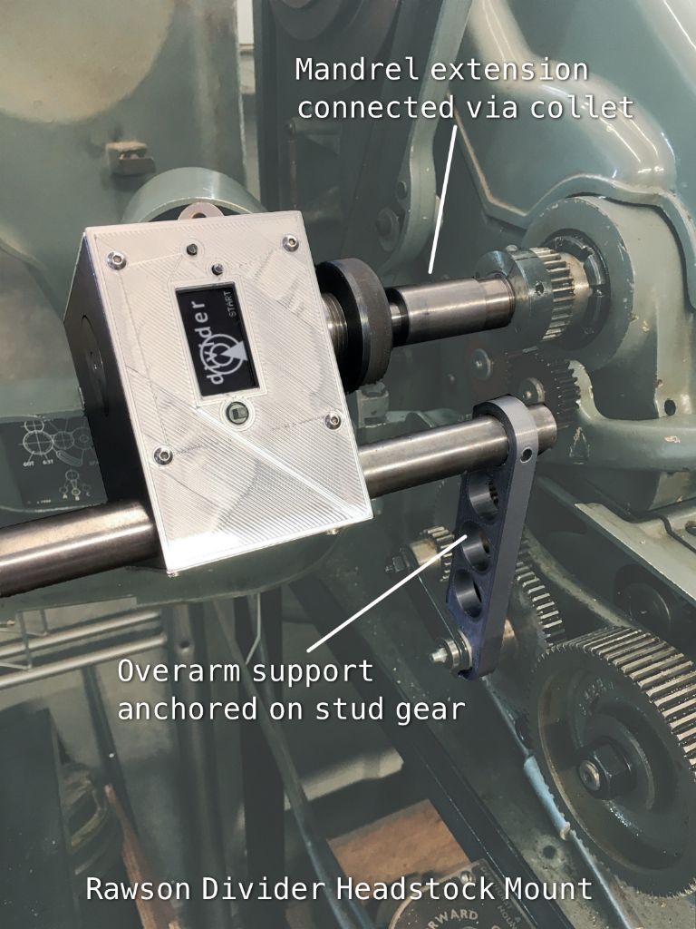

                    Tried and tested a headstock mount for the divider. Used a 2MT collet connected to a mandrel extension. Then fixed a printed plastic bracket between overarm and stud gear to hold divider in place. Shown under test here **LINK**
