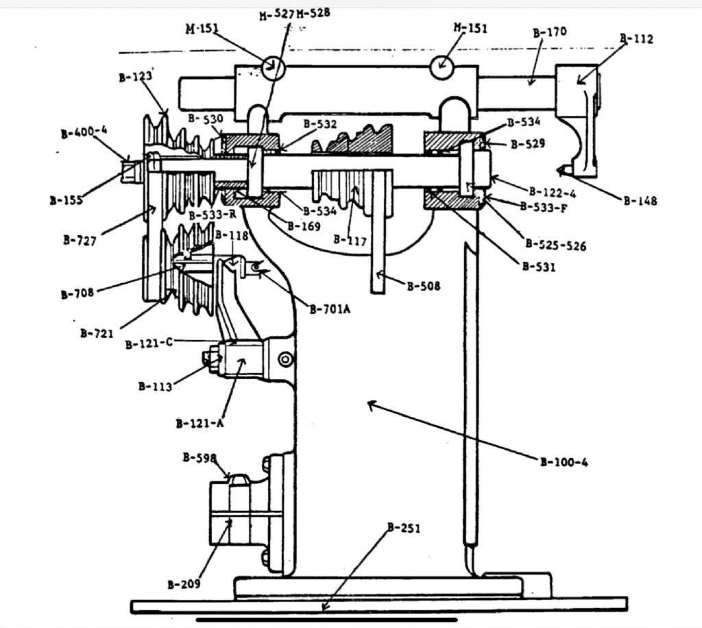

              #578236
              Anonymous
                I'm puzzled as to why the feedrate varies with spindle speed, it's not logical. My mill has a separate 1hp feed motor and gearbox, but on a mill with a single motor for both functions I would expect the feed drive to come directly off the motor shaft, not the arbor. Sounds like a fudge by a previous owner.
                I'd be wary about using a VFD. Of course it is useful in order to run a 3-phase motor, but in this application I'm not convinced that the variable speed ability is useful. As the motor speed varies so will the feedrate, and as the motor speed is reduced below base speed (normally at 50Hz) the available power will also decrease. in proportion.
                Andrew
                #578243
                Steve355
                  @steve355
                  Posted by Andrew Johnston on 03/01/2022 13:42:14:
                  Andrew
                  Doesn’t make a great deal of sense to me either but it’s the original setup. See below drawing. Also I found a list of original motor options … which I don’t fully understand.
                  #578244
                  Clive Foster
                    @clivefoster55965
                    Thats a reasonably spacious drive system.
                    If you go for poly-vee drive there is ample room to add an intermediate countershaft and make it a two stage reduction drive. With two stages you'd not have to have everything in a straight line which further eases the pully size issue. Perhaps 25 mm to 70 mm and 35 mm to 100 mm for the two stages getting close to the 5.61 reduction you have calculated. Eyeball engineering says larger drive pulley on the second stage as there will be more torque involved but realistically poly-vee belts can handle much more power than I think they ought.
                    3 rib PJ belts are similar price to A section Vee and, with only three ribs, easy to make pulleys for.
                    Last time I did a similar job I used the main bearings and support castings salvaged from a dead spin drier. Two U bolt exhaust pipe clamps later we were in business.
                    Potentially easier way, if there is nothing suitable for a countershaft in the useful bits box, id to fix the two countershaft pulleys together add bearing(s) and spin on a stationary shaft. Cheap ball races or oilite bushes have both worked for me.
                    Effective though VFD systems are I always think you are best off getting the basic drive ratios right to mainatin lower speed torque then add in the VFD to maximise flexibility.
                    Clive
                    Edited By Clive Foster on 03/01/2022 14:17:31

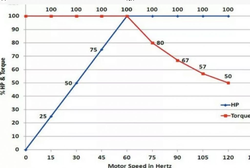

                              #581912
                              Steve355
                                @steve355
                                Back to this project again after a few weeks away from it….
                                Basically the motor that came with this mill is too fast at 1480 rpm. The original motor that would have been supplied was geared and would have had a much lower rpm (capable of running the mill at 66-2850 rpm). The lowest I can get is 250. I need half that to get into the right territory.
                                I could add an extra countershaft and pulley, but the bits wouldn’t necessarily be cheap and it would be another project in the way of the mill working properly.
                                More expensive but easier and more flexible is a motor/VFD package. There’s a chap on eBay selling a VFD, motor, controller box and wiring as a package. Not cheap but it would move me forwards.
                                The thing is I don’t understand the hp rating of these setups at low rpm. They have linearly lower hp, but high torque – see diagram. My question is, does this matter? Or is it torque I need rather than hp?
                                I have seen lots of geared motors for sale but they all have very low hp. Again, does this matter? Or are they high torque?
                                thanks
                                Steve
                                #581915
                                Anonymous
                                  The graph shows what one would expect for a motor driven by a VFD with base speed at 60Hz. Below 60Hz the torque is constant, and power decreases linearly, Above base speed power is constant, and torque decreases in proportion to the increase in speed.
                                  Metal removal rate is determined by available power, not by torque. Looking at the graph if the motor is running at 30Hz then power is down by 50% and you will only be able to remove 50% of the metal per unit time. A belt, or geared, drive system is constant power, which is what you need. As the speed decreases the torque increases to keep power constant.
                                  Reducing speed by using a VFD, without changing the belts, is simply going to cripple the mill in terms of metal removal rates.
                                  Andrew

                                    #581928
                                      Posted by Steve355 on 23/01/2022 13:15:45:
                                      More expensive but easier and more flexible is a motor/VFD package. …
                                      thanks
                                      Steve
                                      First, you might try fitting a 6-pole 750rpm motor. This example from Bearing Boys is 0.75kW, other powers available.
                                      Second, control it with a VFD. The 6-pole/750rpm motor is better placed to deliver lower RPM whilst maintaining power output than a 1500rpm motor.
                                      Torque and Power make my head hurt, but I'll have a go at explaining it/
                                      • Power is the rate at which work can be done, note time and a unit of work are both involved. An example might help to put the two in perspective. 1HP (746W) allows approximately 1 cubic inch of steel to be removed in one minute. Therefore a ½HP motor will take twice as long (2 minutes) to remove a cubic inch of steel, and a 2HP motor will remove one in 30 seconds. As about 1 cubic inch per minute is a rate of work that suits most ordinary workshops, 'our' machines typically come with motors in the ¼HP to 2HP range. I guess Model Engineering tools average about 1HP, which is always a good guestimate – not too weedy and not over the top bonkers.
                                      • Torque is twisting force, measured in Newton Metres. Imagine a stopped motor at the moment it's switched on. As RPM is zero, the motor cannot be doing any work – it's power output is also zero. Torque is the force that accelerates the motor up to speed. When the motor is delivering power, applying a braking force greater than the Torque will stall the motor.
                                      The amount of Torque produced depends much on the design of the motor. Single-phase motors and petrol engines both suffer low torque at low RPM, and need to be up to speed before the load is applied. Three-phase motors have much higher starting torque, and stepper motors deliver maximum torque when stopped. All motors lose torque when over sped.
                                      Even though it's vital I tend not to worry about torque much. Machine tools aren't heavily loaded from the get go. Therefore, provided the motor is of reasonable power, it should have enough torque to start and accelerate up to operating speed. If the operator stalls a machine running at design speed, he's working it too hard. Bad driver: back off. Unfortunately, overheating, mangled brushes, sheared gears and other damage are likely before a stall finally issues a Red Card.
                                      The graph means the motor delivers best power and torque at 60Hz. No surprise in a motor designed to run at US mains frequency. The motor maintains Torque as the VFD frequency and hence RPM drop – it won't stall. But the rate at which the motor can do work does fall with frequency. It's power output is halved at 30Hz, so it would take twice as long to finish the same work done at 60Hz. The graph also shows that speeding the motor up maintains the power output (it doesn't increase), but the torque falls. It's twice as easy to stall the motor at 120Hz than at 60Hz. (A VFD is likely to reduce this effect electronically.)
                                      Loss of torque and power might make the VFD sound a dicey proposition, but speed control is a major advantage that usually outweighs the disadvantages. For example, surface speed is arguably more important when cutting metal than power or torque. Certainly true of my lathe which I measured with a Wattmeter: even though the motor is good for 1.5kW out, I never use anything like that during normal work. Usually power input is between 200W and 1000W, with most cuts taking about 800W. The VFD, helped by a simple two speed belt runs the spindle at the RPM I want without any practical effect on power or torque.
                                      When speed is changed with a gearbox or belt drive the ratio effects speed and torque inversely. The relationship is simple: decreasing speed increases torque, whilst increasing speed decreases torque, both pro-rata.
                                      #581938
                                      Anonymous
                                        Posted by Steve355 on 23/01/2022 14:04:27:
                                        ….people seemingly happily using VFDs with lathes….
                                        VFDs are a convenient way of using an existing 3-phase motor, and make changing speed simple. They also have other useful features such as soft start and current limiting. But consider the following:
                                        1. Some people don't understand how VFDs work, and the tradeoffs involved
                                        2. Some modellers don't run their machines to the limit, so a VFD is often fine
                                        3. Some people don't know the following equation: Power (W) = torque (Nm) x angular velocity (rad/sec)
                                        Andrew
