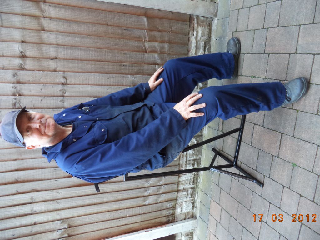

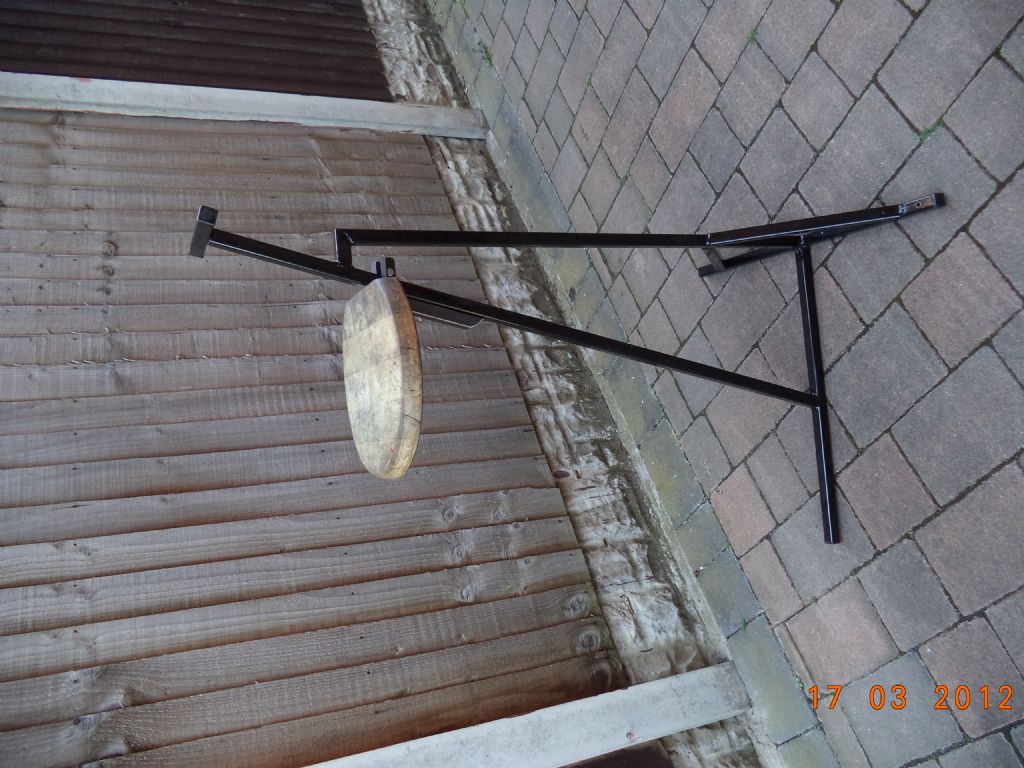

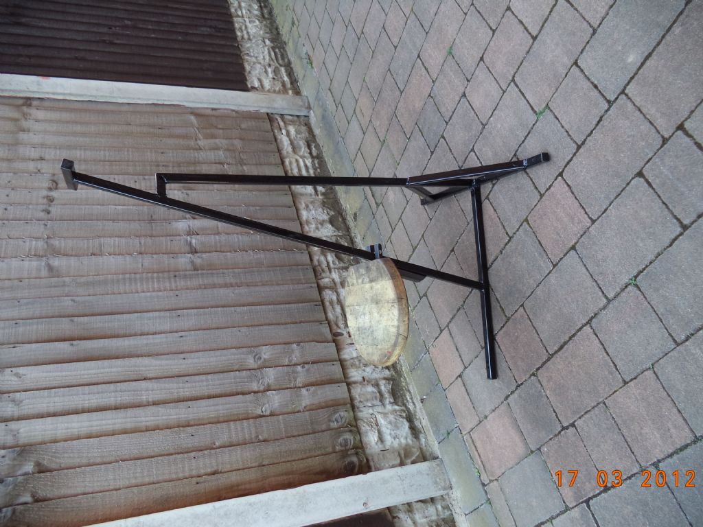

      If I have to stand at the bench for any length of time my back start to ache I have an old kitchen stool but its height is far from ideal particularly if a move it around bench to lathe or mill or loco assembly table. Then I saw this design on one of the other forums I frequent, the seat has a clever self clamping device to adjust all you do is take your weight off it and move it to the height you want the sitters own weight provides the clamping force.
      Before we have any wise cracks about the side ways photos I did turn the the correct way round but this hosting just won't load then the correct way round any suggestion why this is.

                  Looks very useful Stew, is that a lavatory seat you have on it? I manage with an assortment of 3 stools but not having the kit or expertise to weld I shall have to continue doing so.

                        Am I correct in thinking it uses a wedge lock.

                              Due to having been born stupid and spending 61 years improving on the original condition, I've lost the link to the (US, I think) model engineering or welding or similar forum that I got it from, but a chap posted about the same design of chair last year and also included links to some plans that he had made. While I've lost the original link, I still have the plans that I downloaded, and the 12 metres of aluminium 1" square and angle section that I bought to make one of the chairs for SWMBO in her pottery workshop and me for a welding and lathe chair in my shed.
                              If anyone wants to see or download my copy of the plans, they're here:-
                              Assembly diagram.
                              Parts diagram.
                              The material is all 1/8" thickness aluminium square tube or angle apart from the seat, which is whatever wood or bog-seat you come up with.

                                No Jim its not the old throne its off an kitchen stool I was using in the workshop, the drawing calls for a 10" diameter seat the kitchen stool was 12" so I just cut one edge of it off to make it 10".
                                Waste not won't not

                                  I got my plans from the same place, but I made mine from 20mm box section steel. I wanted a project to practice my welding on, my biggest mistake was with my first weld it took me by suprise and I burnt through the box section the other were ok and they got neater the more I did.
