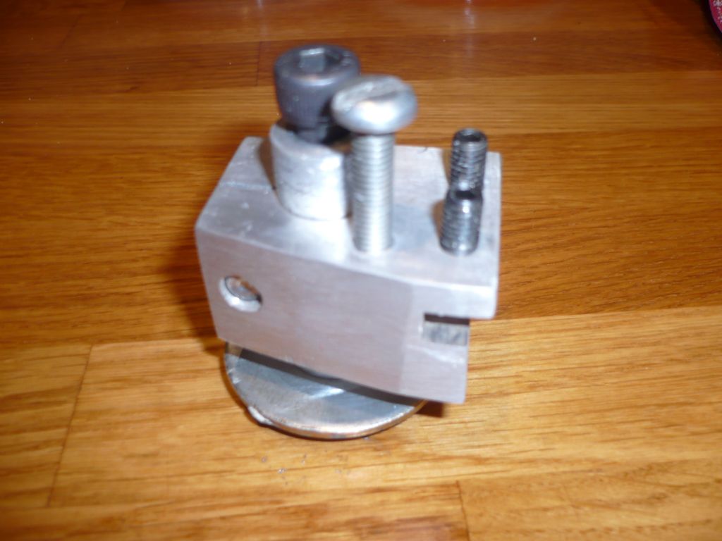

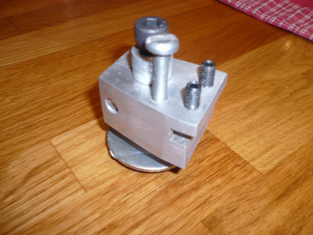

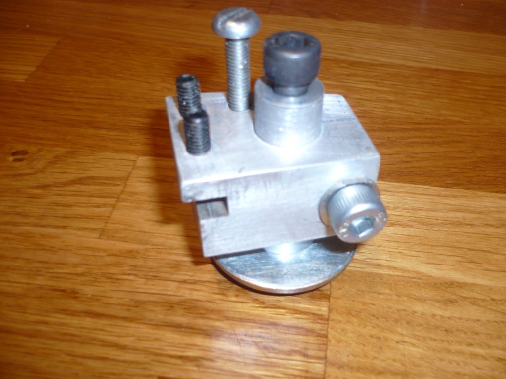

      Having become increasingly frustrated trying to set tool heights with shims, I thought that I would have a go at making an adjustable height toolpost. I completed this using the Flexispeed for all milling and turning. It is a little rough around the edges,needing an Allen bolt to replace the long screw.
      I am pleased with it. It works and it is the first thing that I have made on the lathe, other than the odd bush or sleeve.
      James.

          Nice piece. I'm part way through making one of those too. I went and made two tool holders to go onto the shaft, that way I can use it a la Aloris tool holder and have two different tools always ready at the right height. Then I broke a tap in one and got it proper stuck so now only one is nearing completion.
          What sort of sizes did you use? If its for the smaller lathe I can see in your album we probably have about the same sizes to work with.

            The sizes are: 1" thick by 1 1/2" wide by 1 3/4" long. The post is 5/8" diameter. I think that the grub screws and height screw are 5mm. It takes a 1/4" tool.
            What lathe are you making yours to fit?

                  The lathe I am making them for is a Wizard Lathe. 6" between centres that are 1.75" high.
                  The original tool holder is the one I hear some people call a elephants foot. Worse than those 4 way toolposts because it doesn't even allow the tool to be swiveled around without lots of poking stuff about and it is generally a bother.
                  The overall size of mine is similar to yours. Mine has a 13mm tool capacity though with a 12mm post.
