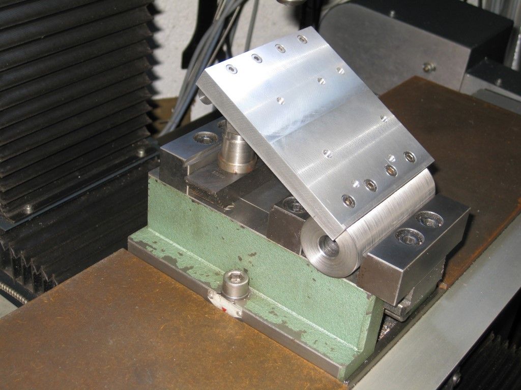

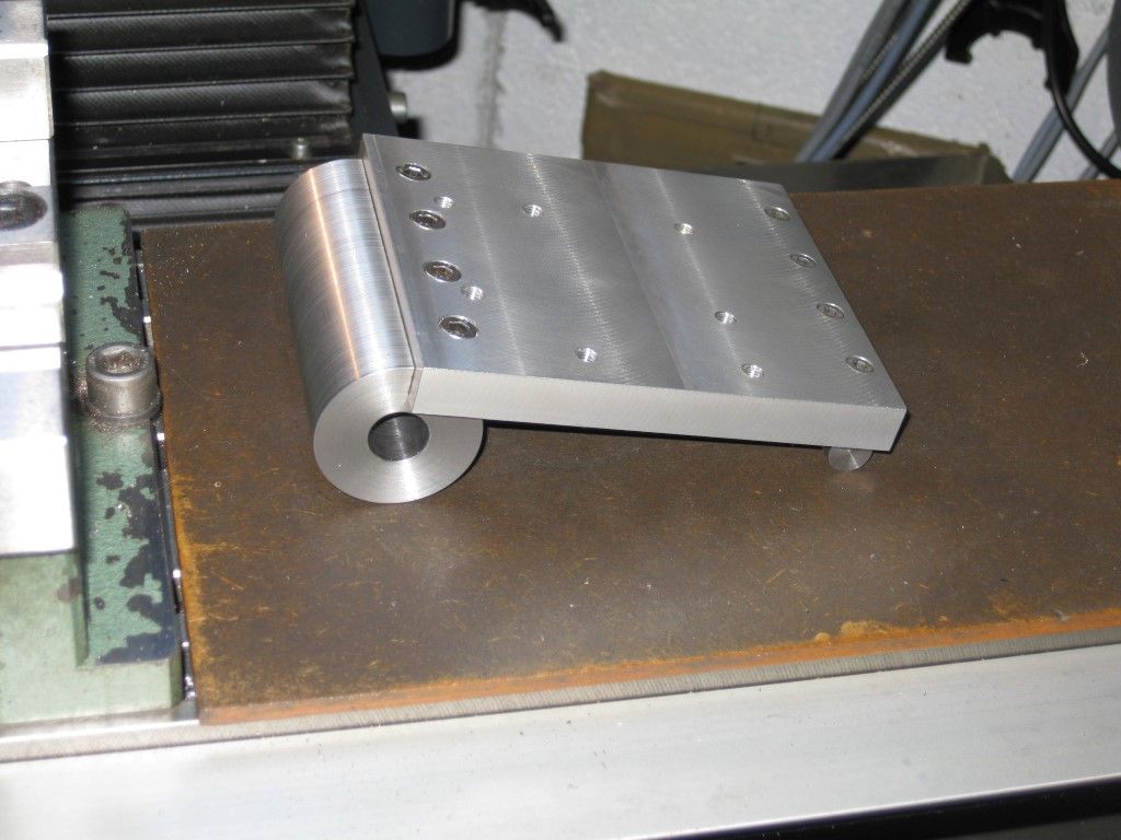

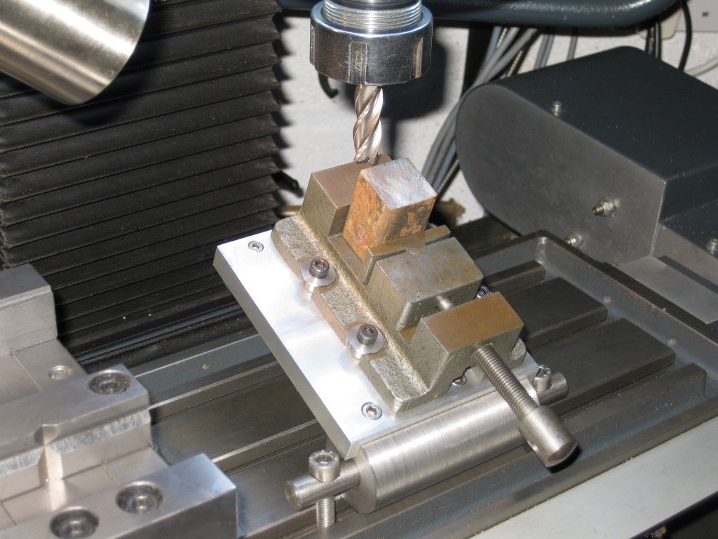

                          #351830
                          steamdave
                            @steamdave
                            I made a simple tilting plate that can be held in the vice or located in the tee slots of the mill table. I don't use a tilting table very often and this seems to fit my requirements.
                            The Myford vice gives an idea of size
                            I use a machinist's jack and an electronic angle gauge to set the angle. Close enough for the girls we go out with.
