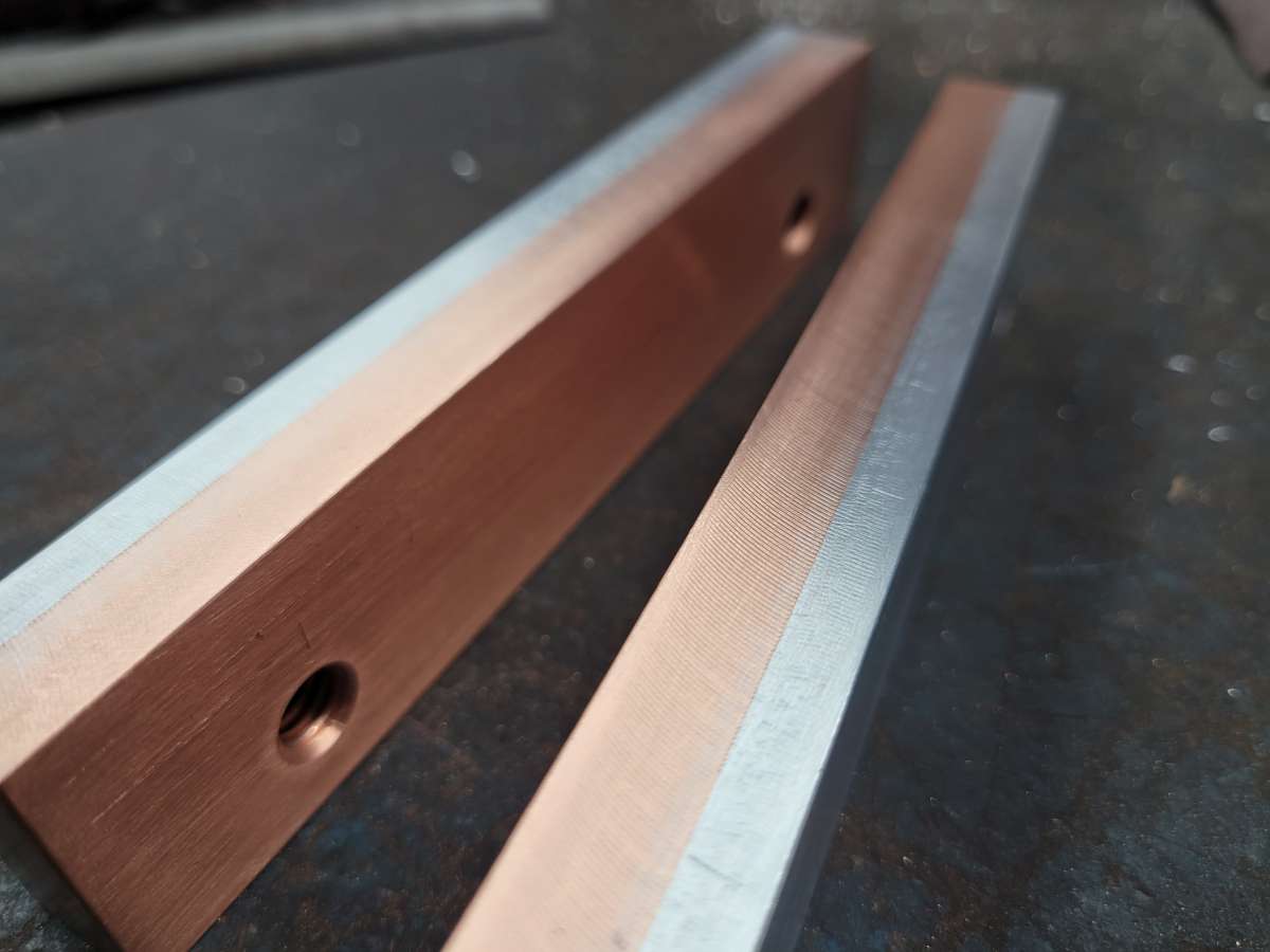

      I need to sandwich 2 pieces of 150mm x 40mm x 10mm material together, one is copper, the other aluminium. I would like a tight join so intend to machine both surfaces flat. Once together they will be machined together as one part and remain together as one component. I have JB weld and super glue, will either of these achieve what I need or do I need something else?

                                  Thanks for the replies. The parts are far from exotic, they are vice soft jaws so I suppose the only consideration would be the subsequent clamping. The aluminium only really being used as a spacer as I need a greater thickness of material than the 10mm copper I have in plentiful supply. I could use steel, or I even considered brass and a soldered joint but this seemed wasteful as the brass is not in such a plentiful supply.
                                  They don’t even really “need” to be joined together as they will ultimately be screwed to a vice but I just thought it would make for a nicer finished product.
                                  The only reason I stipulated a tight joint was for aesthetic reasons, especially if using a darker adhesive like JB weld. If JB weld were used would clamping the parts together result in all the adhesive squeezing out?

                                            20241007_201051
                                            I grit blasted the surfaces to be mated and tried JB Weld, smearing on both faces and clamped together. The join is plenty tight enough and the aluminium was decked down to thickness by just holding the copper and the bond held without issue. So for my needs, this appears to have been a success

                                              Looks good
