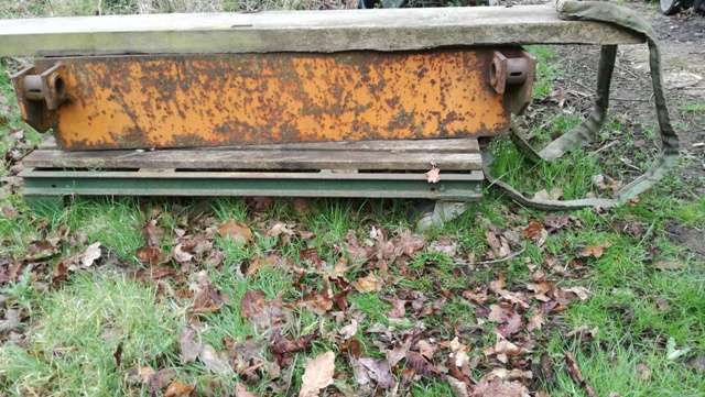

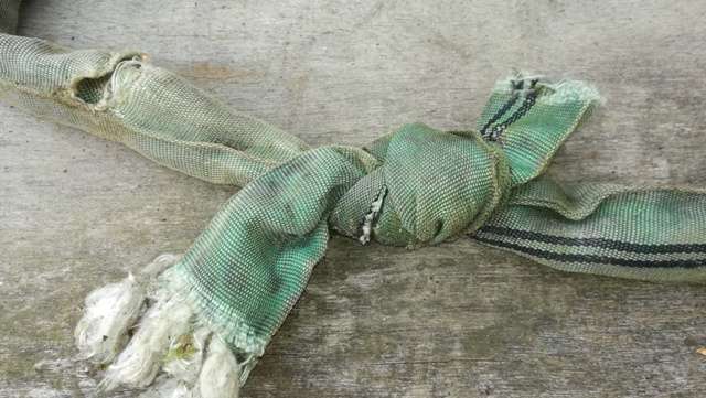

                            On Nigel Graham 2 Said:
                            Oh – and use them correctly, which includes not tying knots in them.
                            Hi Nigel Graham 2, What !!!
                            IMG_20250325_082655 b
                            Good job I only use this one for pulling my low flat four wheel barrow then.
                            IMG_20250325_082813 b
                            But yes use them correctly, and if they are on corners, use some soft packing to prevent damage to them, like what can be seen at the top left, in the first picture.
                            Regards Nick.

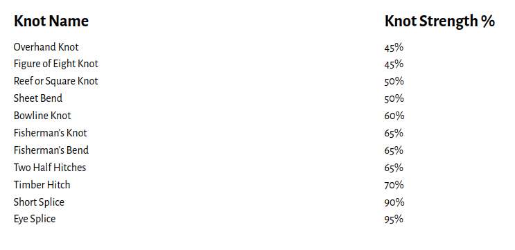

                              Nigel is right about knots:  they all reduce the strength of the rope, some of them dramatically!   Splices are best.
                              Screenshot from 2025-03-25 09-33-17
                              Greensand’s strap is rated at 205kg and joining the ends with a reef knot reduces that to about 100kg.   Start worrying because a reef knot is more secure than glue.
                              Adhesives are only effective when used appropriately, and that doesn’t include joining the ends of load bearing straps!  MichaelG pointed out adhesives have low peel strength, so any situation that applies sideways force or puts a stress raiser on an edge will quickly destroy a glued joint.
                              Stitching, riveting, and splicing are all much safer if you must.   I’d take Nigel’s advice about buying the right thing though – DIY is unnecessarily risky.

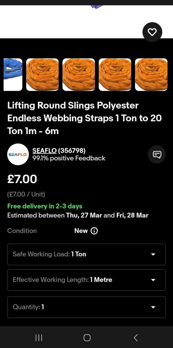

                                    As pointed out,  you can buy lifting straps so cheap it’s not even worth buying adhesive or the petrol to go looking in shop, £7 gets you a 1 ton rated strap delivered to your door.
                                    Screenshot_20250325_134122_eBay
