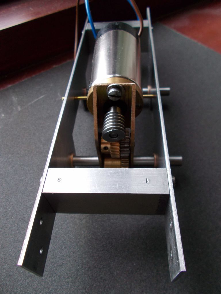

                  The frame spacers on this small Gauge 3 chassis were cleaned up on the shaper to remove rust pitting. It didn't take that long and was done inside in the warm (so it actually got done that evening which it might not have been the case otherwise!).
