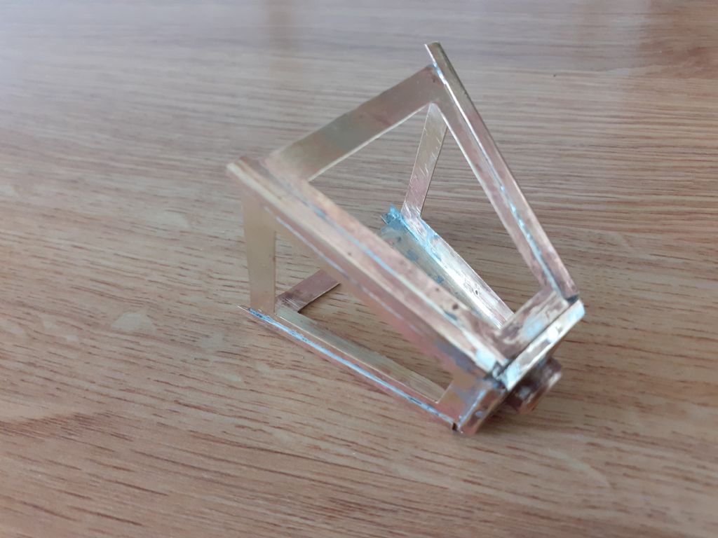

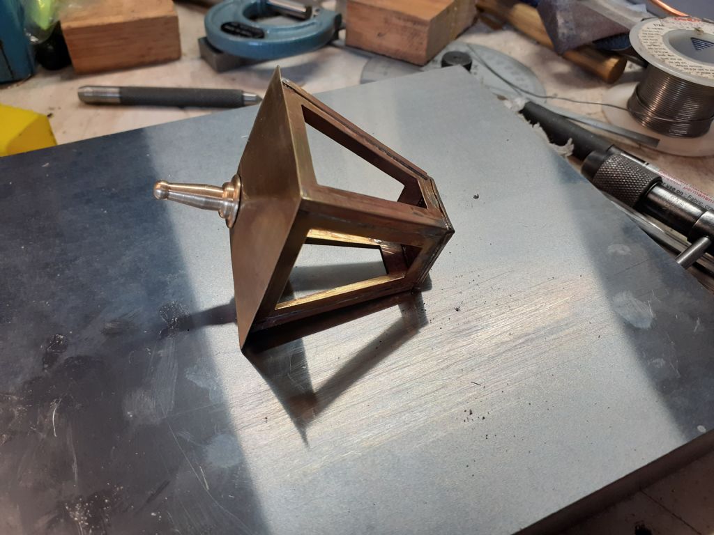

        I have decided to add a lamp post and generator to my wobbler engine I finnished a while ago. Here is the lamp for the top of the post.
        Next to make the post and base.
        David

          That's a very nice looking fabrication david. Well done.
          jim

            Getting on a bit with lamp post.

              A good job on your lamp, interested in how you made the lamp cover David.
              Bob

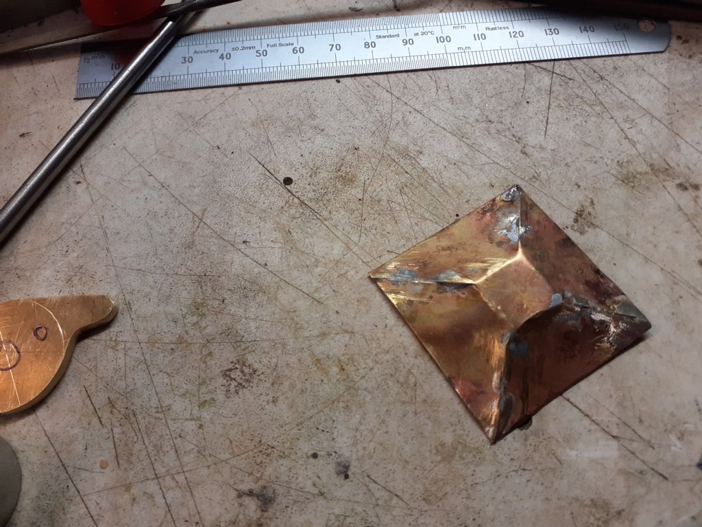

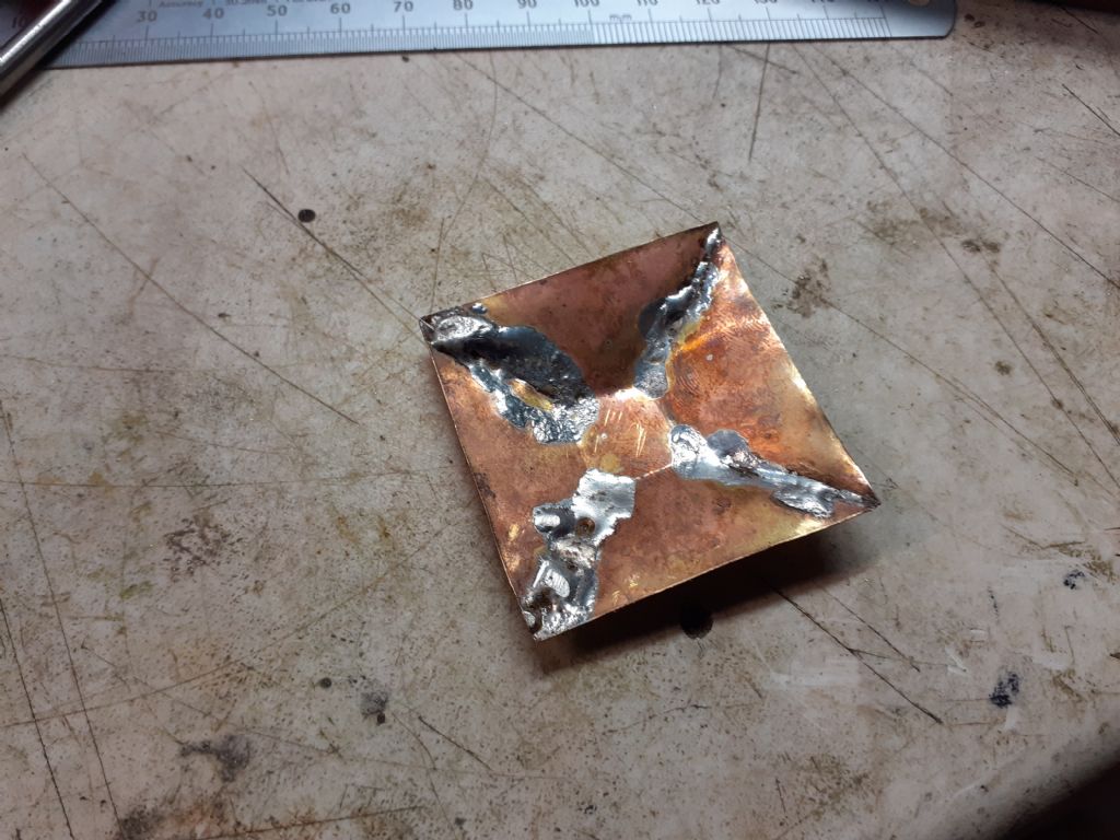

                had a go at cutting out the shape and silver soldering the join but it started to melt although I used a low temp jewlers solder. I had a go at lead soldering it but it was a pigs ear. 20200727_102220.jpg

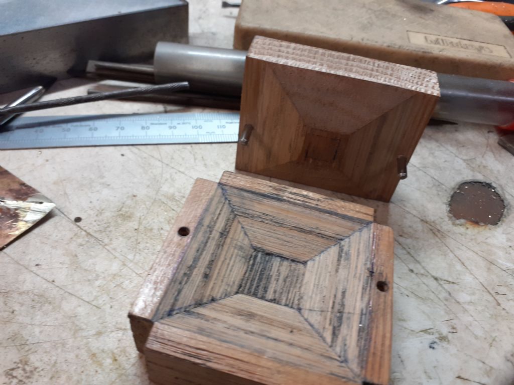

                I then made a wooden press tool from a piece of oak on the mill with a couple of pinns to locate the two halves. I anealed a piece of brass and pressed it in the vice with a small amount of getting it worked well.
                David

                  A lot of work involved getting the shape with no joints, well done Dave.
                  Bob

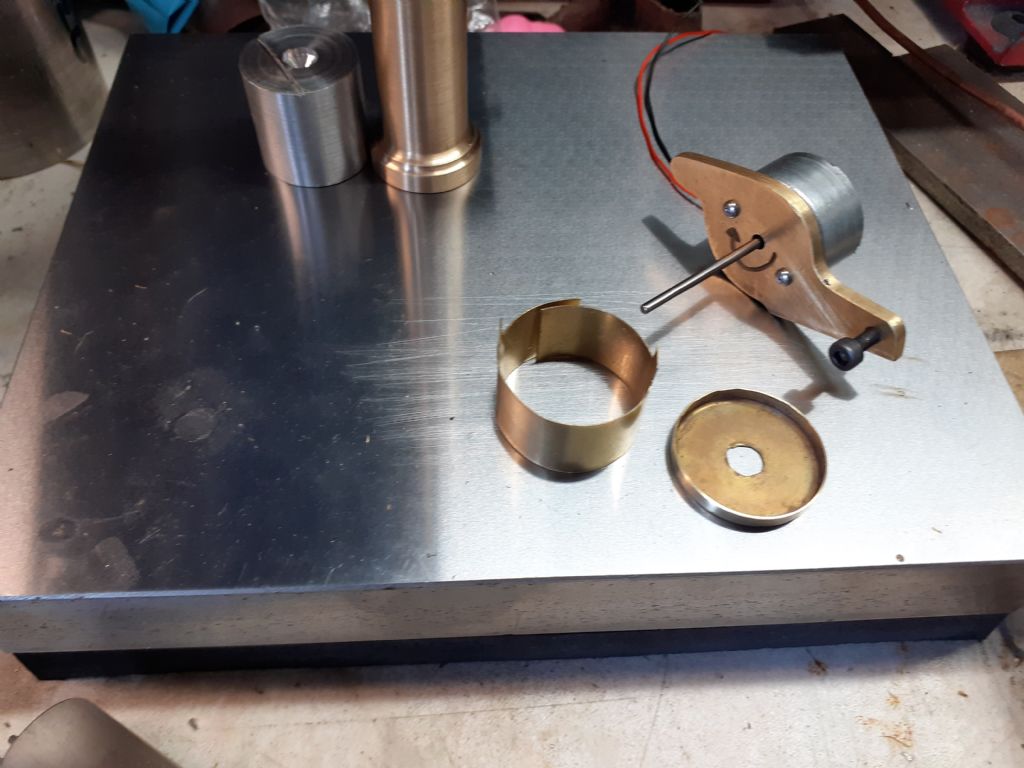

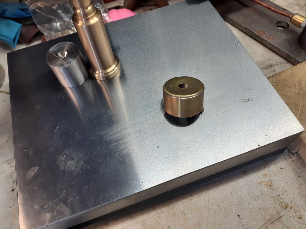

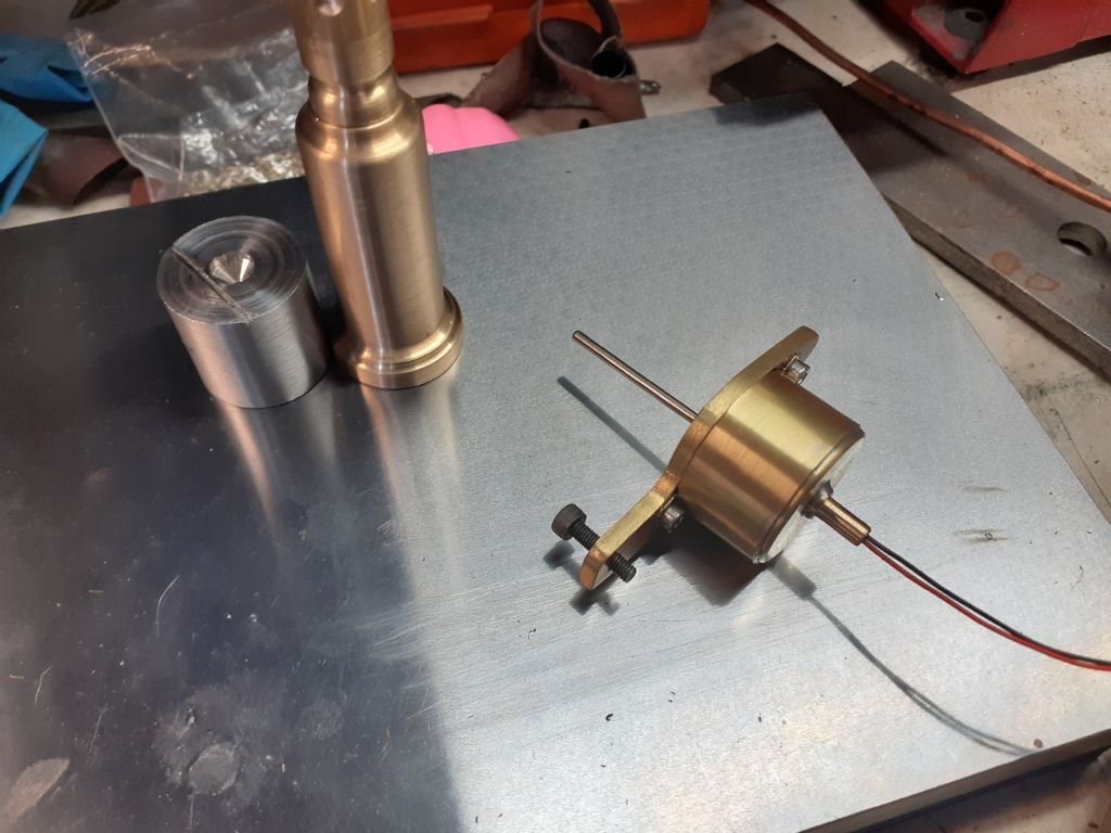

                    Just a bit nearer. Made part of generator to power the lamp post. Cut a plate to mount the motor on. Made a strip and end cap and soldered together. The cap was anealed and spun on the lathe to make the shape on a former.
                    The retaining lugs were bent and drilled and a ferrule made and soldered for exit for wiring to lamp.
                    David

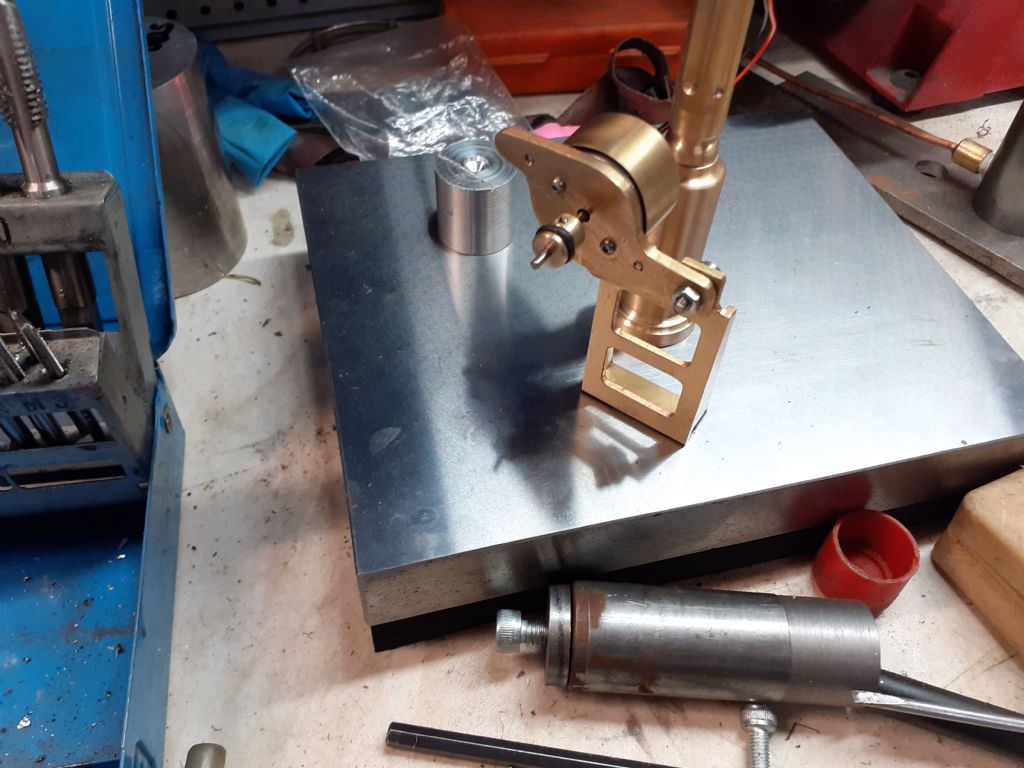

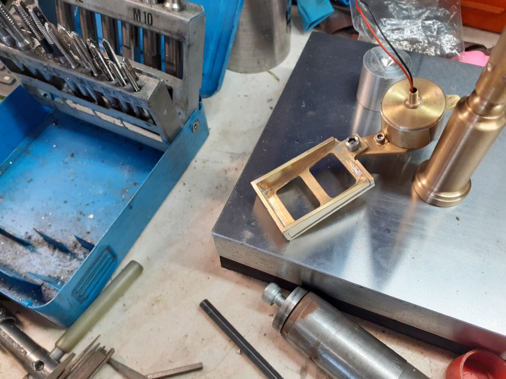

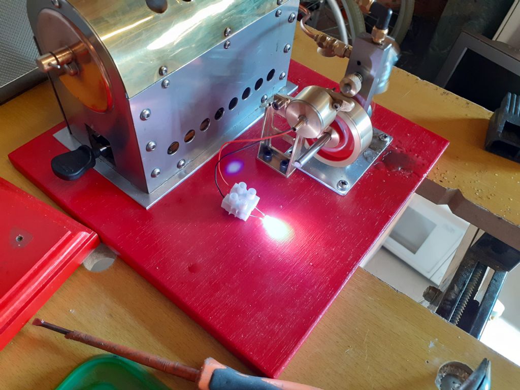

                        I have made the bracket to support the motor/generator and decided to check out if it works ok.
                        I powered up the wobbler and no problem.
                        The output is 3.2 volts and so time to Finnish the lamp etc.
                        David

                            I also really like the wooden former. Good job.

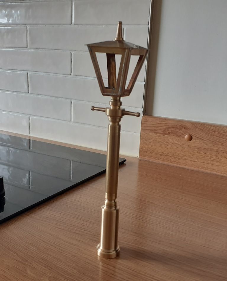

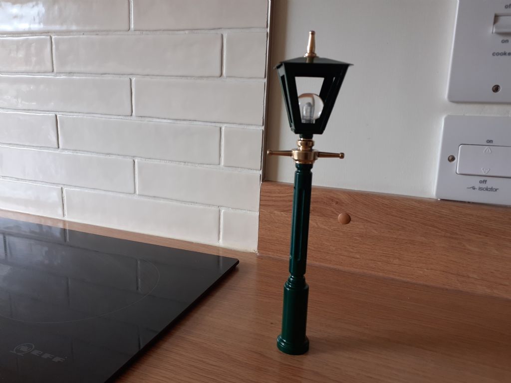

                              Finnished the lamp post. Painted polished and made the globe for the LED just needs wire soldering on and insulating.
                              David

                                  Hi John I bought them from RS
                                  3.2 V White LED 5mm Through Hole, Nichia NSPW515DS
                                  I had to turn the flange off the base of the LED body so they would go through the tapped 6mm hole.

                                    That's it finnished at last.
                                    I have had the first run since completing it. Hope you like it.
