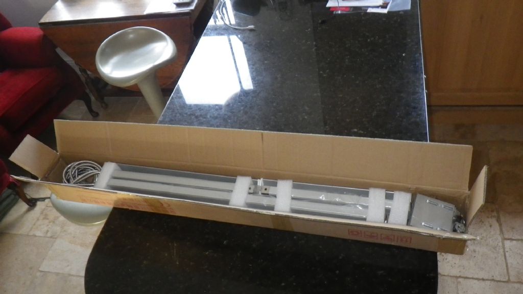

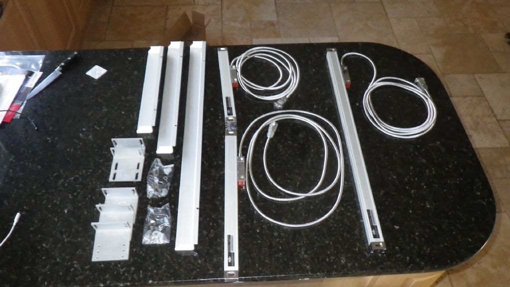

                                  #326423
                                  richard markham
                                    @richardmarkham58340
                                    Scales arrived first! All ok, despite rather unsubstantial box…
                                    Came with brackets, various fixings and aluminium covers. Leads are approx 3m long.
                                    Nothing is rattling/scratched/bent.
                                    Just waiting to get display now – which is coming via a different route for some reason.
