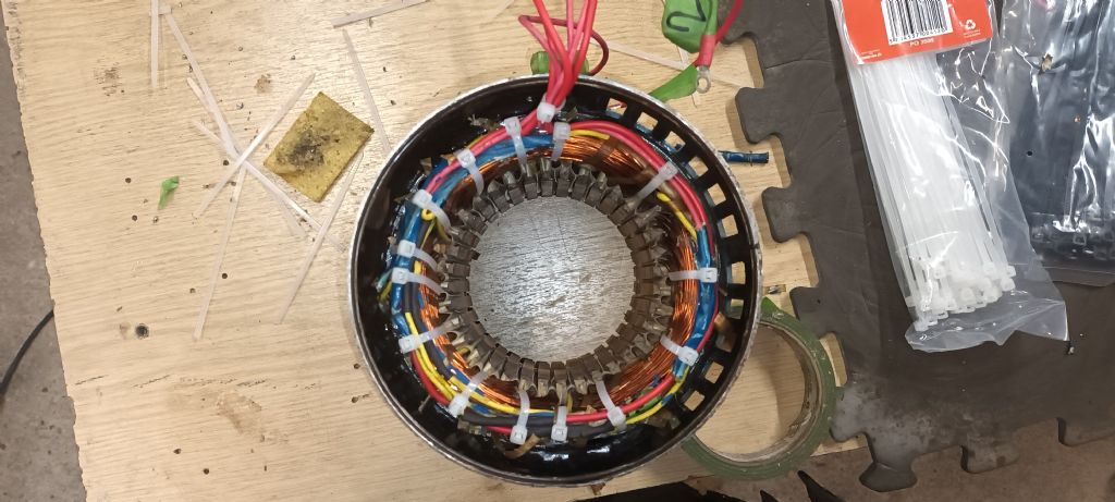

      Mike and Clive thanks. Given the actual use mine will be getting I feel OK about securing with zip ties

        What is the temperature rating of a zip tie? Methinks theyy will get very soft at normal motor operating temperatures.

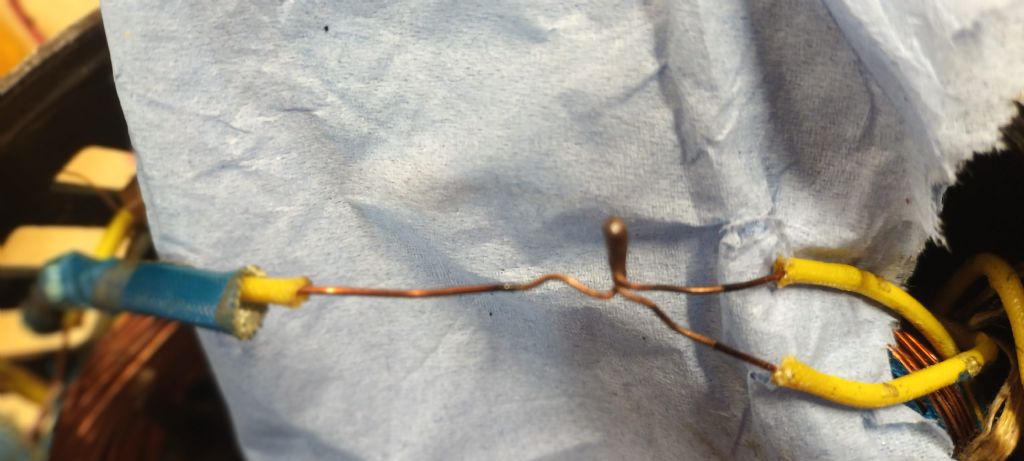

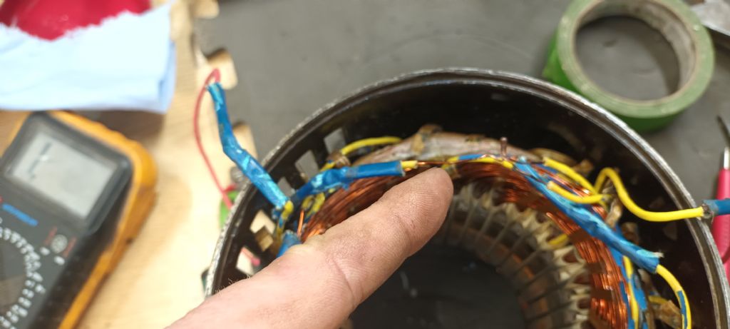

          Check out what I found!!

              The shellac we used sounds vey like the stuff you have Clive, we baked all our motors to harden the shellac and after baking it had set quite hard. I am not sure what the bake temperature was. I am not so sure as Clive that the connection of the coils doesn’t matter but if if doesn’t run sweetly then swap each winding in turn until it runs best. Motors can run at quite a high temperature without stress, in fact we have had to strip and bake motors that have been flooded to dry them out. Modern motors can run happily at temperatures that would be very uncomfortable to put your hand on for any time but to reach those temperatures they need to run at full load for extended periods. It looks like the star point extraction has gone well so good luck with the final assembly and testing.

                Standard cable ties (non heat resistant) made from 66 nylon are suitable for use up to 85 degrees C. I would remove those ties and use string sprayed with conformal coating, or use heat resistant ties instead. You won't know what is happening inside the motor until it fails.

                  It is important that the sense of each winding is correct, it doesn't just reverse the motor if you reverse one winding, the motor torque will suffer and it won't run so smoothly. This is because there is mutual coupling between the windings of a 3 phase motor and if the couplings are not all in the same sense the phase currents are unbalanced.
                  But it should be easy, if you connect the inner end of one winding to the outer of the next. Or putting it another way, the end that went to the star point of one goes to the not star point end of the next.
                  #582886
                  noel shelley
                    @noelshelley55608
                    As John has said, Now you have star point it SHOULD be easy ! If you take the 3 original wires as 3 starts, Test continuity, to the 3 tails at star point and take these as 3 finishes, then, start No1 to finish of No3 coil, finish of No 1 to start No2,finish of No2 to start of No3 ! You now have a 240v 3phase delta wired motor. IF it rotates in the wrong direction simply swap any 2 incoming phases. It is very important to re coat the work to prevent windings moving, breaking the insulation and causing shorted windings. Good luck, Noel.

                            So Colin, as has already been said by others, the wires joined to form the "star" point can be regarded as starts.

                              All done and running smoothly. Once I got the star point it was pretty straight forward to make sense of the polarity. I just labelled everything up (u1, u2 etc) and followed the classic delta diagram from the net.
