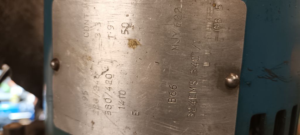

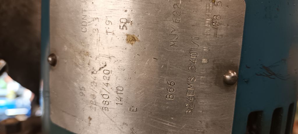

      I'm just getting to know my bridgeport mill. The main motor is a bit unusual in has much it only gas 3 wires in the connector box. I have done a bit of research and it looks like this was standard for these English bridgeports. My motor plate is very faded but looks like it's badged as both 230/240v and 380/420V. Does this make it a 2 speed motor? Will it run on a single phase to 230V 3 phase inverter?

              Posted by colin hamilton on 16/01/2022 18:52:44:
              Dual voltage, not 2 speed. It needs 415V in star and 230V in delta. Should be a box on the motor with internal links to change between star and delta.

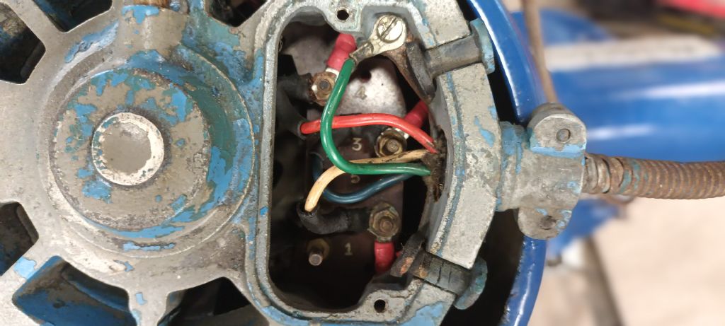

                Im familiar with star and delta but this is different. It only has three wires and an earth in the connection box. It's a 3 phase motor

                          That is a remarkably crude data-plate.
                          Normally motors capable of being configured in both Star and Delta have 6 terminals in the junction box witha set of links to get the coils in the appropriate order.
                          In the UK permanently wired motors on things like machine tools, especilly older ones, are commonly wired Star for 420 volts so changing needs digging into the internal wiring. Usually the data plate simply states 420 volts but I have encountered a couple that had details for 230 volt Delta connections on the data the plate as well with a simple punch or similar mark to identify which way the internal connections were set.
                          The first time I encountered such a motor I was unamused to find hard soldered connections after opening it up instead of the expected set of screw terminals to facilitate re-configration hidden under the junction box. It took a fairly forensic examination of the, somewhat aged, data plate to discover the indicating puch mark.
                          If you are lucky the reconfiguration connections will be on the back side of the visible board. Not something I've seen but I'm told it has been done.

                            Colin,
                            Your motor rating plate looks as if it has been sanded down, has a previous owner repainted your Bridgeport? I have a single phase, non-Varispeed Adcock and Shipley Bridgeport. The motor rating plate is painted, with bare metal only in places where details have been stamped. In addition, the label on the electrical cabinet also identifies the Voltage, phase and maximum current..
                            The picture of the connections which you show is the connection to the top of the motor. If the motor is 3 phase and configurable, the connections are likely to be in the box on the front of the motor, where the cable from the electrical cabinet terminates. On my machine, this only houses the Forward, Off, Reverse switch, is this the case on your machine?

                              I'm pretty sure it's 3 phase. When I went to view the vendor had it plugged into a three phase supply. In the main junction box (on the mill) there are a number of breakers and a transformer, which I think is for the feed motor.
                              Gordon- yes my picture is ofvghevmotor connections. The additional box just contains the rotary swith for starting and reversing.
                              I've had a look online and I think I've got the same set up as this chap.

                                  Colin
                                  Although more modern motors have 6 terminals and usually brass jumper link some early motors had just 4 terminals. Each of the wires from the windings, there should be 6 in total, will be identified either by colour or some other form of marking. Note down what the connections are at the moment for use later.
                                  For 380/420V (Hi Volts star connection) three wire from the winding would be connected to one terminal to form the star point and each of the other ends of the 3 windings would be connect to a single terminal to which the three phase supply is connected. This is most likely the connection arrangement you have at the moment.
                                  For 220/240V (Lo Volts Delta connection) operation the three windings are connected effectively in a ring. So the end of one winding is connected to the start of the next winding.
                                  However how does one know what are the start and finish of each winding if the motor doesn't have a circuit diagram on the terminal box cover. The three wires connected to the common star point , if connected for Hi Volts, are likely to be the finish of each winding.
                                  So begin by isolating each wire from the star point and then use an ohm meter to find the match start of each winding and note the colour.

                                    Clive, thanks for this. If itvus currently set up in star configuration and I connect it to a 220v 3 phase supply would it still run (perhaps with reduced torque?)
                                    #580874
                                    Clive Steer
                                      @clivesteer55943
                                      Colin
                                      If the motor is wired for star and cannot be altered easily it will run on Lo Volts 3 phase but develop a quarter of the torque but probably sufficient for testing. The speed will be right whatever voltage the motor is feed with except for a more slip at the reduced torque.

                                              So I connected it up to the VFD I have for my lathe and it ran without any issues. I didn't have time to do any cutting so not sure about potential loss of torque yet.
                                              It looks like the motor will dismantle without much effort so I might go looking for those pesky delta windings at the weekend!!
