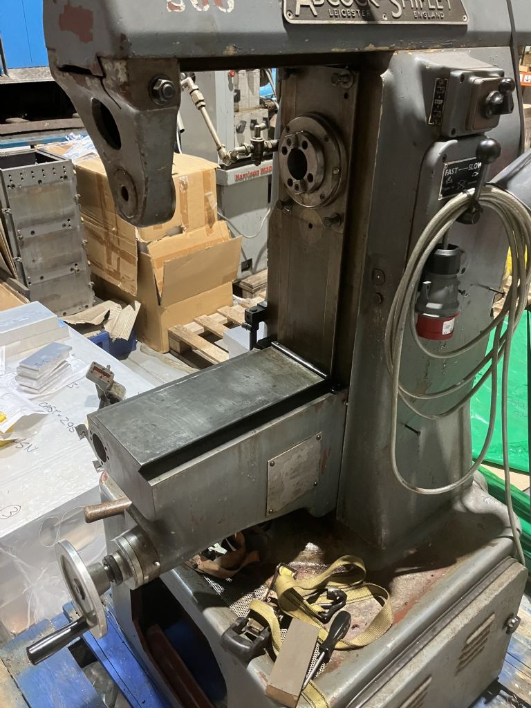

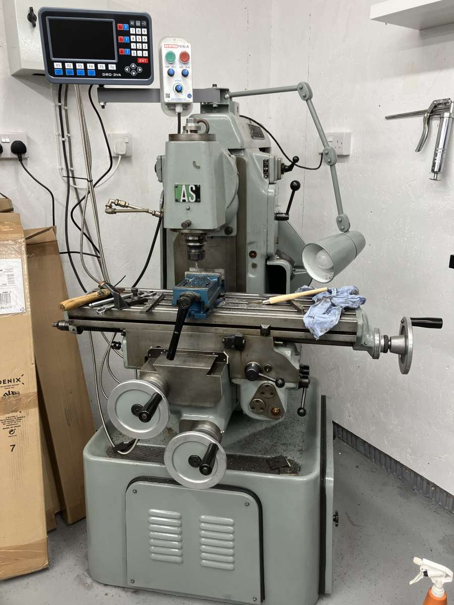

        Hi
        At some point in the near future I have to disassemble my 1ES into manageable chunks in order to get it down the side of the house and into garage.
        im thinking, table off, overarm off, motor out, then removing main column from base. Anyone have experience taking the 1ES apart. I’m sure I could work it out but any help/things to avoid doing would be greatly appreciated
        thanks
        jay

                Thanks. It’s not really the moving of it that’s the problem, it just won’t physically fit down my side entrance as it is.
                #659118
                jason evans
                  @jasonevans10206
                  I had to do the same with my centec mill and Chipmaster lathe.

                      Just remove those parts that prevent it fitting within the access. No point in totally dismantling if actually unnecessary.
                      #659207
                      jason evans
                        @jasonevans10206
                        The base is too wide to fit through so will have to go in it’s side
                        so might be able to leave motor in, but column would have to come off

                          I recently dismantled an A&S 1AG on my own and loaded into a van using a engine hoist (with a little help towards the end). The most difficult part was lifting the cast iron base into the back of the van. It was heavy and a little too wide for the engine hoist feet – but I managed. It would have been easier had I not had a time limit ie a return ferry booking followed by a long drive. Removal from the van and reassembly with plenty of time was no problem. It helped me to identify a few issues to deal with.
                          #659220
                          jason evans
                            @jasonevans10206
                            Posted by Clive Barker on 05/09/2023 17:05:55:
                            How many parts did you break it down into Clive, I’ve had another measure up and might get away with just taking the table off, but it’s going to be tight.

                                      I dismantled most of the machine in this order: Removal of vertical head, table leadscrew, table, table base with gearbox, cross-feed, knee (which had to be removed vertically), motor, feed pulley, countershaft, electrical gear, disconnection of coolant pipework, and finally separation of the column from the base. I didn't remove the rear bearing cover or disturb the gearbox. Reassembly was straightforward. Hope you find the best solution for you!

                                            A long overdue update.
                                            ended up taking the column off with knee attached. Base got through alley ok on its side. Spent a while refurbing, but all together and up and running. Very nice machine, great for most jobs really do miss a quill though. May look into trying to fit a Bridgeport J head at some point.
                                            jayIMG_8460

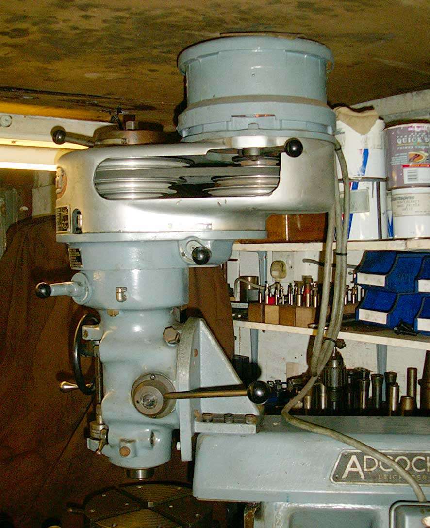

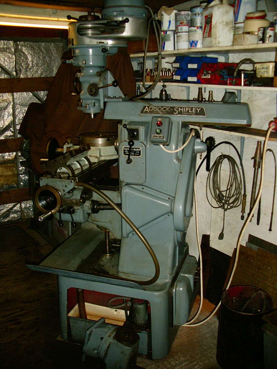

                                              I used to have one of these, I looked for a Bridgeport head but found they were very rare, expensive and the total machine height would have been too tall for my workshop.
                                              Ended up selling it, it can really shift metal though!
                                              I ripped out all the electric gubbins and installed an invertor.
                                              #753784
                                              Phil P
                                                @philp

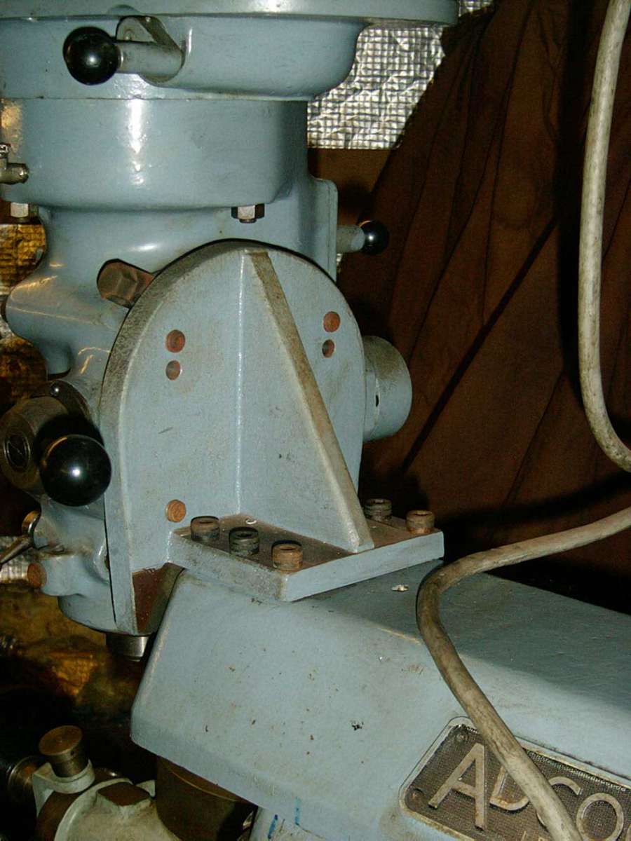

                                                Many years ago I did that mod on my 1ES, I made a pattern and had a bracket cast. I did not make it so that it would swivel to keep it as simple as possible. I have to agree it was very tall and the single garage roof was actually touching the top of the motor with just a thin sheet of rubber in between.
                                                With the vertical head mounted like that you could push the overarm right back and fit the original vertical geared head, or even use it pulled right out for horizontal milling.
                                                The machining of the overarm to accept my bracket was done on the machine itself to ensure it had a flat face to mount onto. I included a couple of jacking screws to push against the end of the overarm to minimise any sagging due to the weight of the head.
                                                It was quite a useful machine set up like that, and I would probably still have it had I not inherited my Alexander Master Toolmaker when dad died.
                                                bridgeport-side-view
                                                P0002270bridgeport-bracket

                                                  Yes it’s a nice sturdy machine and can chomp away at steel quite comfortably, I’ve also bypassed the electrics and run it off an inverter.
                                                  Thanks for the pics that’s exactly what I was thinking about doing but will also have to check height so it fits ok. Nicely done though so you could still use the original vertical head 👍🏻
                                                  would also be nice to have more space from spindle to bed too

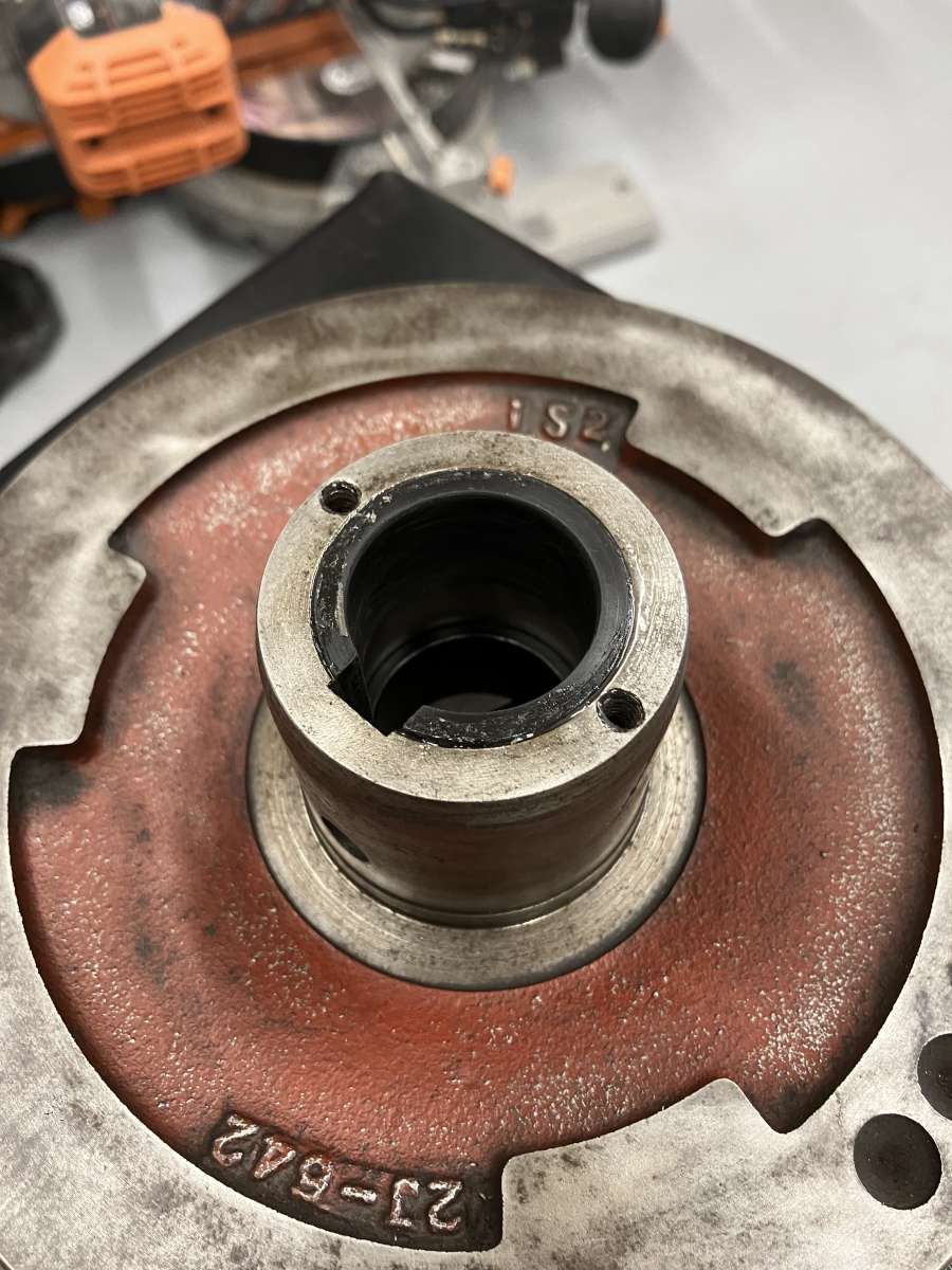

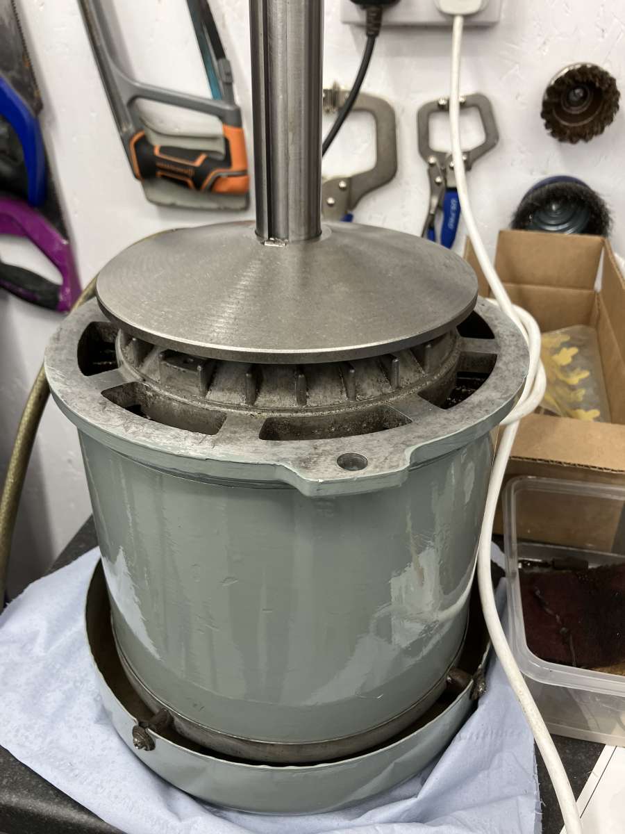

                                                    Hi
                                                    Have just picked up a 2hp Bridgeport Vari speed J head for a great price. Needs an overhaul and motor needs a new spindle, but got myself a nice winter project (autumn actually) 😬
                                                    jay

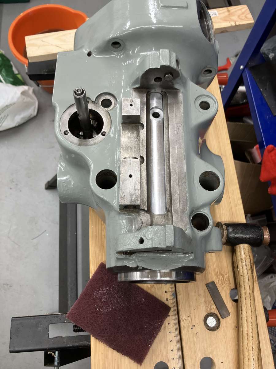

                                                      Stripped the Bridgeport head. Motor rebuilt with new spindle and bearings, runs very quiet. Teflon bushes were buggered on the motor pulley, so have remade some out of Delrin. Quill housing cleaned up and painted. Waiting on spindle bearings now.
                                                      IMG_8554IMG_8553IMG_8555
