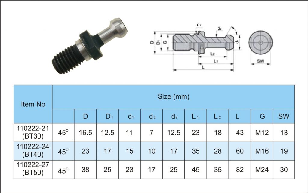

      I errantly purchased a ten pack of Emco compatible ISO30 pullstuds off ebay for an F1 I'm trying to stick together thinking they were BT30. Of course when I got around to sticking them in my collet chucks I saw the mistake. They don't fit my National, Briney, BP, off-brand, etc – the cylindrical portion above the thread being .010 or so thou too large for the BT "hole". They thread very nicely but as soon as the locating features touch it's game over.
      Being very new to the BT spindle set-up I'm not sure what is what. In practice how critical is the locating diameter (the part that disappears into the collet chuck) on the pull stud? If I try hardturning it and get a little deep or screw up the finish by accident will there be an issue? And second, if hardturning doesn't work and I end up making my own, what (tool) steel is best to use for a stud? I don't have a surface grinder to rig something up on and definitely not a cylindrical grinder so I'm kind of left leaving them in a soft state or praying they don't warp badly.
      Now that I've written the above I'm curious if the ISO stud head is even in the right place height wise for a BT. I'll have to go check that off line but I guess my question regarding what steel to use for the studs is still applicable.

            Chart below gives details of the BT range of pull studs, note the spigot diameter is 12,50mm diameter for the BT30. The pull contact angle on these is 45 deg whereas the Emco studs have a 3.50mm radius at the pull contact point. I have several with the 45 deg angle and have no problem in use on an F1.
            Emgee

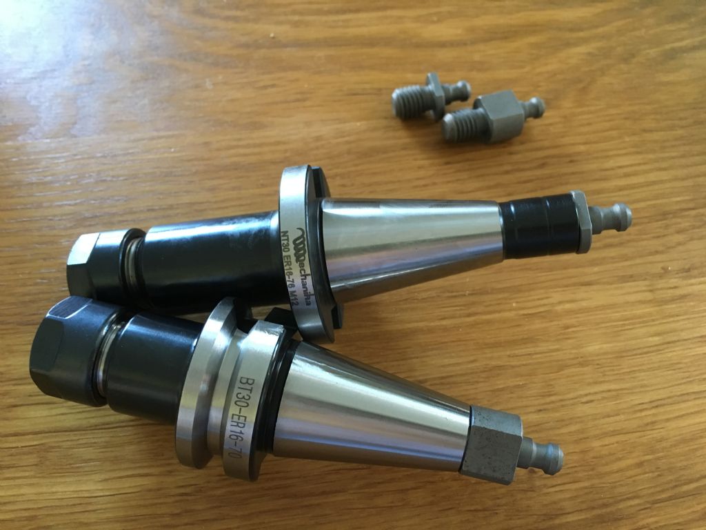

                  This is how I got around the problem. My machine is NMTB30 (imperial version of ISO30) yet BT30 is more readily available. So I got 2 sets of pullstuds made. The longer one is for BT30. The parallel shank on the top tool is not consistently defined in length from tool to tool but is easy enough to turn back. This style of holder was probably designed for drawbar so the length was less critical, whereas the BT etc style was designed for pullstuds.
                  If the pull stud head is not in the right place, it won't do a lot of pulling…
                  BT and NMTB holders
                  Dunno if this clarifies matters!
