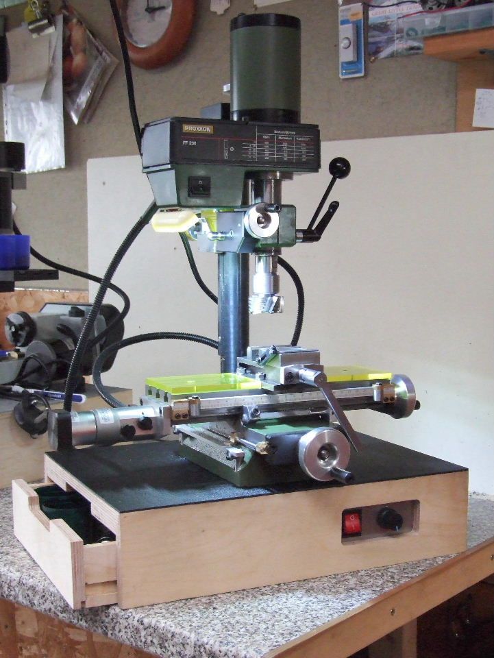

              #629341
              Graham Meek
                @grahammeek88282

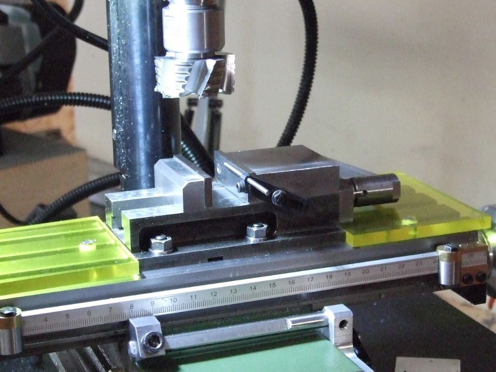

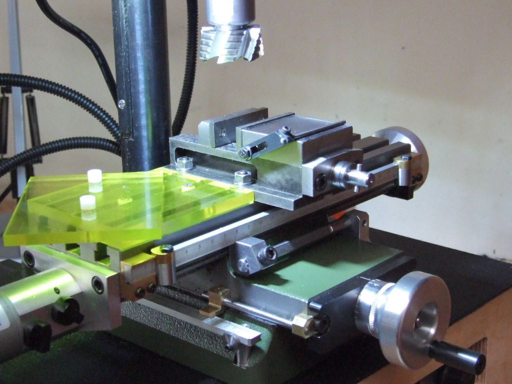

                The Mounting Board for the Proxxon mill has finally been fitted. The Switch and Knob are for the variable power feed. This now has a dedicated 12v Power Supply feeding a PWM unit. While I have more variation of the feed rate lower down with this set-up. It has been at the expense of a reduced top feed rate. However due to use of the Proxxon plug arrangement on the table feed motor. It is still possible to substitute the Proxxon power supply if needed, so I have the best of both worlds.

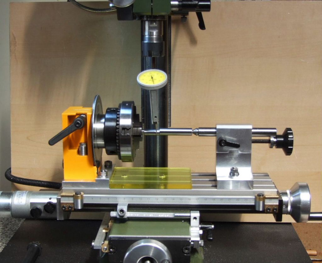

                Talking to a friend recently I was saying I was making a milling machine vice stop for the Proxxon mill. My listener was not familiar with this term or set-up. These type of stops are used widely in industry and I have used countless hundreds in my career. Up until I had completed this unit I had been managing to do jobs with a stop mounted in the tee-slot off the milling table.
                However the manufacture of the Table Protectors to help keep the table clear of swarf made using this type of stop a nuisance. Plus when using the vice as shown above there is no Tee slot to use such a stop.
                This view shows the construction of the table protectors and the stowing position for the stop when this is not being used. The spigot positions are such that the protectors will also fit across the table when using the Emco Compact 5 rotary table.
                The Acrylic is Yellowish and it is not the camera. This was some off-cuts I had left over from an assembly tool which used UV light and this particular Acrylic blocked the UV.
                Regards
                Gray,

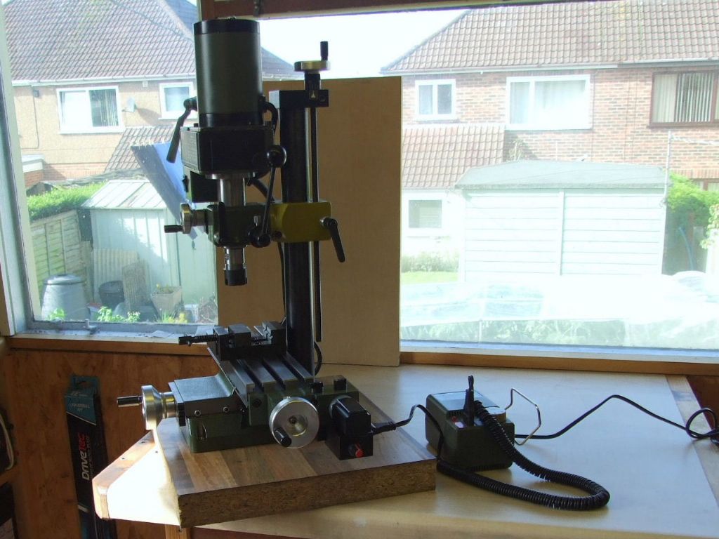

                #633891
                Graham Meek
                  @grahammeek88282

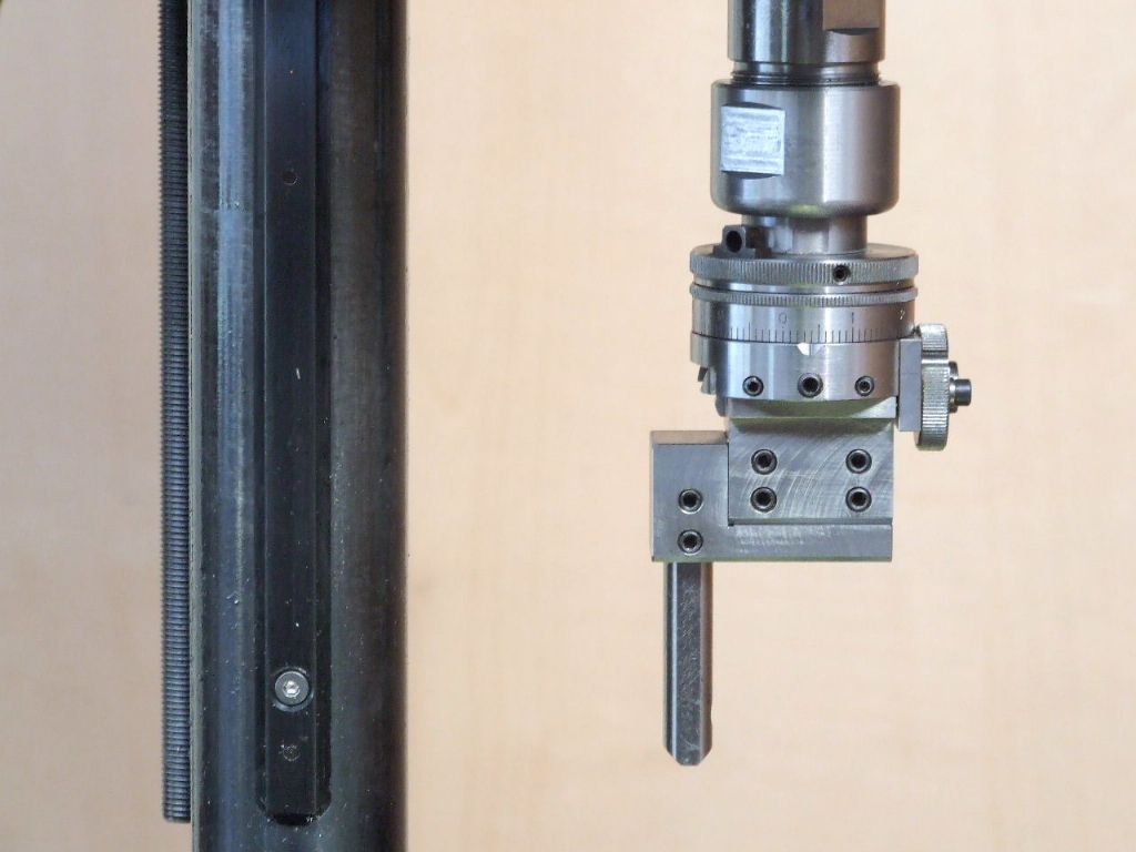

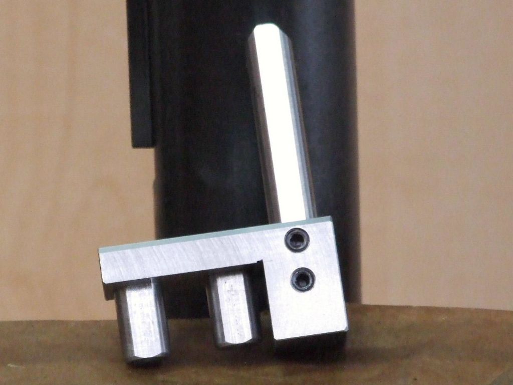

                  A while back in this thread I had to use my smaller Boring head to extend the range of my Boring and Facing head. A set-up which I was not impressed with, but it did do the job. I have since made a dedicated Extender block for the B&F Head, shown above.
                  Those Eagle Eyed among you might notice the two dowels in the Gib strip. This forms part of a further refinement for this machine and I will shortly post more details about this.
                  Regards
                  Gray,

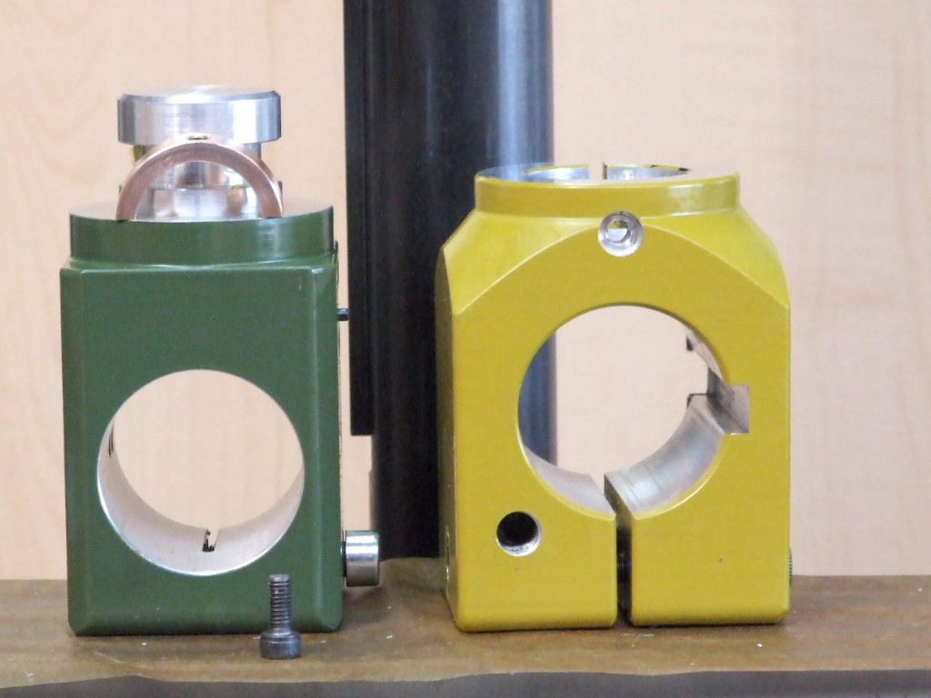

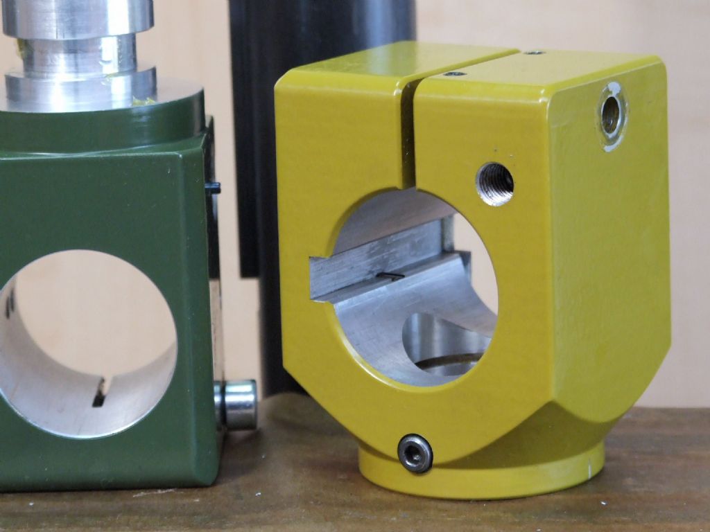

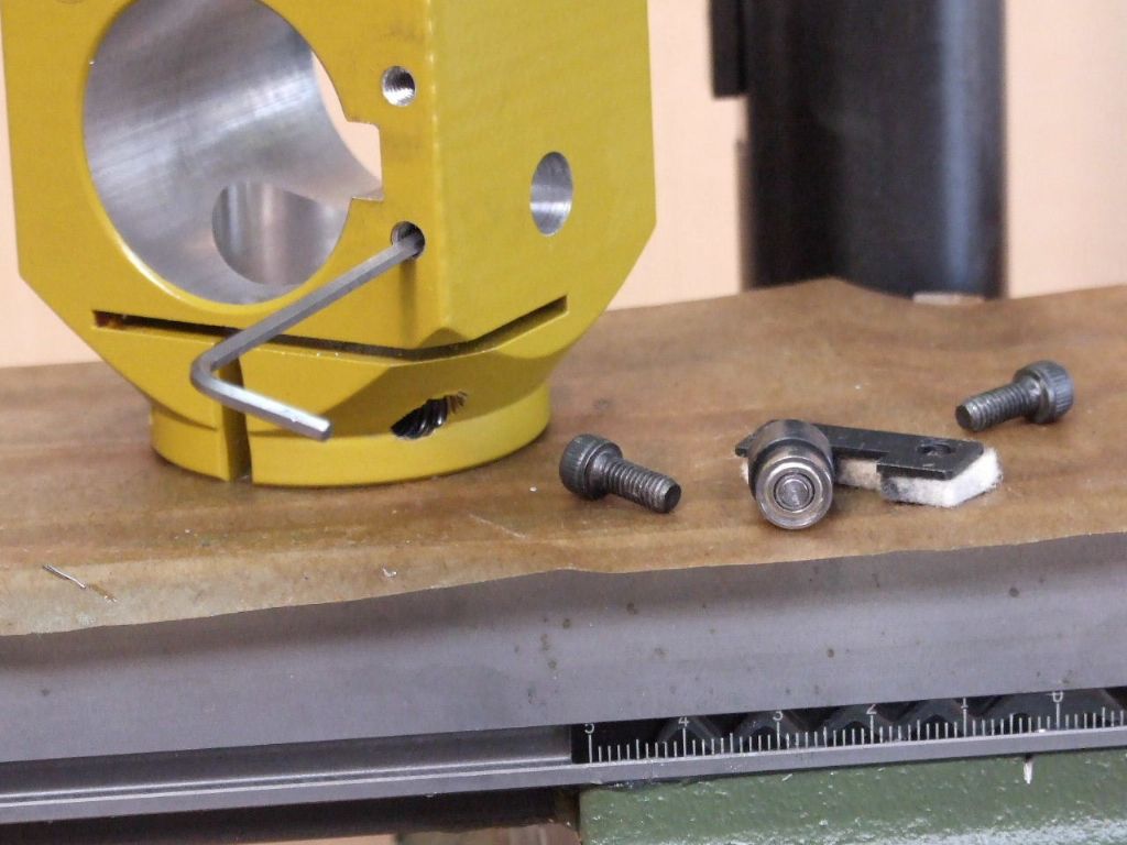

                  #634013
                  Graham Meek
                    @grahammeek88282

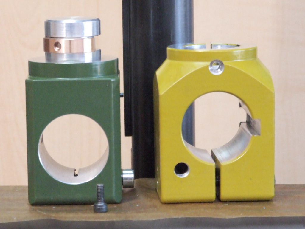

                    I did think when I purchased this machine, given it's country of origin. That I would not have a lot to do to get this machine to where I wanted it. The Guide strip or Key down the Column was one area I thought would not need any attention. Unfortunately this time I was wrong.
                    The Guide strip is held onto the Column with countersunk Allen cap screws. Experience has told me that the heads on these screws are seldom concentric with the thread. The head will therefore tend to move sideways the item being secured.
                    This was one of the issues with this machine. While the Guide strip was relatively straight, 0.05 mm bend over the 290 mm. When fitted to the Column there was helical run-out of around 0.2 mm from end to end.
                    Straightening the Guide strip 0.005 mm over the 290 mm and counterboring the countersunk holes to take shallow head M3 cap screws, eradicated the helical error. To make sure the Guide strip did not move during use four 2.5 mm hardened dowels were fitted at 90 mm centres.
                    In the above photograph you will see two additional M5 cap screws have been added to adjust the clearance between the Column and the Slider. Next to these is a large slotted screw head. This carries an eccentrically mounted ball bearing race which eliminates the play between the Slider and the Guide strip.
                    This shot shows the bearing just showing in the sidewall of the keyway. Note there is no loss of bearing area on the internal surface of the Slider to Column interface.
                    These are the adjuster parts and wiper assembly to keep swarf out. The Allen key is in an M4 grubscrew which locks the eccentric adjuster via a copper pad.
                    This shows the basic modifications . The two tapped holes on the top of the Slider are to lock the M5 cap screws after adjustment. There is a Delrin pad beneath the M4 grubscrews.
                    These modifications have totally transformed the machine in use and have been well worth the extra work.
                    There is one more small mod which I will detail later.
                    Regards
                    Gray,

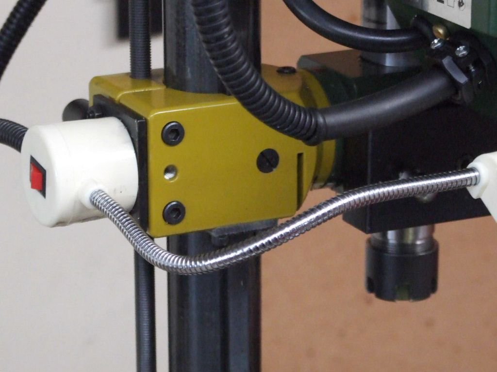

                      Just a caution, I bought 2 of those little Swan neck lights, but I've binned them. They have a capacitor to limit the current, but the plug wasn't handed, so the 240v could easily be applied to one end of the leds via a very thin wire inside the metal neck. No earth, no double insulation. Potentially deadly
                      #634150
                      Graham Meek
                        @grahammeek88282
                        Hi Duncan,
                        I have three such lights in use and as yet I have not had any problem with them. These lights came with a slotted tag on both wires which were the same colour.
                        It is not my final answer to the lighting problem as I does leave a unlit area the other side. I also have to watch how bright a light I use. Too much brightness will induce a migraine. Halo type lights are too bright having tried these.

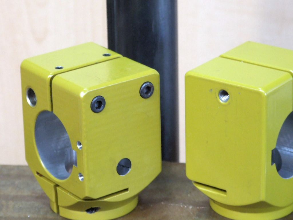

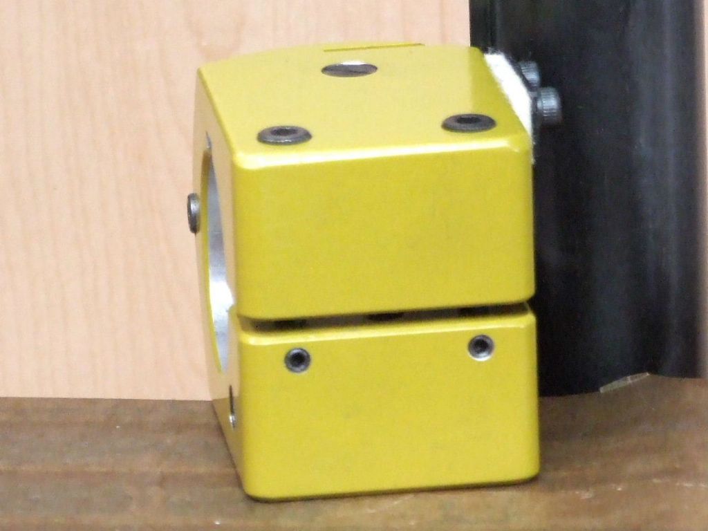

                          One thing I had noticed when "Tramming" the milling head was that there was a tendency for the Quill housing to work it's way out of the Slider.
                          To solve this I have made a semicircular Bronze Key which fits in the groove machined to provide clearance for the M6 Cap screw which clamps everything up when the Milling head is dead true.
                          The key is held in place with a single M4 Cap screw. The counterbore for this can be seen in the top face of the Slider.
                          The Bronze ring provided two Keys which was handy as I have a spare milling head.

                            Posted by duncan webster on 18/02/2023 23:37:07:
                            Duncan, I dont want to take Grahams thread too far off topic but from your description those work lights should not be on sale in the UK.
                            From the descriptions of the ones being sold on ebay and Amazon I would have assumed that there was a proper SMPS in the magnetic base, if its just a capacitor dropper than I'm appalled! Please can you confirm if that the case?
                            In any event the ones I have seen are being marketed with a USA 2 pin plug so the product is wrong on several levels. But they look downright dangerous.

                              Hi Ian P,
                              I can tell you there is a circular populated Circuit board contained in the plastic cylindrical housing. I cannot say for sure how many components are present.

                                Its quite possible that the PCB contains an PSU with an isolated output but in one sense its irrelevant as almost certainly it will not be compliant with UK regs.
                                I know you have the lights fitted to a machine and in use, so please be careful, I suggest finding some way of adding a ground wire to metal flexy bit.

                                duncan webster 1
                                  @duncanwebster1
                                  As I said I've binned mine. No switch mode, capacitor. Bought direct from China, not UK stock. You won't know you've got a problem until you're twitching on the floor.

                                  Kiwi Bloke
                                    @kiwibloke62605
                                    Gray. Interesting mod, that can be applied to other machines, of course, and beautifully executed, as we've come to expect. Two questions…
                                    1. Why did you choose to use a roller (ball bearing set) to follow the guidance strip/key, rather than fit a gib strip?
                                    2. (Apologies if I've overlooked the answer). Is the column's guide strip/key located in a groove in the column, or just planted on its surface, or on a flat?
                                    #634272

                                      Re the LED lamps: why bin them? It should be fairly easy to convert them to a low-voltage supply. Surely the mechanical hardware is worth a few bob?
                                      #634307

                                        Posted by Kiwi Bloke on 20/02/2023 00:35:42:
                                        Hi Kiwi Bloke,
                                        My original thoughts were to use two of these lamps either side of the milling head in bespoke units. With more rigid arms. The Flexible arm is good in theory, but does start to droop over time. In the current set-up the head of the light unit is held by a single screw which also holds the internal circuit board of the mill.
                                        This position affords the best option from an operational point of view, but it does not illuminate the X-Axis dial in low ambient light levels. A good point for me is I don't run the risk of the light catching me in the eye and triggering a migraine.

                                        #634435
                                        Kiwi Bloke
                                          @kiwibloke62605
                                          Gray, did you overlook my previous post?
                                          #634460
                                          Graham Meek
                                            @grahammeek88282
                                            Posted by Kiwi Bloke on 20/02/2023 00:30:45:
                                            Hi Kiwi Bloke,
                                            I apologise for not responding before but I did not see this post.
                                            1. To fit a Gib adjustment strip would necessitate opening up the Keyway in the Slider. Twelve months ago when I had my other equipment this would not have been a problem. Today that would be impossible unless I subcontract the job, which is fraught with problems.
                                            Fitting a Gib here would also mean putting the adjustment screws in from the back of the machine.
                                            When the head is unlocked the turning couple due to the weight of the milling head. Tends to concentrate the force at the top of the rear face of the Keyway. This would be directly onto the Gib strip if it was situated here.
                                            The ball race allows the adjustment to come from the opposite side and any droop from the turning couple is taken by a solid face. I also chose the ball race because this would reduce the drag. When compared to a full length Gib strip. It will also tolerates a slight deviation in the Key strip width, due to this being just drawn bar stock.
                                            2. In an ideal world I would have fitted this key in a shallow groove. This does two functions in that it would take out any straightness issues from a bent Key strip. Secondly it is not going to move in use. Plus it would not matter if Countersunk screws are used.
                                            Proxxon have had two different types of Key strip attachment from the components I have in my workshop. Some years back they were attaching the Key strip with M4 Slotted Countersunk screws. This Key strip is planted directly on the Column diameter. The Column on this set-up is of "Drawn" appearance.
                                            Currently there is a flat machined on the Column and the Key strip is held with 3 x M3 Countersunk screws onto this flat. Even here there is a second deviation in that some columns have been turned, while the two new ones I received from Proxxon recently have been "Ground". I have put Ground in inverted commas because I am of the opinion from the finish that this may have been done with a tube linisher. The new Columns do perform better than the old ones.
                                            I hope this helps?
                                            Regards
                                            Gray,
                                              When I say binned, they are in the scrap bin awaiting further use. I did actually modify them by cutting the pcb in the head and so getting them to work on about 20v if I remember correctly, but a refit of the main power supply took away the 20v supply, and so it was a lot easier to start again.

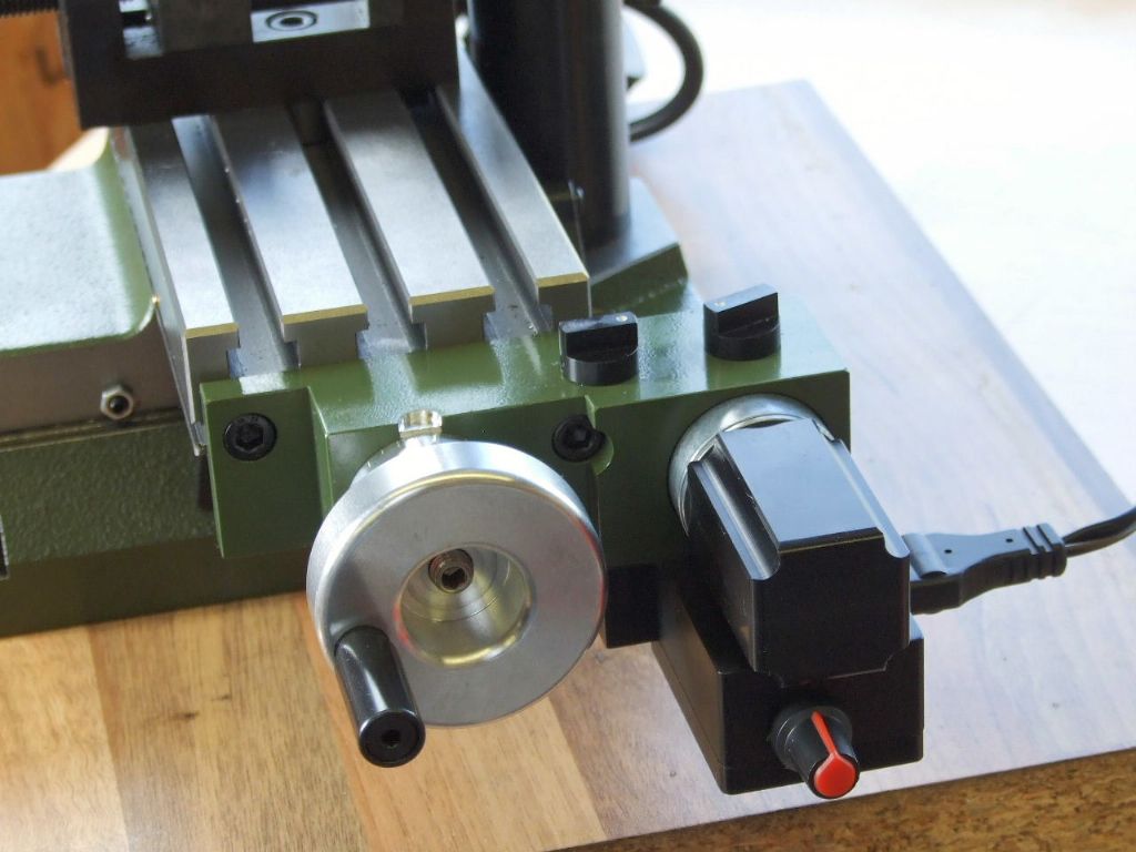

                                                  #662063
                                                  Graham Meek
                                                    @grahammeek88282

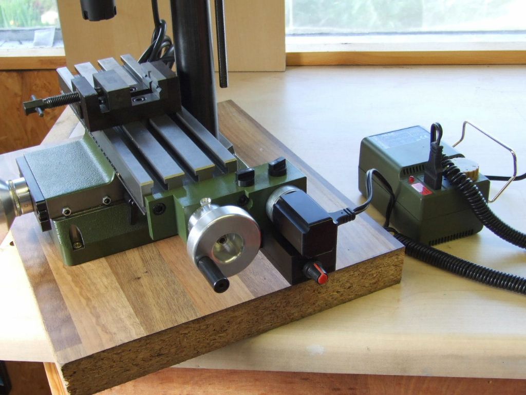

                                                    I have just completed this revised table feed attachment. It was designed with a view to the FF 230 mill requiring no modifications in order to fit the unit. It simly bolts on where the original feedscrew bearing plate fitted.
                                                    I had some help from John Slater in the form of a small PWM board. The control and "ON-OFF" for the PWM can be seen below the motor housing.
                                                    The two knobs on the top of the unit control the direction of travel, (nearest the handwheel), and the clutch to engage the drive to the table.
                                                    Not only is there a variable drive through the PWM, but the Proxxon NG 2e Power supply can also provide additional variations. The table is really going some when the both controls are on maximum. As yet I have not had time to calculate the exact top feed rate.
                                                    Regards
                                                    Gray,

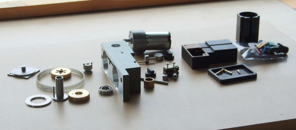

                                                      As is usual lately I have forgotten to add a photograph of the component parts of the feed attachment.
                                                      Regards
