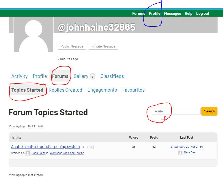

                John, for your reference, Right clicked on your user name > open in new tab (so I didn’t lose this topic.)
                Forums > Topics Started > Search “Acute”
                You could get to the same place by going to your own profile, circled in blue

                      Bill, thanks for that.  Yet again the forum search proves useless but your way works fine!

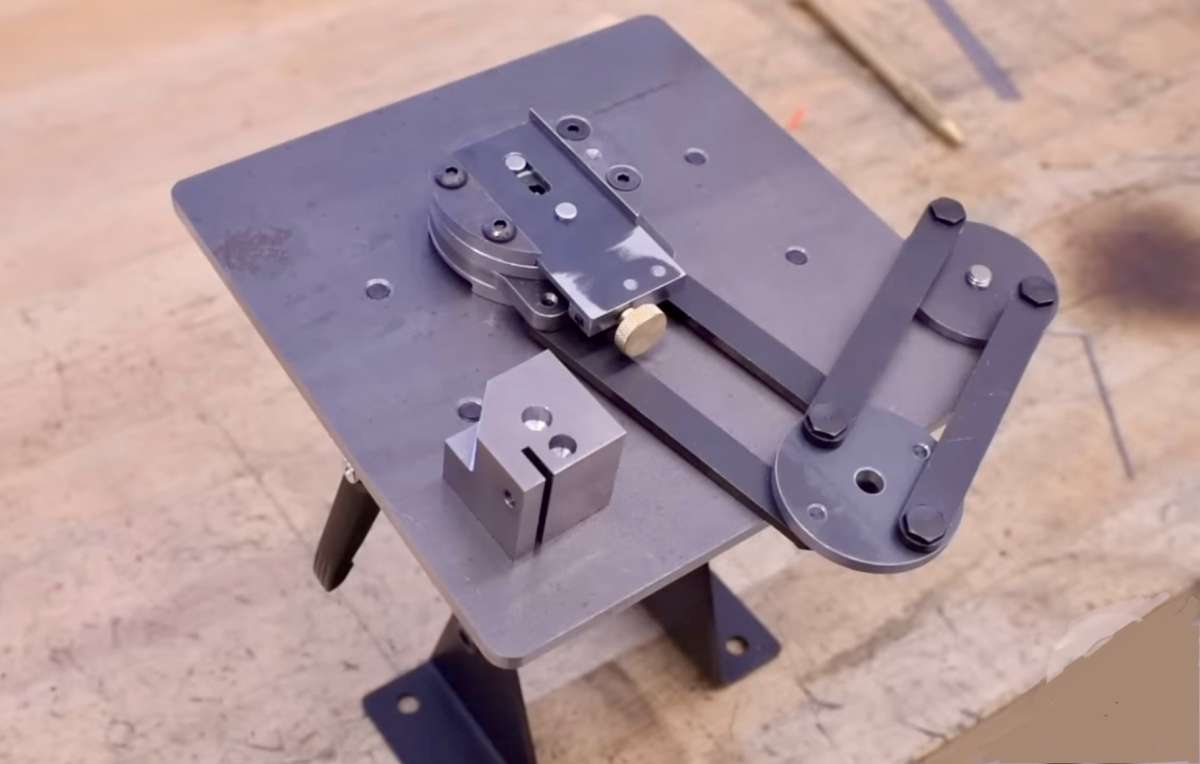

                            I’ve looked at a couple of video builds of some of the parts and it’s left me with a few thoughts. This linkage for example. Having several round components didn’t make some machining operations particularly easy. As far as I can see, most of the discs in this picture could be made from square or rectangular parts instead, or am I missing something? The tool holder at the top does need to have a large hole in one of the components but that particular item isn’t even circular to start with.  The complete assembly may look better with round parts, but Aesthetics aside, building from plans only would be much easier using square stock.
                            IMG_0723
                            #735672
                              On Vic Said:
                              […] As far as I can see, most of the discs in this picture could be made from square or rectangular parts instead, or am I missing something? […]
                              Perhaps the risk of superfluous corners colliding ?
                              … It would be worth just checking your proposed geometry carefully before deciding.
                              All shown nicely in motion in Eccentric’s own video:
                              https://youtu.be/bzEQCvE1cIk?feature=shared
                              #735687

                                I did wonder that Michael, but provided there aren’t any sharp corners I can’t see that happening. Should be quite easy to ensure it doesn’t occur with some small modifications though if needed?

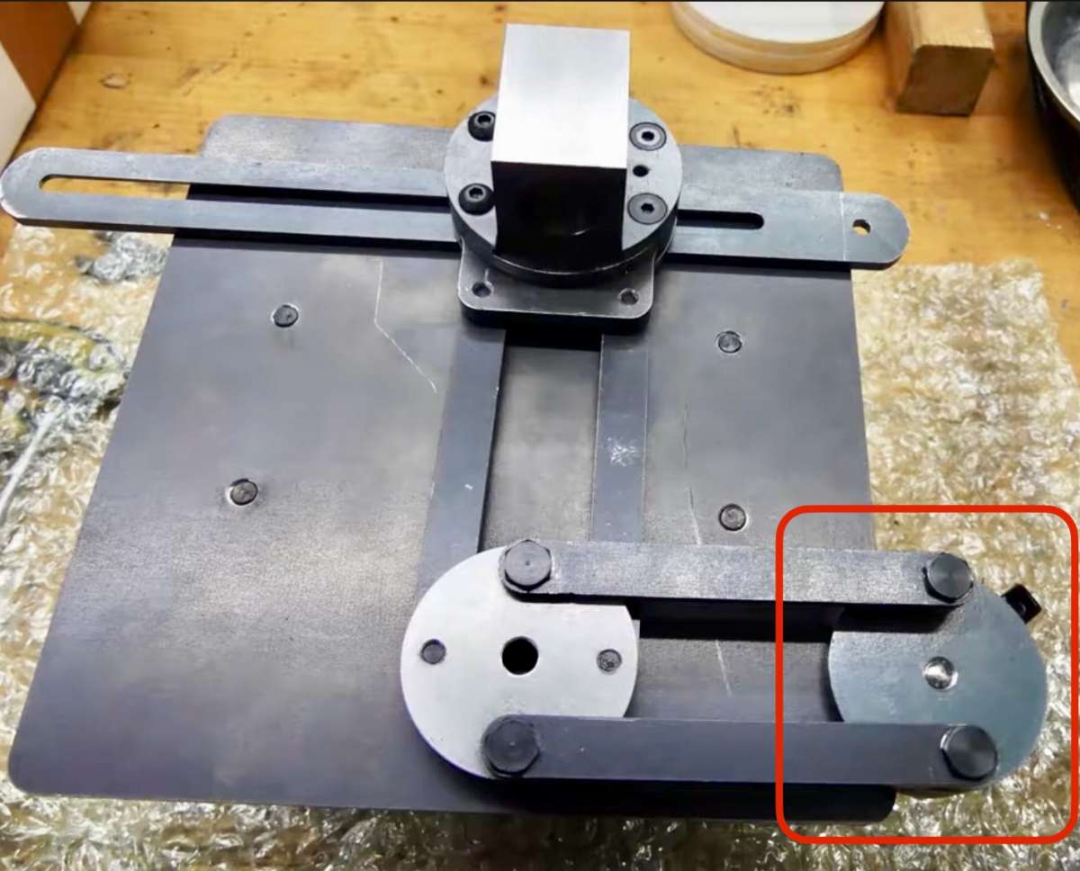

                                  Another thing I noticed is this clamping disc on the right. It seems to be the same thickness material as the other disc on the left. As the one on the left is raised up by the two vertical links and bolts the clamping disc is much lower. This requires two small spacers to be fitted to keep the lower two links in the picture parallel with the table.
                                  If the clamp disc was thicker you could dispense with the spacers?

                                    Quite possibly – I guess that wasn’t the approach Gary took because the blanks are all laser cut from the same sheet thickness, but if parted off from bar you could make them whatever thickness you want.
                                    I think actually that it’s easier not to use square stock if making from scratch because all these components are easy turning, facing and parting jobs from round bar.

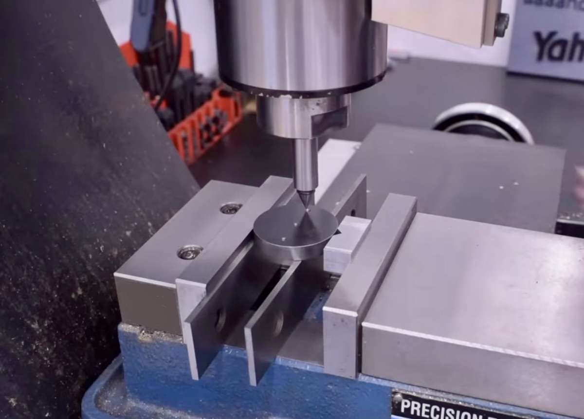

                                      I’ve watched two people making these components on YouTube. Milling and accurately setting up for drilling and tapping etc seemed to cause some headaches working with round discs.

                                          Should not be too hard to drill them in the round, central hole can be done while in the lathe. Then fix your 3 Jaw to the mill table, put the first disc in the chuck and locate ctr, offset to drill the holes. Then just put the other discs in and do them to the same handwheel or DRO settings.
                                            One guy did that on the lathe and then discovered the spotting, and resultant hole were not central to the blank. The piece looked a mess when finished with an oval central hole.
                                            Another did it on the mill and spent ages setting up the disc in a mill vice. One additional problem is that being laser cut the edges aren’t square. It was commented that the spotting is not as helpful as it appears.
