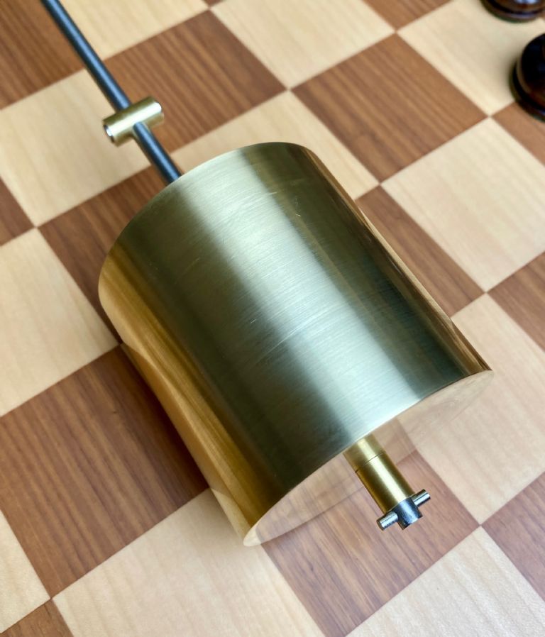

      Hello forum members,
      What are your favorite methods of preparing (sanding, etc.) and finishing brass for a long-lasting bright finish without tarnishing and staining?
      Thank you.

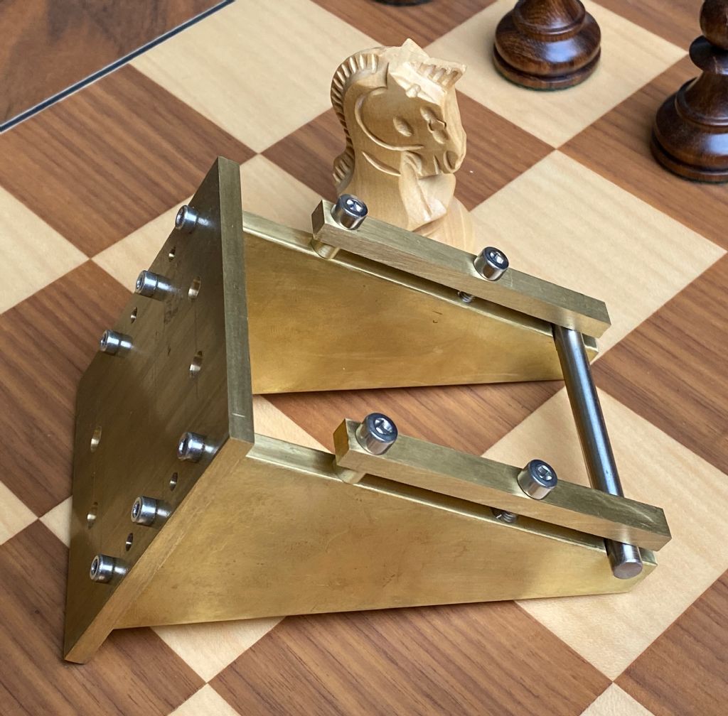

                S K
                  @sk20060
                  No, I'm not painting it! 😄
                  This is the kind of thing I'd like to finish. I'm not fully satisfied with the sanding. Maybe a bit more tooth?
                  I think I'll try the suggested wax.
                  Thank you!

                                  S K
                                    @sk20060
                                    Thank you all for your advice.
                                    I went with Renaissance Wax. I first sanded the parts back to 400 grit, trying a little for a uniform grain direction, and I felt this gave a better finish in brass. The wax is easy to apply, and it seems to resist fingerprints to a degree. I'll be interested to see how well it holds up.
                                    Here's an example after waxing. Thanks again.
