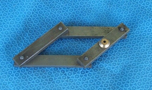

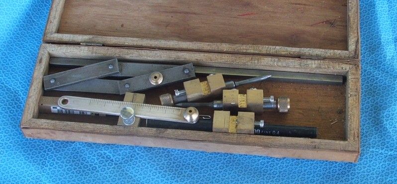

                Or you can make up a variant of this gizmo of mine – carefully done they are very accurate and accommodate a range of sizes.
                [IMG]http://img.photobucket.com/albums/v332/laneranger/set5.jpg[/IMG]

                      Use a pair of dividers and scribe a line from both sides. With a bit of luck you will end up with one scribed line, if not the centre is the mid point between them.

                        Hi Tel, that looks interesting, is the bush for marking center hardened, and is it loose so that diferent sizes may be used? I’v got metal cut, ie., 4 pieces with holes at the ends, only need a hole in the center of one of them and its done. Ian S C

                          Nope, mine is not hardened, but I suppose it could be of advantage to do so. I only made the one bush, which takes a scribing point ground from a concrete nail, which tend to be very consistent size and finish wise – grind the points on the HH grinding attachment with a suitable collet in the end mill fixture adjusted to run with a little resistance – gets the point nicely in the center (which is the point, ain’t it?) I’m pretty happy with the way it will automatically pick up the centre of the stock – not always the case with some of the other methods!

                                  Now that’s something I have been intending to do – a version of John’s digital gizmo with a cross piece on the standing jaw to help keep the whole thing square to the workpiece – a thing that kept me from ever having much luck with odd leg calipers.
                                  The idea of that thing I made has been around for a very long time – I made mine up as part of a set of marking stuff
