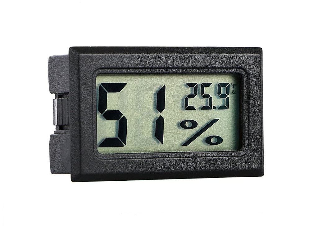

      Now I have increased the level of insulation for my small workshop, I am curious to note fluctuations in humidity as I vary the temperature, aiming to keep the minimum temperature around 10 deg. The best thing is obviously to buy a decent dehumidifier but anyway I am wondering if any members can recommend a hygrometer for the workshop that is both inexpensive (sub £25) and accurate. I have found online reviews of most cheap hygrometers rather disparaging regarding accuracy…..Thanks

                                            Can't vouch for accuracy but I use a couple of these:-
                                            One to monitor the humidity inside a filament storage box and one outside the box in the workshop. From several suppliers at Amazon and similar for a couple of quid. Different styles and colours some have equal size temperature and humidity readouts. Press-fit into a hole about 45mm x 25mm or just leave them loose. Make useful fridge thermometers as well. More on filament storage box *** HERE ***
