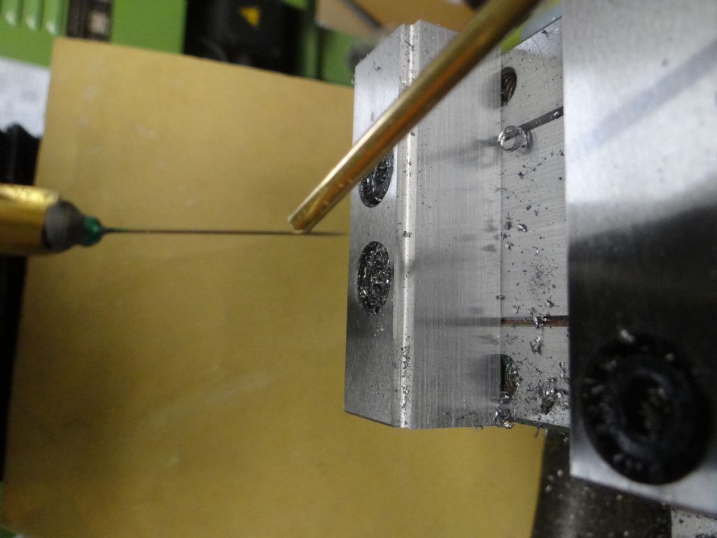

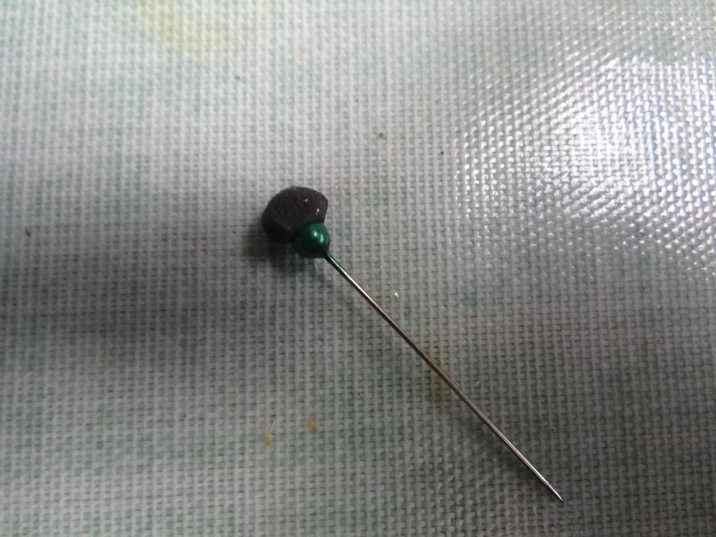

        As per Jason's advice here's some pictures. I use dressmaking pins which are about 30mm long and have a big round bead on the head. I find this form of sticky pin with a loupe outperforms my 'proper tool'.
        Pin with blob of soft modelling clay: some makes are softer and stickier than others. I don't think blue-tack is as good.

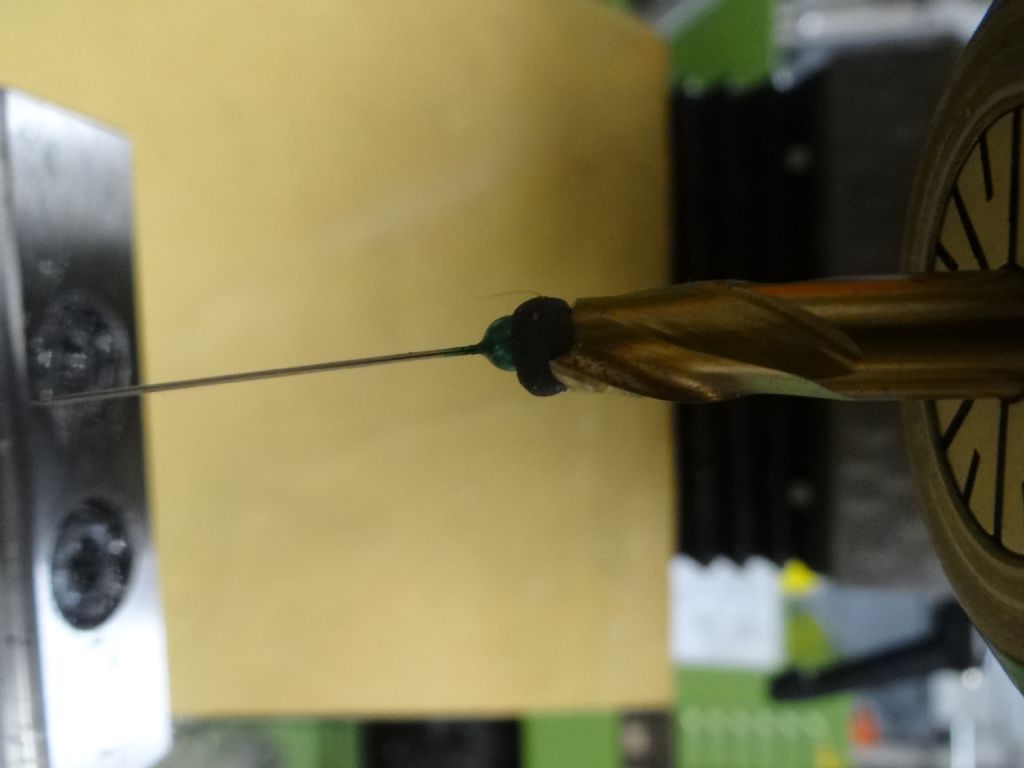

        Pin stuck more-or-less centrally on the base of a milling cutter.

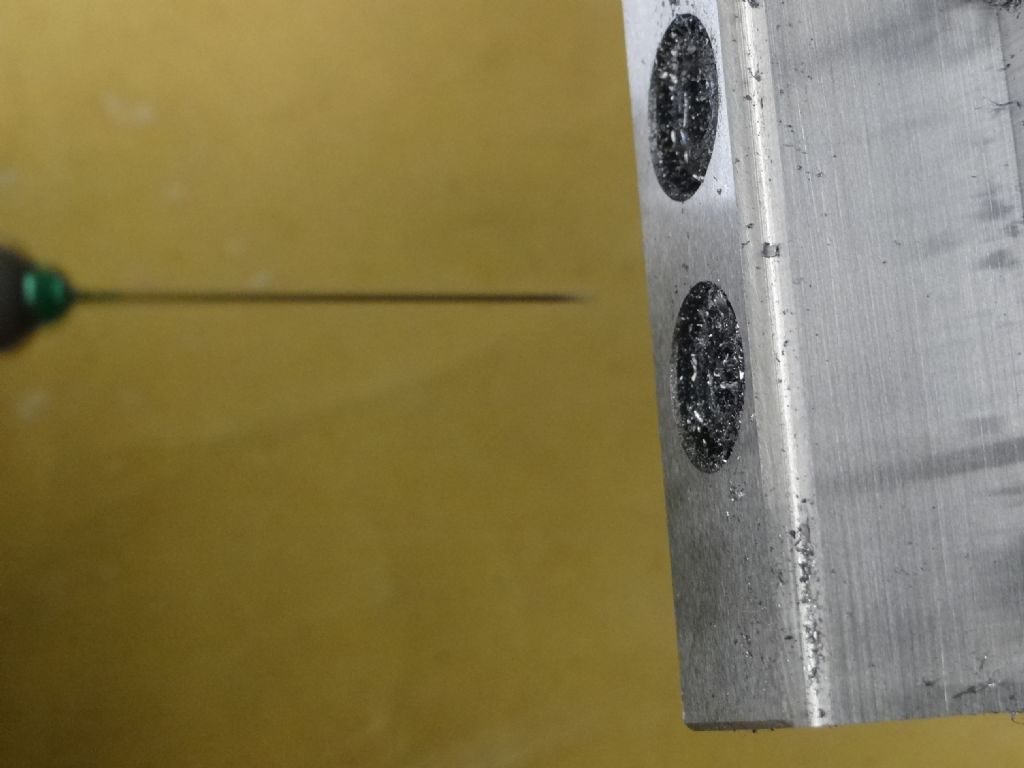

        With the pin spinning at about 1200 rpm gently ease the sharp end into balance with a smooth rod. (Pencil, knitting needle, etc.  This takes a little practice.  Beware of the pin flying off if it's badly out of balance.
        In this photo the pin is spinning at 1250 rpm with the sharp-end accurately aligned with the rotating axis of the milling cutter., ie centred.  The blur is due to the camera auto-focussing on the vice rather than the pin.  In real life the pin is steady.

          Steven, provided the top end of the pin is not massivelly off center it does not matter so long as you set the pointed end to run true

                        The sticky pin / wobbler works like a spin stabilised rifle bullet. Spinning around an axis ends to even out any imbalance and the object centres on the axis.
                        In the case of a sticky pin, the head might well be slightly off-centre where it's attached, but it doesn't matter because the free end can float. Once the free end is spinning on the axis it stays there. I only mentioned the pin flying off because if you push the sharp end too far away from the axis centripetal force will take over and fling it off at a tangent. Perhaps my method is faulty!
                        Interesting to see how other people do it. I always stick the pin directly on the cutting tool, centre it roughly, and then wind the speed up to about 1200 rpm while using a rod to correct any gross sideways movement. I don't try and accurately centre the pin until it's turning fast. At higher RPM the pin seems to snap into position more readily. The method works well: BUT you do have to keep well away from the cutter and wear eye-protection in case the pin comes off. Am I doing it wrong (again)?
                        By the way I don't align the point of the pin to the work with the machine running! Once the pin is stable, I stop the machine, and then use the XYZ controls and a magnifying glass to position the work accurately under the point.
