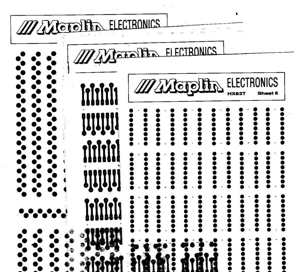

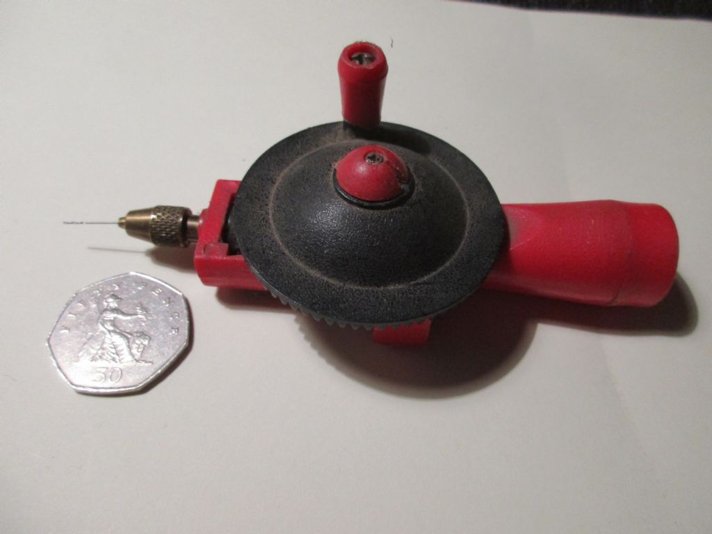

                                                  Hi, it's a long while since I've hand drilled tiddly holes that had to be reasonably accurately distanced apart from each other, it was probably in the early 90's when I was still making my own PCB's and components like transistors and dual in line IC sockets etc. needed to be inserted, The little plastic hand drill in the photo below is what I used and I could often do up to forty or more holes before the drill bit broke, which used to cost about 15p each from a local tool store at that time.
                                                  I suppose one could say I was cheating on the marking out of the hole positions though, as I used these etch resistant transfers that Maplin electronics used to sell, which I found were very successful.
                                                  Regards Nick.
