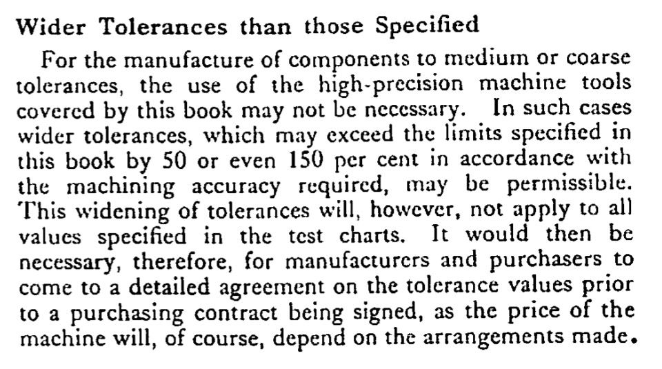

                      Posted by Wout Moerman on 05/01/2018 21:38:27:
                      If the Schlesinger limit is 0.01 mm what does that say for a runout of 0.04 mm? Is this excessive, acceptable or quite good? And how much would it matter in the real world? Just curious. …
                      This brief extract from Schlesinger's Introduction might help:
                      You pays your money and you takes your choice !!
                      P.S. 0.04 exceeds 0.01 by 300%
                      Edited By Michael Gilligan on 05/01/2018 22:04:49
