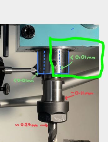

      Somewhat a milling newbie here, just getting an Axminster SX1 mill set up in my tiny home workshop. It came with a 3-jaw drill chuck, and I also got a ‘precision’ ER20 collet holder and two collets from Axminster at the same time.
      I’ve been a bit disappointed to find that there’s quite a bit of run out on the edges of the collet holder and even more on the milling cutter – please see the attached image.
      Is this normal, or should I return the collets and holder to Axminster for a refund?
      I’ve tried cleaning the MT2 taper on the collet holder (and the taper inside the spindle too) but it didn’t make any difference …
      Thanks for your help!
      David 🙂

          The first thing I ask anyone new to milling is have you correctly snapped the collet into the nut before inserting the tool and then screwing the nut on with sufficient force as shown here.
          The two readings off the outside of the spindle and collet holder are not really representative of what is going on as they are not critical, better to tale a measurement of the inside of the collet holders taper.

            As Jason mentioned, the outside surfaces aren't registering anything. The collet holder registers against the spindle taper. And the collet registers against the holder's internal taper. You'll need a DTI to check both of those, which should show where the problem lies.

              Yes that was the first mistake I made — not inserting the collet into the nut first…! So it has been inserted correctly 👍🏻
              The run out on the internal taper of the spindle is the “<0.01mm” text in green with the arrow pointing to the dotted blue line, so that’s fine.
              I’ve just measured it and the run out on the internal taper of the collet holder is about 0.25mm.

                          Certainly 0.25mm runout on the inside taper of a ER chuck is shockingly bad and you should get a no-questions refund. You might consider whether a replacement from the same stockist will be any better. There are other suppliers of this sort of tooling, Arc Eurotrade who advertise here have always been excellent for me.

                                  not done it yet – yes this was one of the measurements on my drawing and it was extremely straight, I barely saw any change on my DTI’s display which has a resolution of 0.01mm.

                                          No it was not. You checked the outside of the spindle, not the internal taper. It has been known that manufacturing has not been to specification.
                                          #586627
                                            NDIY look at the top right of the photo 0.01mm pointing to the taper shown with dotted line as hiddencool

                                                The finger collets arrived today and on initial measurements I'm getting about 0.01 to 0.02mm run out on both of them (6mm and 10mm ones) on the shank of the milling cutters themselves … MUCH better! 😎
                                                Thanks for your help in confirming this was NOT normal for the ER20 system!
                                                Axminster have issued me a freepost return label and they'll give me a full refund for the holder and two collets too, so all's well that ends well 👍🏼
