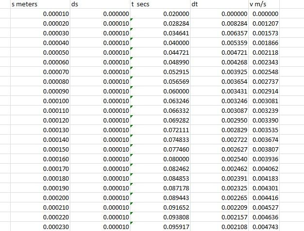

      So I'm making a motor drive for my mill with a stepper and intend to drive it with my own code in arduino.
      So far, I've ignored acceleration (in my first bodged CNC controller for a micromill and the current code for the drive), but with a table + vice + work weighting in at 50kG +, I suspect I can't go from zero to a lot without considering acceleration.
      It's been decades since I did mechanics (the mathematical sort) in anger, so I want someone to check my logic.
      Motor : about 3N
      Mass of table: about 60kg (I'm assuming on earth Mass = Weight)
      f=ma so max acceleration for the motor (a =-f/m) = 3/60 = 0.05 m/s^2 (^2 = squared )
      also, from distance (s) = 1/2 acceleration (a) x time (t) ^2 we get
      t = sqrt(2s/a)
      assuming each motor step moves 0.01mm, I've created a table in excel showing the elapsed time to get that distance with the specified acceleration. From that we can get the time between steps which is how we set the stepper timing up.
      The image below is the first few rows of the calculation
      So the the first pulse (dt-4th column) should be 0.008284 seconds, the second 0.006357 and so reducing as the drive speeds up. The spreadsheet ends up getting to 0.05 m/s (5 centimetres per second( in one second which is what you would expect, so it's probably right.
      Mind you that's 2500 pulses later.
      Obviously microstepping will use shorter pulses.
      So my plan is to generate the acceleration table when I get the velocity input and follow that for the step period until I reach the required speed and then follow a fixed time period until I reach the correct distance (or I encounter a gate) and then just stop. Deceleration is for wimps.
      Mind you, I've just realised that my arduino doesn't have the room to fit that table in so I will have to generate it in another way. Hmmm. That's just software, though!
      I hope this makes sense and that there's someone who can confirm the maths and approach!
      Any suggestions for algorithm are also welcome!

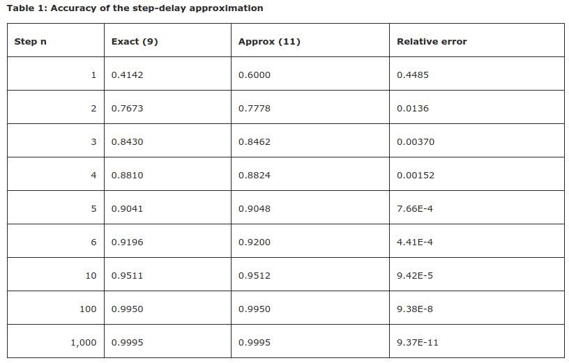

          This is I believe a much-studied problem with a number of algorithms. A very quick Google lead me to this but I have seen other papers on the topic.

            You are a better googler than I am. The stuff I found that was vaguely relevant was even more technical than this!
            I will need to read this properly, but the essence of it seems to be an iterative process subtracting the root of the previous from the current step. Which actually is the essence of what I describe above.
            s is increasing by the same amount each time so to get the time time to get to the current I calculate t = sqrt(2s/a) which is proportional to sqrt(n) and thus the step time is basically sqrt(n+1) – sqrt(n).
            Who new I was clever?
            Then it gets proper complicated and not for tonight. However, that looks very useful and I sort of get it.
            It looks like the sqrt time on the arduino is around 50 microseconds so my brute force approach would work for speeds of up to 20kHz if I can't get to understand the maths here.

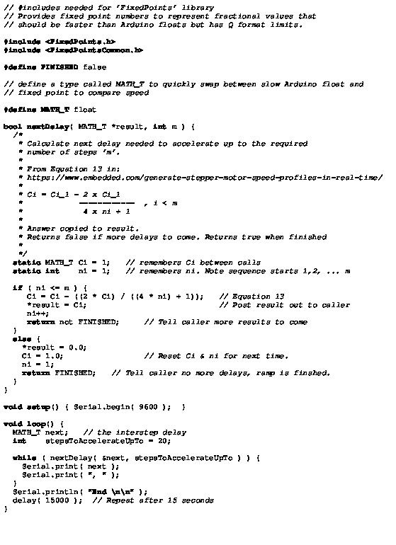

                        I've been distracted up this interesting byway, and am confused by the maths. John's paper compares ideal delays compared with those produced by Equation 13.
                        For 15 steps, my implementation produces the ramp:
                        0.60, 0.47, 0.39, 0.35, 0.32, 0.29, 0.27, 0.25, 0.24, 0.23, 0.22, 0.21, 0.20, 0.19, 0.19, 0.18, 0.18, 0.17, 0.17, 0.16, End
                        The ramp looks reasonable in that gap between steps gets progressively shorter as wanted for acceleration, but apart from starting at 0.60, my values don't follow the table. Nor do I understand how the numbers in the table correspond to an acceleration. I must be missing something again!
                        The complete Arduino program is:
                        My main goal is comparing the performance of Fixed Point maths versus Arduino floats, because the latter, while easy to use, are slow because most Arduinos don't have a hardware floating point accelerator. But I haven't got that far because I'm not sure my code is producing the right answers. Can anyone see if I've miscoded Equation 13, or any other blunders, or – if I've got the sums right – explain why the table is different?
                        I'm fairly sure the issue is me. I'm reasonably confident of my nextDelay() function, fairly confident the code for my interpretation of Equation 13 is OK, and very much less confident I've interpreted the equation properly. I sort of follow the paper, but my understanding is foggy. For instance, I've guessed the ramp's start value is 1.0 for no good reason.
                        Actual code driving a stepper motor needs a bit more thought. For example, in my code there's nothing to stop Equation 13 recommending inter-step delays too fast for a real motor to cope with. A practical driver would likely need to enforce a minimum inter-step delay to avoid losing steps. Though nothing else occurs to me, possibly other considerations. As when I try to use Q-format Fixed Point arithmetic, where the user has to keep a close eye on their range and accuracy limitations.

                                Hi, Dave. I'm getting somewhere with this, but it's a bit of a struggle.
                                As I understand it, when the motor is accelerating each pulse will happen a little quicker than the last one.
                                The bulk of the paper is about the ratio between this pulse and the last one.
                                if we know the delay for a given pulse (Cn), the the next pulse time will be approximately Cn – (2*Cn)/(4*n +1), where n is the step number. Actually, I'm oversimplifying this. as this is the relative time. We still need to multiple by a factor for the actual acceleration, Hmm. Needs more thought
                                So basically you calculate the time for the next pulse based on the last one and this calculation.
                                Having said all that, I'm halfway through getting my head round this practically and it's now about time to close down for the night.
                                I'll try and put this into my sketch tomorrow.
