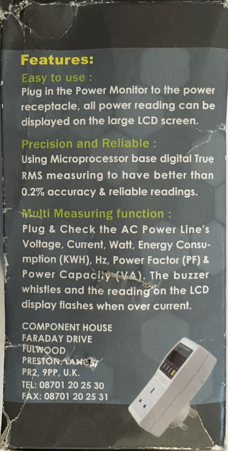

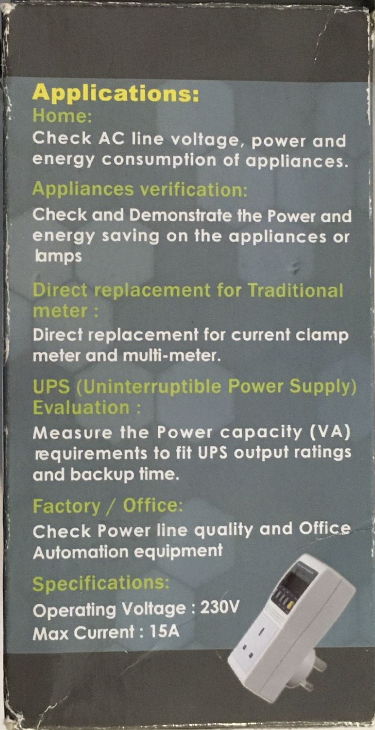

            I have a “Plug-in Power & Energy Monitor”
            Pro Elec PL0964 … Made in Taiwan
            Sorry : No idea whether they are still available.
            Edit: U.K. supplier was [is?]
            Component House, Faraday Drive
            Fulwood, Preston PR2 9PP
            Edited By Michael Gilligan on 17/01/2023 11:01:23

                  Michael,
                  That's still CPC Farnell

                          … < still > ?
                          I didn’t know it ever was blush
                          … I just quoted the address from the text on the box.
                          Edited By Michael Gilligan on 17/01/2023 14:19:08

                              Au contraire … Michael questions the adverts, and what’s written on things.
                              This particular device, with its pass-thru 13A plug/socket appears to do exactly what it claims.
                              Good GriefShock, Horror … perhaps they actually break-out the wire inside the device !
                              Wouldn’t that be clever !?!
                              CorrectionThe Buzzer buzzes … it doesn’t whistle !
                              Edited By Michael Gilligan on 17/01/2023 16:49:40

                                  For the avoidance of doubt:
                                  If your individual AC devices use 13A plugs, then [used as intended] the unit that I have would do the measurement nicely.
                                  What it will not do is give give you a reading when ‘held against the flex cable’
                                  … but nor would their toys !
                                  So we can probably consider it a 0-0 draw, between me and the nay-sayers.
                                  Edited By Michael Gilligan on 18/01/2023 06:20:03

                                        I have an identical plug-in device to that pictured above. Came from Maplin years ago. Has the advantage over the clamp-type meters that it will measure consumption over a period.. So, use with your washing machine, etc, to measure total consumption over a wash cycle.
