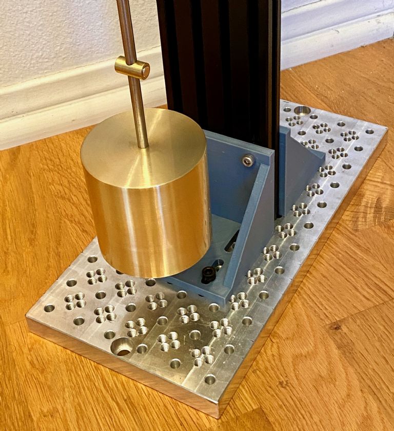

        I realized that I needed a test stand, as it would be too difficult adding electronics and testing the pendulum while mounted to the wall it's intended for, so I printed a pair of brackets and mounted the whole pendulum to a base:
        It's more than sturdy enough for functionality tests, but not rigid enough for highly detailed measurements. It doesn't look like it, but the bob easily clears the lower bracket:
        I still have to add a flag, which I'll probably do in brass to match the rest of the pendulum. The electronics such as the opto sensor and the drive coil(s) will probably be mounted on 3D printed supports.
        It's starting to look real! 🙂

          I like it very much, but what's with all those holes in the brass plate?
          Very pretty, but having plenty of mass at the bottom is a good thing. On second thoughts, it makes sense if the column is bolted to the wall, with the base plate hanging off it to support the optics.
          An observation rather than criticism – fascinating stuff.
          By the by, it's worth chamfering the bob top and bottom to reduce turbulence. I guess a large round fillet would be best, but a small flat chamfer would do good.

            I think that must be an aluminium or steel tooling plate?

              Yes, it's an aluminum tooling plate that I've repurposed as a temporary base. I want to be able to set it beside my computer while I'm installing and debugging the electronics, etc. Later, I'll wall mount it without the base.
              I wish I could have chamfered it! Unfortunately, my puny 3" chuck can only hold the bob by tiny fingernails. There isn't enough grip. Or rather, I could do one end of it, but then I wouldn't be able to hold it at all when flipped around. The bob was the biggest and heaviest thing by far I've put in my toy lathe. It was on the ragged edge of its safe limit, and I spun it very slowly lest those tiny fingernails let go!

                Come on SK it’s got a hole down the middle. Can’t be beyond the wit of man to mount it on an arbor to machine the chamfers?

                  Haha, the bob was too big for my tail-stock, even, so that's out. Work holding anything larger than a postage stamp is my biggest problem. I need to blow a bunch of money on some real equipment!

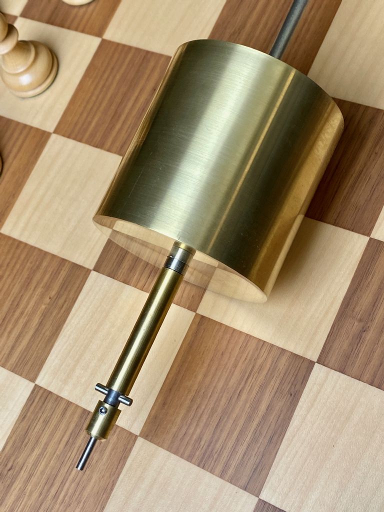

                    I redid the temperature compensation based on the above data, and also to include an Invar isolator.
                    The Invar sleeve resides inside the bob from the bottom, supporting the bob at its 50% point. Its goal is to reduce temperature lag due to the large thermal mass of the bob by isolating the bob from the brass compensation. The Invar sleeve extends below the bob by about 0.15" to provide a small amount of additional isolation outside the bob. The main brass compensator sits below the Invar sleeve.
                    Will it work? It will still be off by some random amount. Hopefully it won't make things worse! If I measure a clear temperature dependence, I might alter the brass compensator to include a small (e.g. 3 piece) binary weighted stack for easier adjustment.
                    I also made a small pointer, positioned at the bottom of the rod, to trigger the opto-interrupter.

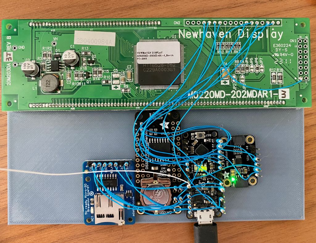

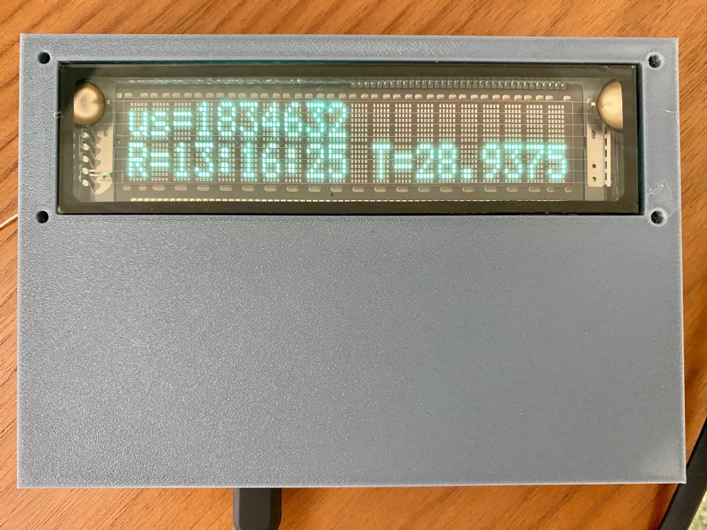

                      I put together a prototype system consisting of a mini Arduino, a DS3231 real time clock, a MCP9808 temperature sensor, an SD card slot, and a vacuum florescent display unit. For now, the items are lightly tacked on using hot glue, and I used the "wire-wrap" technique for easy changes. Later I'll install everything more permanently.
                      • The popular DS3231 RTC is temperature compensated and is good for +/-2 ppm from 0 to 40C and +/-3.5 ppm from -40 to 85C.
                      • The MCP9808 temperature sensor has an accuracy of +/- 0.25C from -40 to +125C and a precision of 0.0625C.
                      For the moment, I'm just using Arduino's internal micros function for the period. It's understood that this is not good enough, and it's already evident that it's incorrect, being a fraction of a percent slow as tested. I'm still trying to decide how I'll do it "for real." The RTC, with 2ppm, is much better, and it has a 32kHz output that I might employ somehow. Otherwise, maybe I'll try hacking the Arduino's oscillator.
                      I chose the vacuum florescent display for its retro appeal. It's not as cool as Nixie tubes, but it's the next best thing. It turned out to be pretty convenient, as I discovered that the module I chose (Newhaven Display M0220MD-202MDAR1-3) is compatible with many of the similar LCD modules out there and with the Arduino libraries for them.
                      I have a faster Arduino-compatible microcontroller that runs at 120 MHz that I may swap in for the 16 MHz Arduino once things are running properly (it's a bit fussier to use), or else I have a few other considerably faster options on hand that aren't compatible with the Arduino IDE. One of those should improve timing resolution (but not necessarily accuracy). I am also considering getting an FPGA to do high speed timing. Anyway, deciding on how to do "proper" timing, and logging data on the SD card, are some of my next tasks.

                        I've trodden this path already, so this may help:
                        • The DS3231 RTC is good, but not that good! Your well-made pendulum with an Invar rod is likely to to be similarly accurate, making it difficult to separate which of the two is wrong. Ideally a measuring tool should be 10x more accurate than whatever is being measured. Provided they have a good view of the sky, GPS modules are as good as it gets, especially if one race-tuned for time-keeping or survey work is used. (Too expensive for me!) They output ultra-accurate seconds pulses.
                        • Arduino micro-controllers include a number of hardware counter/timers. Driven by the Arduino's CPU clock, they count at 16MHz, generate an interrupt on overflow, and Input Capture Mode is a stopwatch. Counter/Timers are largely independent of whatever else the microcontroller might be doing. I use two of them:
                          • When a GPS second RISES, a 16 bit counter clocks nominal 16MHz pulses until the next second RISES, after which the count and number of overflows are captured. Like a frequency counter, this gives a count of the number of CPU clock pulses in 1 second, and with GPS the result is accurate to about 1 part in 16 million. Thus the counter measures the microcontrollers actual clock frequency.
                          • At the same time another counter/timer clocks the number of nominal 16MHz pulses between pendulum swings, giving period in units of about 62.5nS. As the actual clock frequency was measured during the previous GPS second, a better estimate is available. If the clock is running at 15998053Hz, the Arduino is measuring in units of 62.507606nS. More usefully, the approach provides good temperature compensation: the clock frequency was measured at temperatureNow – 1 second.
                        • Most Arduino boards use Ceramic Resonators rather than Quartz crystals. Leonardo or Pro-micro is a better choice than a Nano or Mega2560.
                        • Some Arduino boards allow Counter/Timers to be clocked from an external pin, which could be driven by a high-stability oscillator. Unfortunately, max speed is about 6.4MHz.
                        • I've not attempted to replace an Arduino's 16MHz resonator with anything better. Having mislaid an envelope full of expensive oscillators I refuse to buy any more because it's bound to turn up! So for me this is unexplored territory.
                        • Hard to beat basic 8-bit microcontrollers for accuracy. They don't pull any of the tricks used by modern cpu designs to boost performance. For example, as a 120MHz microcontroller is likely to be clocked by a free-running oscillator phase locked to something rather ordinary the resolution is high, but accuracy and stability are dubious. So far I haven't identified a fast microcontroller that's completely satisfactory for this purpose – if anyone else finds one I shall be eternally grateful.
                        • On another project I had trouble writing data to an SD card fast enough; it was slower that Serial. I improved SD performance by double-buffering, but never got to the bottom of it.
                        • FGPA is out of my league!

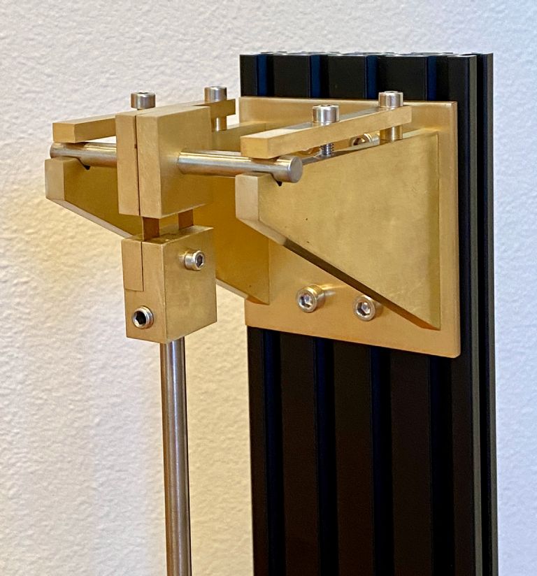

                          See SK at 21/07 …14:46:50 above – Of course, the invar will extend slightly as the weight of the bob is added to it, but having extended, the mass will remain the same, and the centrifugal variation with a modest swing will be next to buggerall, so the extension should remain almost as nearly constant as gravity.
                          And – later, different topic: The traditional arrangement of compensation suggested here is to use the invar (eg) from the pivot through the bobweight, then brass tube (eg) up again. This makes the pendulum longer. It seems possible to avoid over-length by having the brass tube upwards from the pivot, the Invar down from there. With this design, the extra length could be hidden by the horse, cuckoo nest, or whatever ornament is added above the dial. And in some clocks could rock a boat. Why not?

                            Tim: I like the idea of putting the compensator at the hinge, though it would probably complicate the hinge itself. But my main problem is that I have only found a reasonable source for Invar at 36" lengths. I did contact a few other dealers in the U.S. (purported, I think they really only drop-ship from somewhere else), but they both asked for about $500 for a longer length. So, if my total length is constrained, it doesn't matter much where the compensator is, and the bottom is easier. Maybe for next time! Thanks!
