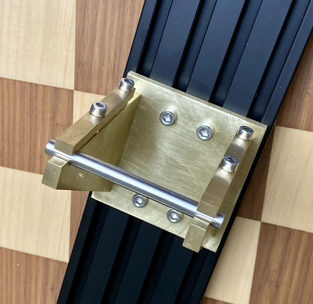

                More progress:
                I've finished the pendulum's bracket. It's designed to fit 8020 aluminum profile (80x20mm), and the bolt positions were spaced accordingly, with the two supports being 60mm apart. The throat is about 3.25" to the V.
                The top of the bracket is intended to allow a flat-placed pendulum cross-rod, with or without the clamp. Of course the V can also be used with or without the clamp. Flatter is better, but the clamp is currently set with a very slight down-angle, capturing the 1/4" cross-rod (better than ejecting it). Taller, well-tuned clamp supports would be needed to clamp a "flat" cross-rod.
                Here it is bolted to an 8020 aluminum profile, with a weird perspective lying down on the chessboard. M3 bolt heads are small enough to slip into 2020 T-channels, allowing bolting things from the back. M5 bolts are used with T-nuts to clamp the bracket to the profile.
                I chose 8020 profile because it should allow mounting sensors and coils wherever I please, with easy adjustment. With this bracket, a 3" diameter bob will have nearly 2" clear spacing to the profile.
                I'm pleased with how it came out. 🙂

                Joseph Noci 1
                  @josephnoci1
                  Well made SK…
                  There are always a few haunting thoughts when playing around with this stuff. Pendulums are an easy subject till you start reading, and the more tomes read, the less easy it becomes…Of course it's only hard if you are chasing that deep trough on the ADEV plot, but why else would we be making such complex structures for a simple pendulum?
                  So, in that vein of the extreme..
                  A 3 inch Bob swinging 2 inches from the rear structure will suffer some aerodynamic effects – esp a round bob – a rugby ball bob a little less, but the displaced air has to go somewhere, and it has nowhere to go between the bob and support. This has been evaluated in the literature with bob's in a clock case, etc..
                  Not sure what your bob weighs, but I suspect there will be some flexing of that vertical support, or rather a twisting, and even if only a few 100'ths, its enough to wreck the ADEV…Symmetry of support and structure is your friend in this, with diagonal struts and/or bracing a good aid.
                  Your have not indicated how the 8020 profile will 'mount' – if bolted well to a good wall, then flexing should be eliminated.
                  John commented on my cross support with the V's – – there is also good coverage on the concept in Matthys –
                  The friction between the rod and V is an issue and recommendations are a V of about 120deg angle , with the rod or pins riding the V being 3 or 4 mm diameter, hard and polished – also that the V should be of steel, polished if possible, but certainly very smooth, no machining or sanding marks. All in an attempt the get the pendulum hanging truly vertically. I have a 4mm polished pin and and mild steel polished V's and to the best I can measure, about 0.04 to 0.1 mm hysteresis when the pendulum bob is gently swung front'back and comes to a halt. I think 0.1mm is not great and will probably affect my ADEV in the end.
                  I will most likely get rid of the V block, and replace with flats and a spring blade pressure clamp, increasing pressure once the pendulum has swung for a while and 'stabilised' .
                  A +-1deg swing front to back should also dampen to a halt within 10 min or so, so knife edge supports in the forward plane are a no-no.smiley

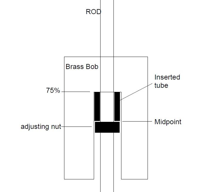

                          The cylindrical bob, stood on a table would expand upwards from the table when heated. If the bob is suspended in its middle, the CG, assuming a solid cylinder, then it would expand evenly up and down from that point, ie, expansion will be above and below the suspension point.
                          So if you attached the brass bob to the invar rod, only at the middle of the bob, bob expansion would have 'no' effect of the pendulum rate. Since the invar rod also has a coefficient, moving the bob suspension point up or down from the midpoint of the bob can compensate for that.
                          Placing that suspension point around 75% upwards in the bob allows you to insert a tube between the bob midpoint, and the bob suspension point. If you inserted a brass tube 25% the length of the bob, it would bring the bob suspension point to its midpoint, and being brass, the bob would then expand evenly up and down again. This allows you to play with the expansions amounts up and down. The inserted tube can be of materials that grow or shrink with tem, giving more freedom to compensate for expansion in the total system.
                          Something like this: ( the adjusting nut is just for completeness – not a practical implementation)

                              I'm sorry, but there's some fundamental difference in strategies that I'm not following, at least per my understanding of your proposal.
                              You are placing the adjusting nut at the center of the bob, and the bob's rest location above that (i.e., 75% from the bottom of the bob). I feel this is wrong. In fact, if your bob and your compensating tube is made of the same material (e.g. both 360 brass, as I am proposing), then your scheme will not address the temperature coefficient of the rod at all! It will just leave the bob with its center at the rating nut regardless of the temperature. If it's not the same material, you are just complicating matters, since by supporting the bob at other than its mid-point, you have to consider its TC as well as the TC of the compensating tube.
                              What I'm proposing: First, keeping in mind that I am making an arbitrary-length, arbitrary-period pendulum: I don't need a rating nut, but merely a support (e.g. a pin), and there's no point in leaving unused rod below that. Hence, in my case, that support can and likely would be merely at its bottom.
                              Next, I think we can agree that, if we had a perfect rod, then the ideal place to rest a non-zero TC bob is at its center point (50% from the bottom). That way, the bob's own expansion or contraction is a wash, as then the position of its center of mass along the rod would not change.
                              Now, having nullified the bob's TC (by supporting it at its center), we want to compensate for the rod's non-zero TC. I compute that a 2.05" long compensating tube is needed. This would nominally support the bob at its center, and for my 3" tall bob, it would extend 0.505" below the bottom of the bob.
                              But if that compensating tube is the same material as the bob itself (as I propose), then supporting it at its center is redundant, since the 1.5" of the compensating tube within the bob would expand or contract exactly as much as the lower 1.5" of the bob itself. Therefore, I can just support the bob – from its bottom – with a shorter 0.505" tube of the same material.
                              Does this make sense?
                              Edit: I think this also means that, for a 35" long Invar rod, a 360 brass bob that is 2 x 2.05" tall, supported from the bottom, would not need any special compensation – the bob would move its CG up and down by the appropriate amount on its own. And also that my 3" bob would be appropriately sized for an Invar rod that's ~35/2.05*1.5=25.6".
                              Also, the math is just a bit more complicated, as the rod has its own CG and, as it changes length, its CG will shift too. So the net CG of the pendulum would still change slightly with temperature unless one works harder at it.
                              Edited By S K on 25/08/2023 19:41:56

                                Posted by S K on 25/08/2023 19:10:56:
                                Not what I said at all –
                                If you inserted a brass tube 25% the length of the bob, it would bring the bob suspension point to its midpoint, and being brass, the bob would then expand evenly up and down again. This allows you to play with the expansions amounts up and down. The inserted tube can be of materials that grow or shrink with temp, giving more freedom to compensate for expansion in the total system.
                                Brass brings you back to net zero, using other materials, steel, quartz, carbon fibre, aluminium, etc allows further compensation which is difficult to apply if the bob is suspended at midpoint and it is much easier to change a compensation tube than moving the bored hole at midpoint…
                                But, many ways to skin a cat…I like to follow sound concepts proposed by those skilled in the art, rather than inventing new ways to make the pendulum behave obtusely…
