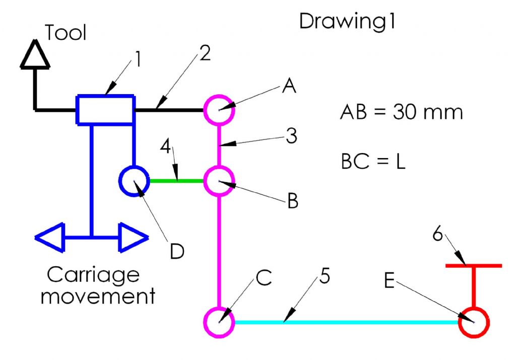

                            I've published a "universal threading attachment" almost completely contained on a toolholder, based on Thales theorema, point E being fixed and BC being adjustable:
                            #121705
                            jacques maurel
                              @jacquesmaurel42310
                              This was in ME issue 4270 (march april 2006) general view:

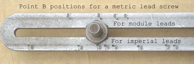

                                There are numbers stamped on the lever and charts are given so it's easy to cut any lead. On the photo (metric lead screw) one side of the groove is graduated for imperial leads, the other for module leads (for cutting single start worms). No change gear is needed, all cutting is from the standard gear box but the thread must be short (50 mm) read the article for details.

                                    The calculation is BC = 30/(p'/p-1) mm, p' being the lead to obtain and p the standard one.
                                    Ex for p' = 20 TPI (1.27mm) and p = 1mm, BC = 111 mm (position 2).
                                    The charts and graduations are here to help when setting the lathe for standard leads (imperial and module for a metric lead screw, metric and diametral pitch of an imperial one).
                                    Almost any lead can be obtained within the range of the lathe gear box.
                                    My attachment is quickly set up (contained on a toolhoder). Because for me the time for removing and resetting the top slide, is the same as the time for setting and resetting the banjo arm.
                                    Ex : chart for machining module leads from a metric lead screw:

                                            Just a few simple thoughts :
                                            ? Increasing geometric error as linkage goes away from the all square condition .
                                            ? Correcting link , correcting slide or correcting cam .
                                            ? Analysis same as for pantograph and parallel motion mechanisms .
                                            MikeW

                                                The purpose of this attachment is not to correct the lead but to use the standard gear boc leads for machining any odd lead, so no change gear is needed (only the standard gear box is used).
                                                Of course there is some geometric error as the linkage goes away, but for about 50mm long (short thread) this is negligeable (less than the lead screw error).

                                                  MICHAEL WILLIAMS
                                                    @michaelwilliams41215
                                                    Hi Jaques and Neil ,
                                                    With representative proportions of device as in drawing positional error of tool is of order 0,4 mm when top of combining lever is offset 25 mm .
                                                    Whether this level of error matters depends on the kind of work that is being done and the fineness of thread being cut .
                                                    Regards ,
                                                    MikeW
