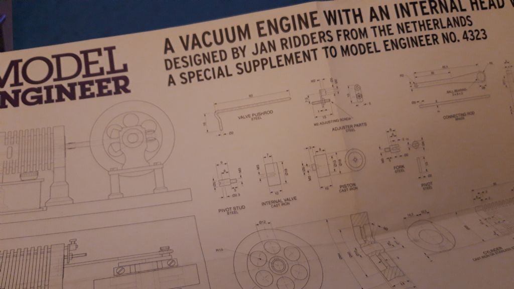

      While having a tidy up today I came across an old Model Engineer plan for a vacuum engine. Designed by Jan Ridders of the Netherlands. It was free in issue 4323.
      It looks relatively easy to machine, it's a nice small size and I've not made a vacuum engine before so I thought why not give it a go!
      Has anyone made this model?

          Yes I’ve built one of Jan Ridders Vacuum engines. I think it was that one? I simplified the design a bit to make the build easier. Many people build these engines and never get them to run, so be warned! I’ve had mine running only twice for about 10 minutes each time. If I was to build another I’d try his vertical “”Marc” model as I suspect that may run better? I’ll try and find a picture of mine.

                Ian if you get this made and it won't go on meths , then try a gas flame , I made a similar engine and turns out it will only run on gas but at least it runs, but hopefully yours will run on meths

                  I made two of these and got them both working , the problem I found is that it called for cast iron cylinder and piston. With the condensation caused in mine it stopped and when left rust deposits in the cylinder so would not work. I used a stainless steel liner and brass piston and worked for 10 seconds or so.

                    I admit to being a Jan Fan, but I doubt the trouble is with his plans. Jan's published many interesting engines, and some of them are difficult. For example, my first attempt at his Coffee-cup Stirling didn't work until I'd fixed all the tiny leaks and reduced friction at all points to the minimum. As built the engine didn't run, several hours later it did. Same design, same parts, but everything freed-up, flywheel balanced and the timing adjusted. Initially reluctant to start with run times in minutes, now it runs on an electric element for hours on end.
                    I noticed, in the failed state, that brass parts corroded, cause unknown, maybe heat, condensation and oil coupled with acid fumes from the sealant. The problem disappeared after the engine ran properly. Delicate engines may need repeated cleaning in the early stages: apart from debris due to machining and parts wearing in, if they're not working properly oil gums up, liquid collects etc etc.
                    Also a fan of Stewart Hart's Potty Mill engine. It's much less fussy and you can squirt high-pressure air into it. Provided the timing is right, and the parts turn freely, even a high-friction build will run. I found it a good balance of challenges. Made me think but none of it was too hard for this beginner.

                        Ordinary methylated spirits doesn’t seem to burn hot enough but I was lucky enough to get a small bottle of 99% industrial methylated spirits from work. Glass fibre wicks seem to work best as well.

                              Video of my effort here. Runs quite well on simple meths burner. Adjustment of flame position is a bit finicky:-

                                  Basically the wick needs to touch the flat part of the cylinder next to the slot. The flame needs to be quite large. I think I made mine from an early drawing, I believe Jan has revised the drawing a little and made the cylinder bore larger. Worth getting the latest version from his site.

                                      Interesting to see the position of the wick on Johns video, my plan had the wick straight up so a gap from wick to cylinder. I going to dig mine out of the shed in the morning and get it going. I remember I rubbed soft graphite pencil in the cylinder for lubrication.
