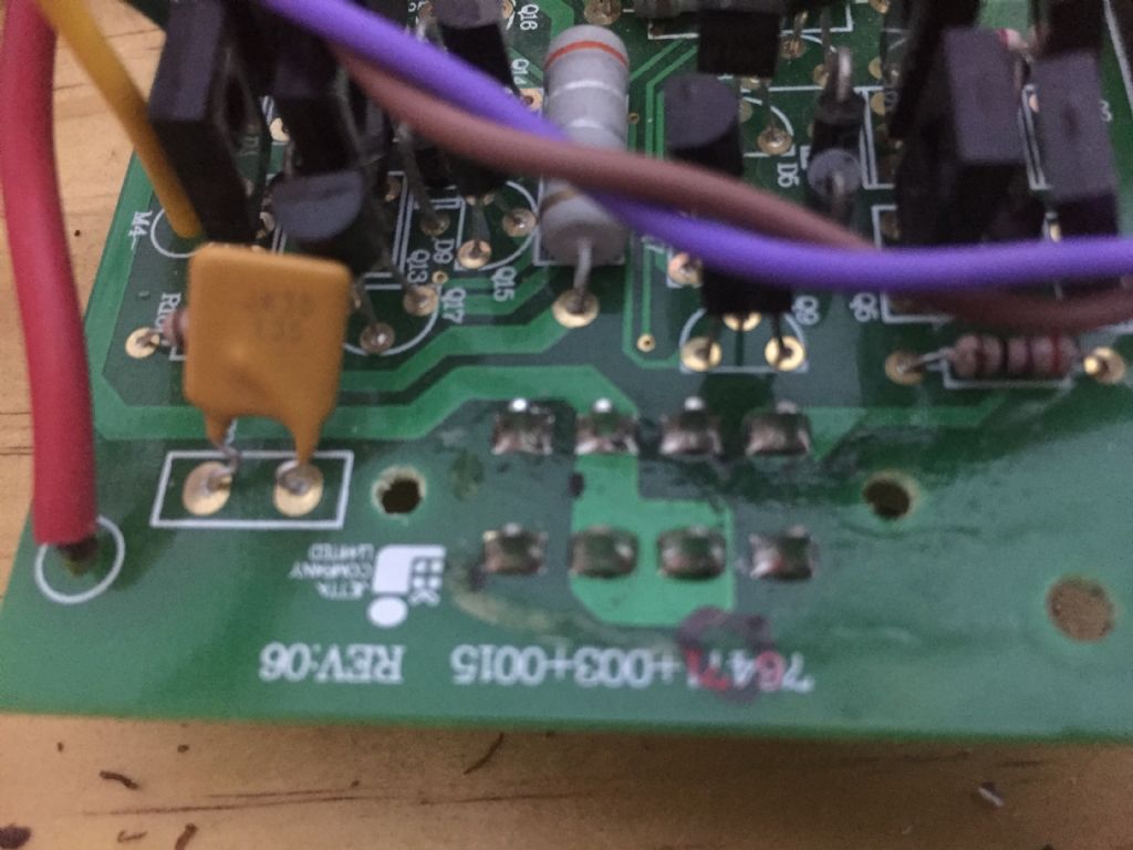

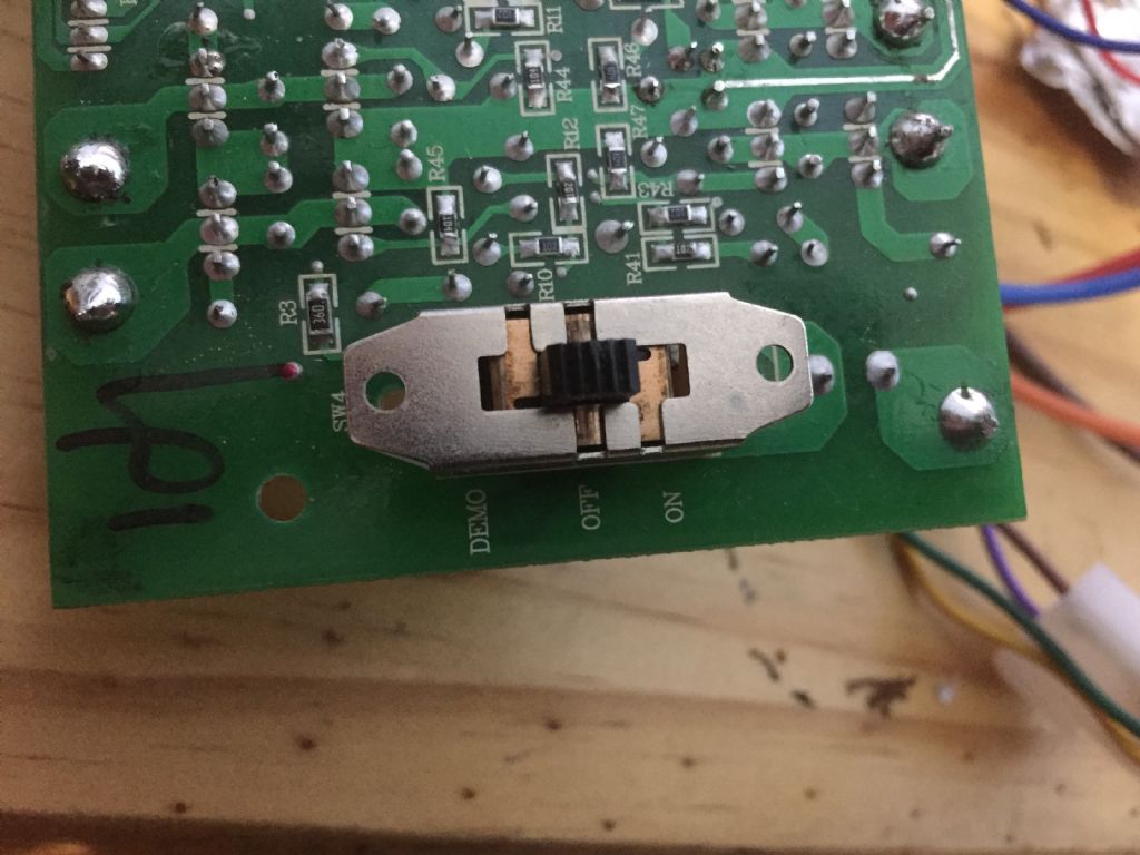

      A while back I took on a community project to repurpose a robotic toy for use by a 'performance artist'. I've got the mechanics sorted out, but I now realise that I need to move the toy's control switch from the 'brainboard' to a remote location. This is the switch from the top:
      and from the rear:
      My first question is: What are the odds on me removing the switch from the board using solder wick without knackering anything, given that I've zero experience with this technique?
      Second Q is whether I even need to remove the switch – perhaps if I left it in the 'off' position I could just take wires from appropriate pins on the back of the board and replicate the 'demo' and 'on' states with a new switch.
      Any advice would be welcome!

          Having undone many a component from many a PCB or hard-wired circuit…
          It won't be easy as solder-wick might not slurp it all up. A vacuum-type solder-sucker might be better.
          Try it, anyway; but I would advise using only as much heat as necessary, and letting the work cool down after each pin. There doesn't seem to be anything too sensitive to heat close to the switch, but you don't want to risk lifting the tracks off the board.
          If the switch is to be moved to a new location anyway, your second idea may well be effective. If you use that, secure the wires to the board close to the pins, making use of what seem to be two holes. Fit a blanking-plate to prevent accidental operating of the original switch. At least this approach would allow the circuit to be restored to original, if thought necessary in future.

            Hi Robin, one problem you have is the board has a printed circuit on both sides of the board and the switch may well have been soldered in on both sides as well, so it will be more difficult to de-solder by either of the two methods and the circuit may not allow you to add a remote switch with that one still in place as it it is a three position switch. You will have to check that the switch has a totally off position that doesn't restrict a remote switch to be added, otherwise you may have to cut the switch off mechanically or wrecking the case and removing the switching parts.
            Regards Nick.

              It may be easier to cut through the pins on the switch and get it out of the way be fore attempting to desolder the pins and then fitting a replacement remote switch – less metal to heat up and less chance of damaging the board.
              You will need to 'nibble' away at the pins with some fine nosed cutters – but the second side should be easier as you will be able to lift the switch slightly to get better access.

                A test needs to be made on one pin to check if the switch pin is a tight fit in the hole or the hole is through plated as removal is more difficult in these cases. One way to remove the solder is to heat the joint and then quickly tap the board on the bench which will make the fluid solder splash out. Start gently and preferably on a pin that has no tracking connection to save damaging the board.
                If the pins are a tight fit the technique I've found best is to flood the pins with more solder and extract the device while the solder is fluid rather like the reverse of flow soldering. However this requires a degree of preparation as it needs to be done quickly. The switch body needs to be held in a vice and/or levering devices put in place to prise the board off the switch. Since in your case there are two rows of pins the soldering iron will need to be moved quickly down each row alternately until the solder around each pin is fluid and before starting extraction. The process may need to be done in stages as the board/switch may not come out symmetrically.
                Best to use a good quality temperature controlled iron at around 300C to ensure solder become fluid but not too high a temperature to scorch the board.

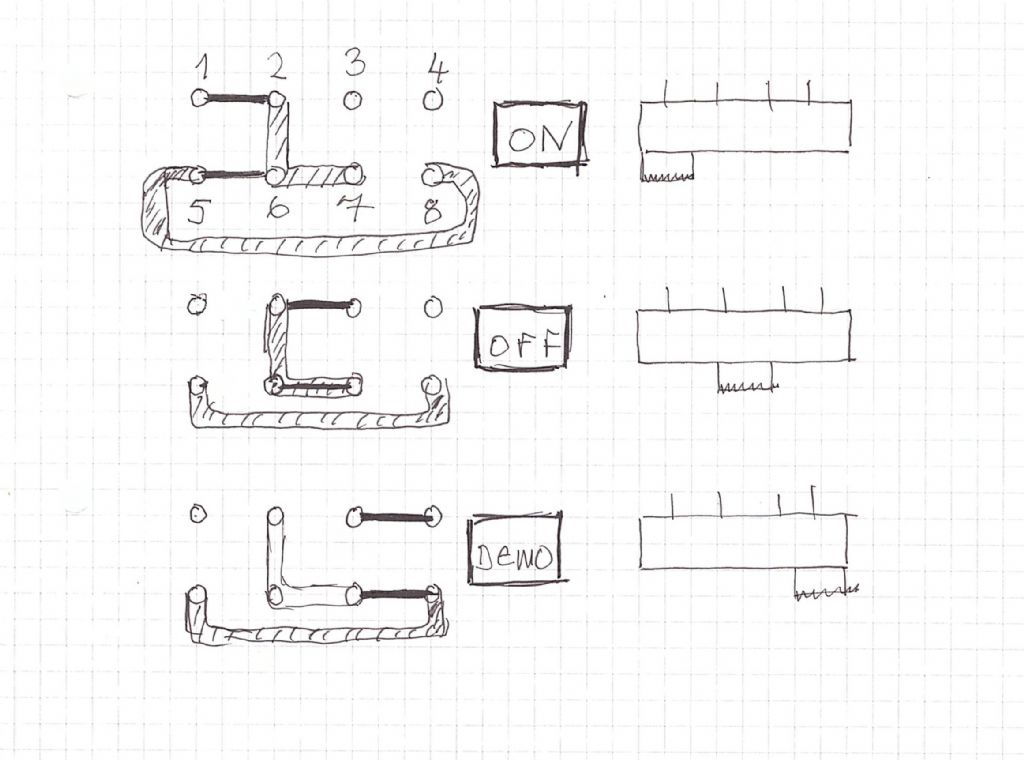

                                I took a multimeter to the switch and found:
                                The hatched things are pcb tracks – I can see the L – shaped track connecting 2,6,7 on the component side and infer the existence of one between pins 5 and 8 because they are connected at all switch positions. Presumably on the other side, obscured by the switch body. I have also inferred the switch connection between 6 and 7 in the 'off' position – symmetry seems to demand it!
                                The problem with leaving the existing switch in the 'off' position and wiring up another one seems to be that pins 2 and 3 will remain connected in 'on and 'demo' modes. Maybe that wouldn't matter but I can't be sure.
                                I'll have a go with the wick, but if it doesn't look like it'll work I'll resort to Nick's suggestion of destroying the switch – drastic as it seems it might actually be the least risky option.
                                If anyone's interested the board came from a (now obsolete) Hasbro FurReal toy pony. You can see it here. They cost over 1000 USD when launched I'm told!
                                Robin

                                    Hi Robin, your sketch is good and it can be seen in your photo that there is a track connected to pin four on the component side, which suggests that there's a possible track on pin three under the switch connected to something else. This is the trouble with things like this, they can hide tracks and connections under them.
                                    Regards Nick.

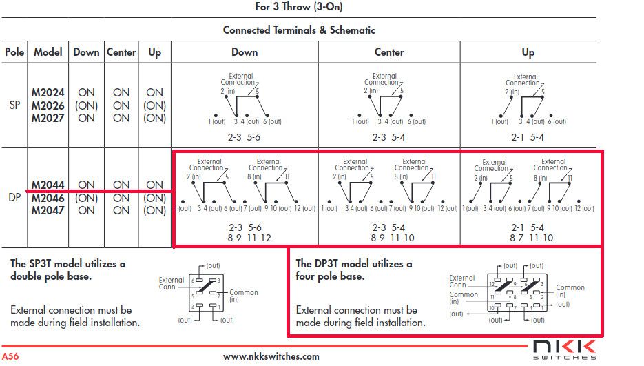

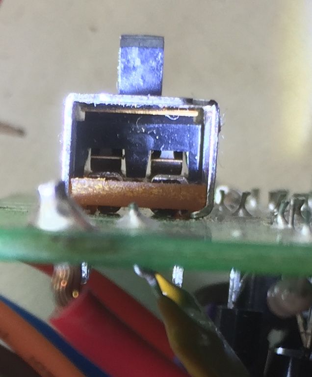

                                          -Thanks for further advice. Looking more closely at the switch:
                                          it seems likely that if I bend the sides outwards the whole thing will fall apart and reveal pads onto which I can solder.
                                          I'm having trouble finding a replacement though – searching on DPCO as suggested by Mike brings up switches with two rows of three pins rather than the type I need (see earlier sketch). Does anyone know what the configuration I want is called?
                                          Robin.

                                            DPCO ON OFF ON
                                            basically.
                                            regards Martin
                                            **LINK**
                                            #597582
                                            Martin Kyte
                                              @martinkyte99762
                                              I do beg your pardon. You probably want DP3T
                                              regards Martin
                                              #597587
                                              Emgee
                                                @emgee
                                                Posted by Martin Kyte on 09/05/2022 14:00:20:
                                                regards Martin
                                                Like this one.
                                                **LINK**
                                                Emgee
                                                #597588
                                                Nicholas Farr
                                                  @nicholasfarr14254
                                                  Hi Robin, try these Digi-Key #DP3T
                                                  Regards Nick.
                                                  #597591
                                                  Robin Graham
                                                    @robingraham42208
                                                    Thanks all, DP3T On-On-On it is. Now I know that I can go ahead with this.
                                                    Robin
