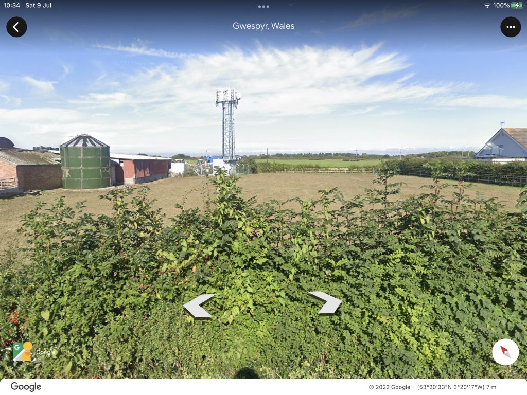

      I have a particular interest in this 4G cellphone tower
      **LINK**
      https://earth.app.goo.gl/RhxwpW
      #googleearth
      … I want a reasonable estimate of the height, above ground, of the antennae
      Physical access is limited, but I could do some trig from the pavement.
      Before going there with the Disto [or whatever] … I would welcome any clever suggestions from the forum.
      ”Cheating” is permitted … so if you happen to have access to the design drawings, please just tell me the dimensions.
      I suspect that we could do a passable job by scaling from the ‘Street View’ images.
      Over to you, if anyone fancies a try.

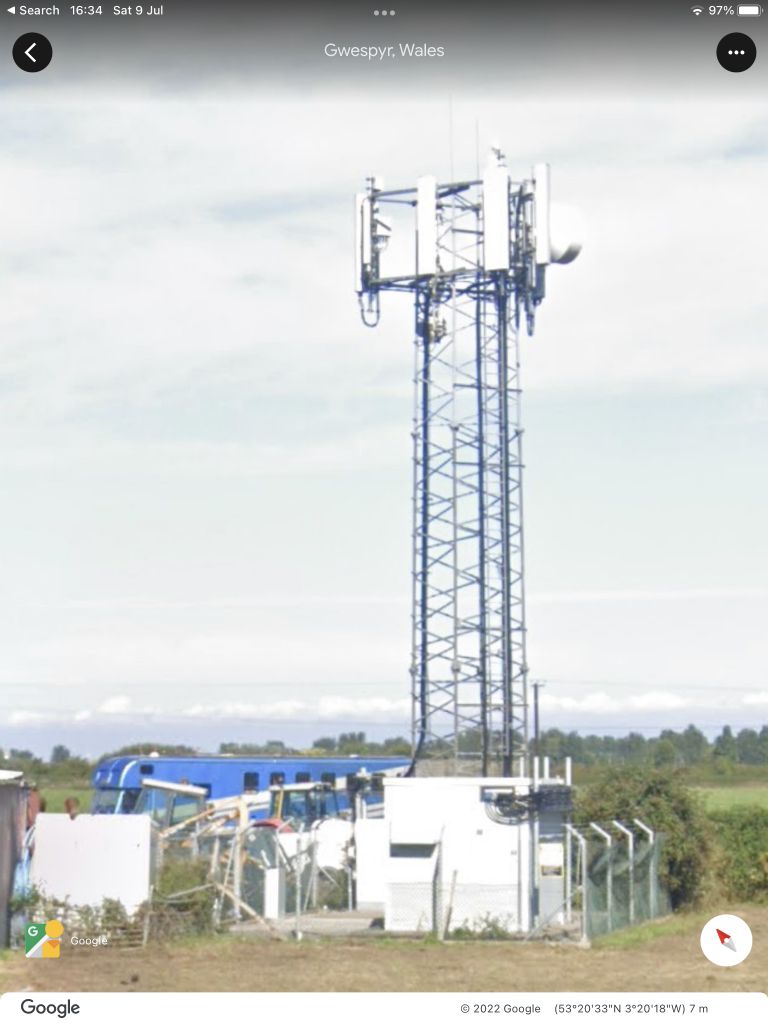

          I would say the antennae height is approx 4 to 4.5b times the height of the blue vehicle or 5 times the eaves height of the building between the silo and the mast.
          Only a rough guess of course

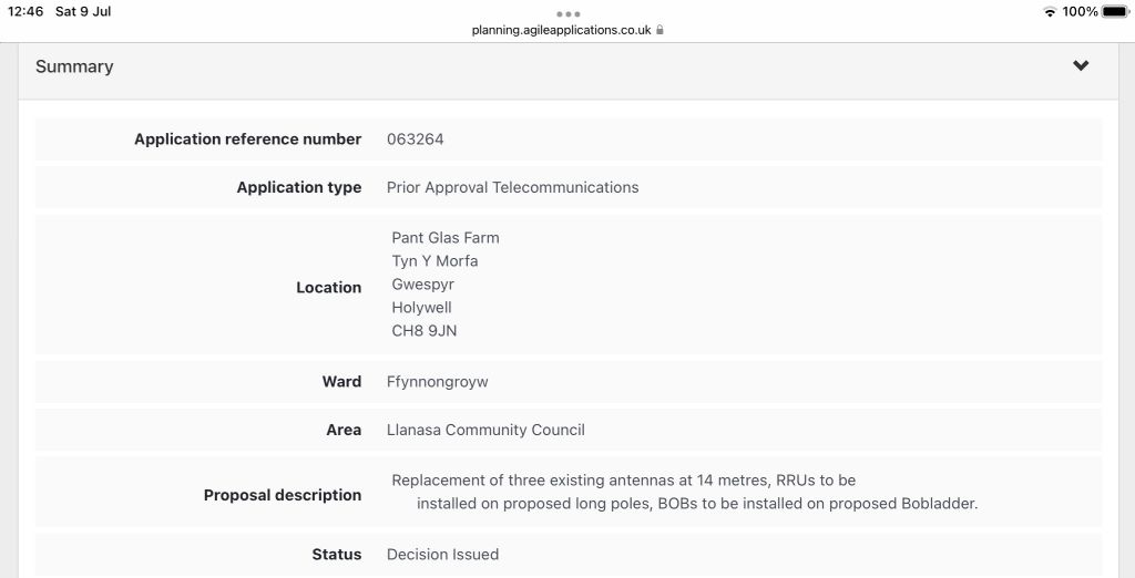

          Emgee
            @emgee
            Check with the Local Planning authority, the application for planning permission will include the mast height.

            #605056
            peak4
              @peak4
              Using Google earth & streetview only, both of which might show height distortion, I'd say 12m to the top of the mast roughly.
              3G aerials are about 1.5m long, I've thrown away my BT Radio Training notes now.
              The base station cabin is about the same height as a shipping container 2.6m
              Blowing the two pictures up on screen, using a ruler, and doing the calculations four times, all come up with about 12m

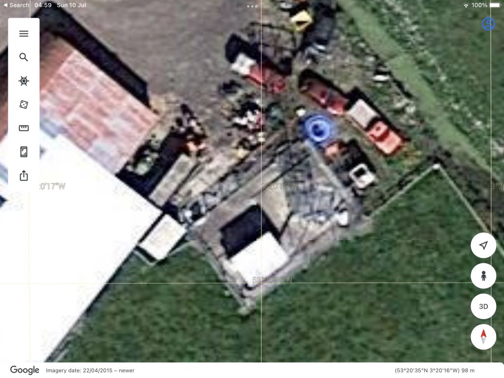

                  peak4
                    @peak4
                    Posted by DiogenesII on 09/07/2022 11:27:46:
                    Go there with a stick of known height, measure the shadow of the mast, and then measure the shadow of your stick…
                    Or if it is in the same 'plane of distance' as the fence, say, measure the height on the picture with a ruler, then mark off that same distance horizontally along the fence and go out and measure that..
                    I haven't got time now, but using Google Maps Satellite imagery, you can measure distance.
                    Street lights are likely to be a set height, as are other things like telephone poles, which can be estimated from StreetView.
                    Then compare that with the overhead view and measure the shadow lengths.
                    The mast comes out about 15.5m shadow
                    I'm sure an astronomer could use the date and shadow angle from North to work out the time, and thus the sun's inclination above the horizon.

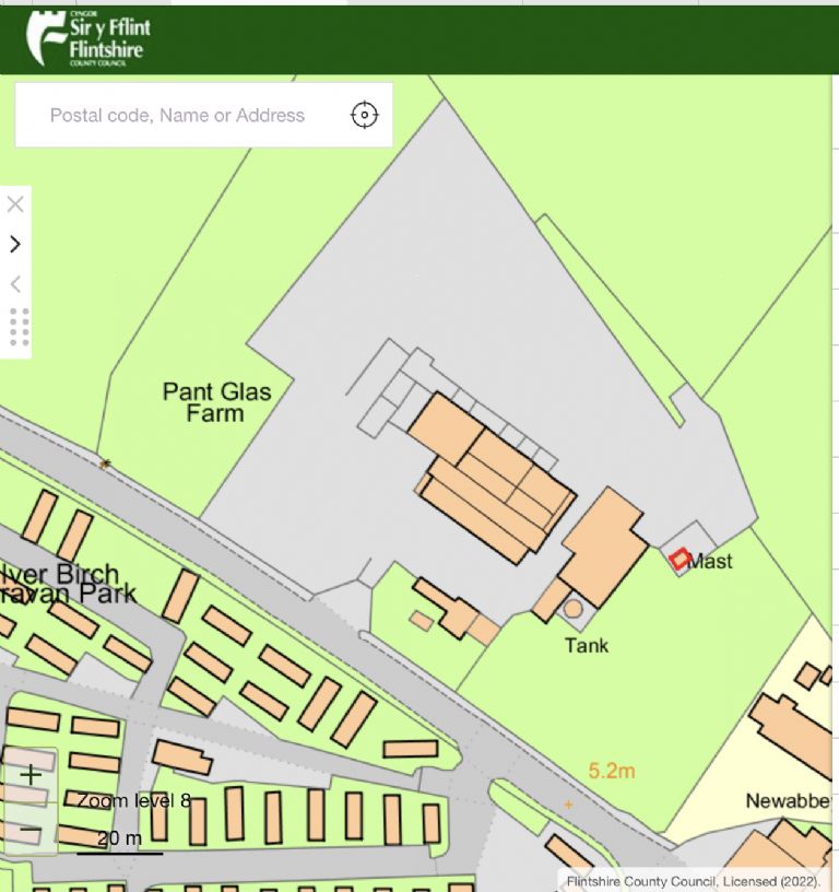

                    #605084
                      Posted by Emgee on 09/07/2022 11:00:51:
                      Emgee
                      Thank you blush
                      Why didn’t I think of doing that before asking here ?
                      [ please resist the temptation to answer ]
                      Sadly there are no drawings accessible, but the summary is near enough and I’ve learned some new jargon.

                                  #605113
                                    Posted by V8Eng on 09/07/2022 14:40:35:
                                    Bit too far away for an iPad to measure I think.
                                    Don’t ya just love the effect modern technology is having on landscapes!!!
                                    Not quite sure I get your point, V8
                                    This is a screen-grab from the zoomed-in ‘Street View’
                                    [ click the image for a bigger version ]
                                    Once calibrated, you could probably build a credible scale model from that.
                                    Edited By Michael Gilligan on 09/07/2022 16:48:35
                                    #605119
                                      Just home from a family jolly, without reading any of the answers, I used the fence posts (2.4m), as per Journeyman, and got a low estimate of 13m and a high estimate of 16m. The average is 14.5m, pleasingly close to the planning application.
                                      If the length of a tall object's shadow can be measured, the height is directly proportional to the length of a shadow thrown by a pole of known length at the same time. Provided the shadows are clear, the method is accurate and doesn't need trigonometry or measuring angles. A traditional Abney Level or Theodolite both work in poor weather but involve sums. If the object is a known distance from the observer positioned with a large-scale ordinance map, the stadia calculation could be rearranged to give a reasonable answer. Significantly better by laying out an accurate baseline with a surveyors chain, measuring the angle to the top, and doing the trig. The baseline must either be levelled or have the slope compensated for in the maths.
                                      'Last of the Summer Wine' methods: Michael and I will fly a quadcopter fitted with GPS around the tower, fall in a cow-pat, and be chased through nettles by dogs and an angry farmer. Or we will climb the tower with a plumb line, only to discover it's not quite long enough. Then we'll go viral on the web after being filmed wetting ourselves due to having to wait beyond bladder endurance for an air-sea rescue helicopter. Michael will get the measurements right and I will cock-up the maths.

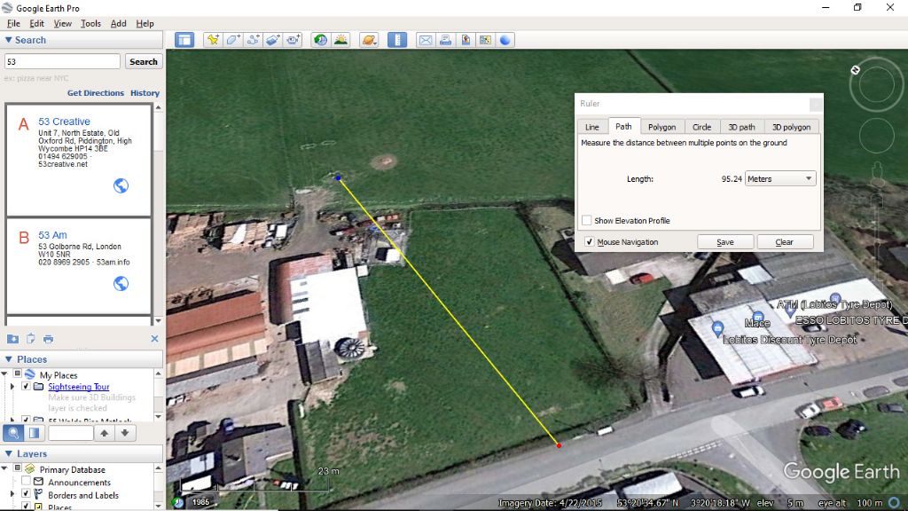

                                                David Caunt
                                                  @davidcaunt67674
                                                  Using Goggle Earth for distance it shows 95.24 metresdistance to 4g mast.jpg
                                                  #605187
                                                    Nice try, David … but unfortunately you overshot the tower !
                                                    I made the same mistake when I first looked at it on Google Earth.
                                                    … I have found a whole new level of respect for the people who analysed aerial reconnaissance.
