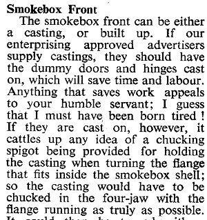

                      Hi Noel, there are drawings of the smokebox of Titfield Thunderbolt in both 3-1/2" & 5" in issue 2762 Vol. 110 April 29th 1954 of Model Engineer. It can be a casting or built up, to which is outlined in the text. The frames were also said to be castings or built up.
