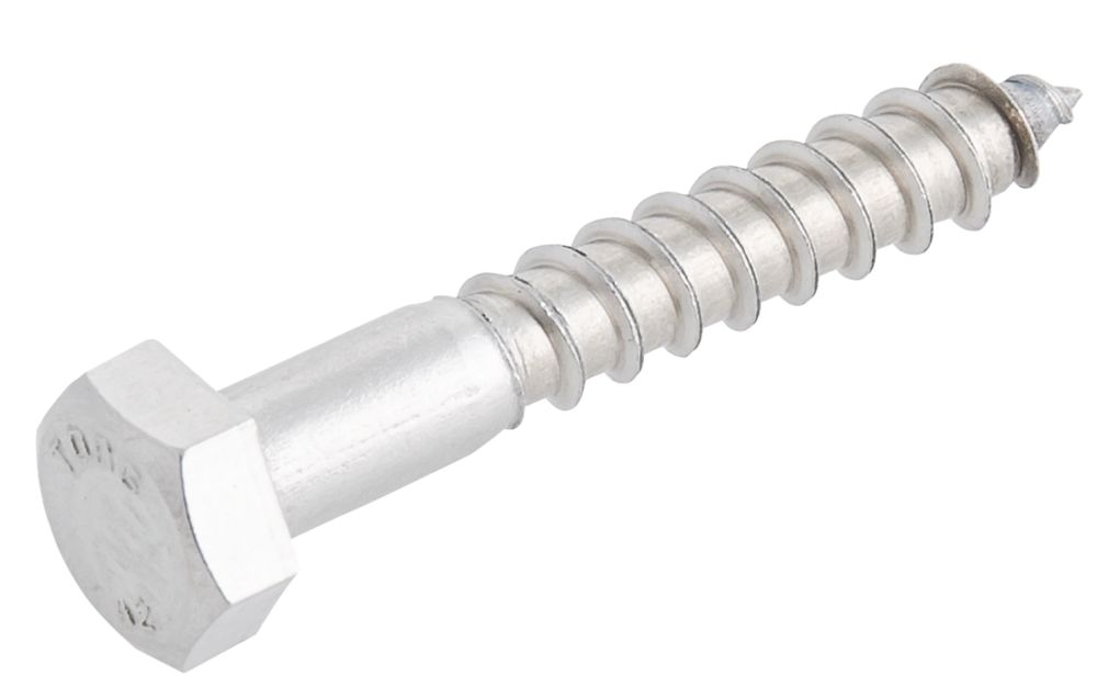

                                    In case anyone is wondering what the fuss is about, if loaded in shear a bolt with a plain shank has a much better abutment against a round hole, and has a significantly higher shear load capacity. This implies that the plain bit should be just less in length than the thickness of the 2 bits that it is going through
                                    #560040
                                      You may also run into problems if you order a coach screw using Noel's definition of a bolt/screw as this is a coach bolt
                                      And this is a coach screw
                                      Edited By JasonB on 27/08/2021 14:59:31

                                          Well, for a start, I differentiate between cap-screws and cap-head bolts. The bolts have a plain section of shank. Screws are made to be screwed all the way in and secure the part on the head – that can be a hex or round. Cap heads are particularly useful when counter-bored below the surface. Bolts are generally tightened with a nut, or threaded into a different member to that which is being secured by the bolt.
                                          I specify dependent on the situation in which the fixings are to be used. There are often alternatives, but also some specific fixings (coach head bolts are one example that are never going to be screwed in!) for some applications.
                                          I don’t think I have ever seen a coach bolt/screw threaded completely to the head.
                                          In summary, all is not simple when specifying a fixing. There are always going to be exceptions to the basic ‘rules’. Some bolts even have square heads, after all.🙂

                                                Coachbolt – Dome headed bolt or setscrew with square under the head.
                                                Coach screw – Square or hexagon headed screw, with tapered coarse thread, to go into wood.
