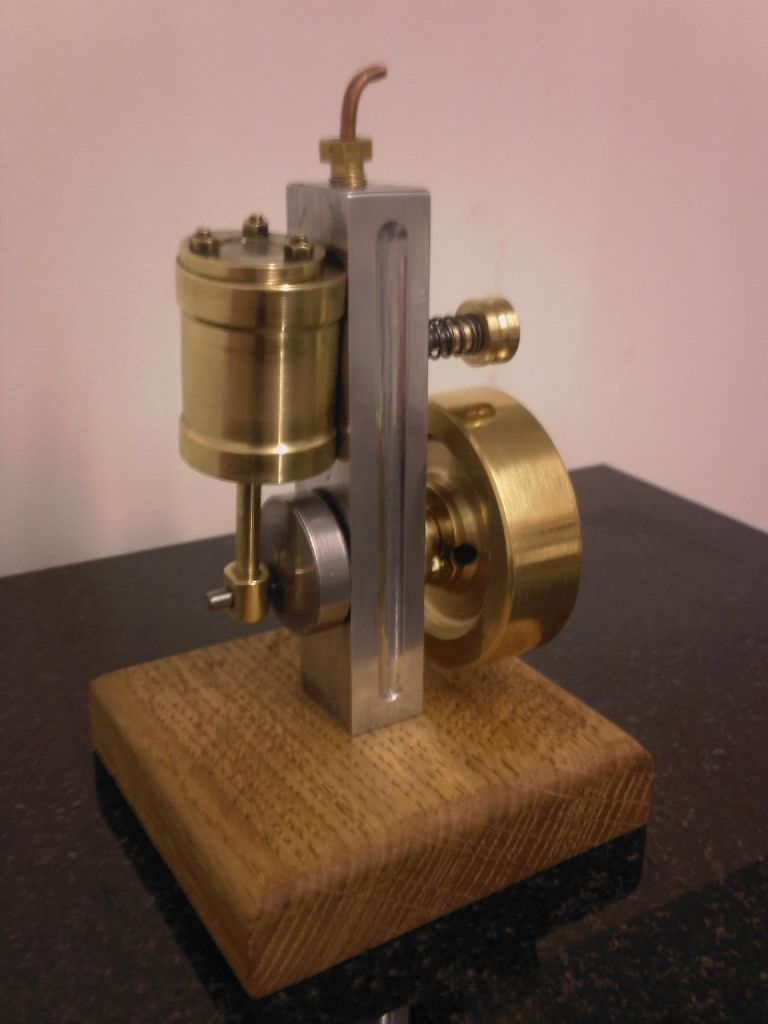

        Here’ mine 1st project
        Many Thanks to Steve’s Workshop
        Brilliant free design with great walk throughs for a first project

          Hi David,
          Looks excellent for a first project. I have only just joined forum (in fact this is my first post). I haven’t got a lathe yet but hope to get one soon (perhaps at upcoming sandown Exhibition) – This looks like an excellent first project for a newbie like me that has no prior machining skills. The webpage/ description etc. looks very informative & it’s all in Metric
          I see that you have made a few minor changes which improve the looks. Out of interest could you just make the cylinder out of a single piece of brass rather than two pieces – the cylinder top with the 3 nuts on looks a bit complicated & I am guessing unless you get it right will leak air like mad….?
          Anyway, if I can post a first project  that looks half as good as your engine I will be impressed..

                Got my lathe a few months ago and have not looked back since, wish I’d dived in along time ago (spent to much time thinking about what to buy)
                I’ve not done any machining for about 25years since my apprenticship. Been old school I went for an Imperial machine and have had no problems with the metric dimentions – I just use a metric micrometer!
                Top cover flange is no problem – paper gasket, 8BA screws / nuts
                just added some relief profile to the cylinder, flywheel and pillar just to give it that “real look”
                Want to have a go at a solid crank, just for the practice and wished I’d taken a few more pictures whilst making it – now I’ve discover this forum
                Don’t hesitate to ask any questions
                BTW I’ve called my 1st little engine after my daughter “Kate”  she’s chuffed to bits ! and so is the wife as I’ve told her my next engine will be called after her – a bit more complex just like her

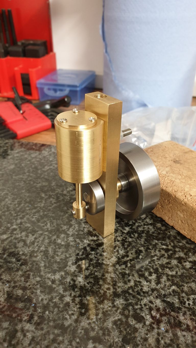

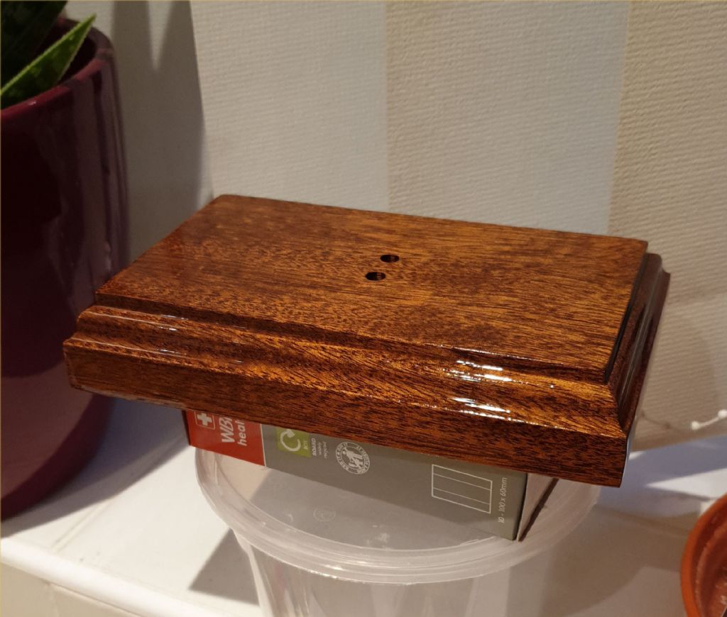

                                    I'm enjoying the build for sure, but also learning heaps. I got the piston OK, I think… there's compression and vacuum when it's dry, but a spot of oil should see it better. It's not a tight fit in the bore… but we'll see. Managed to edge a piece of Sapele yesterday with a router bit in the mill – and that had a coat of varnish yesterday.
                                    I did struggle with the flywheel though. No probs hacking it down to the required outer dimension, but I wanted to put some relief in the faces… I am learning still very much. I'm booked on the Axminster small engineering course next week… I have my list of questions! I managed to do it eventually, but it wasn't a pretty process by any means. I'll see if I can get a picture tonight of what I've done, but I really struggled getting past the relief angle on the tooling. Ended up using a indexable boring bar, which really doesn't take finishing cuts well and was resonating – although I did try various speeds??

                                      img-20190816-wa0008.jpegGetting there. Drilled the cylinder cap and threaded the cylinder this evening. Need to drill the bearing next. Base is made too, and 3 coats of varnish. Bit overkill really, but all good fun, and teaching me loads.

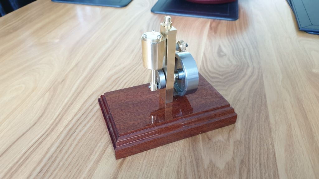

                                        Well…short of a bit more polishing…a gasket…and a spring instead of a bit of silicon hose…. it's done First project complete.
