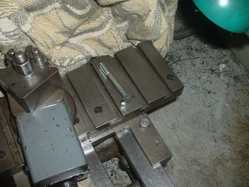

            Many thanks John. My idea for the table was to cast the base of the table in one with the cross traverse carrier and cast in the recesses for the ‘T’ nut slots. I was also going to cast in rows of threaded inserts (which would be tack welded to the Re-bar armature. The strips which form the table top ‘T’ slots would be ‘screwed and glued’ to act as a work surface. I do not actually use ‘T’ nuts I use a modified bolt. I standardise on 8mm for the Myford and 10mm for the mill although I often use 8mm on the mill as well.
            Most of the armature will be in 6mm re-bar tacked together. I will also have to build a jig to hold at least 3 datum inserts in a fixed position to each other to act as reference points.

                  Re: T nuts, as you do I sometimes use a bolt instead of a T nut. However whenever I do I am very wary of the point load it places on the edges of the T slot. A T nut distributes the load along the slot for some distance, there is a lot less risk of breaking the cast iron slot, as often seen on secondhand machinery.
