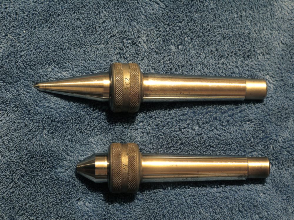

        Posted by Michael Gilligan on 05/03/2018 09:57:59:
        Posted by ega on 05/03/2018 09:41:54:
        Gepy (Swiss) – good but expensive.
        +1
        … actually, make that +2
        Male and female versions are both superb.
        **LINK**
        **LINK**
        Edited By Michael Gilligan on 05/03/2018 09:59:47
        Make that a +3. Didn't GHT himself write something along the lines that a "rotating center is an essential accessory for everyone that can afford it.". I would add to that by suggesting the word quality should be at the front.
        I had a second hand Rohm center and after using it on a good lathe I noticed a visual striping in the finish. I then got lucky on a second hand female center gepy and the finish vanished. Later to banish a major milestone birthday blues I got a male center gepy and I have not regretted it. One thing to note the standard GEPY has quite a short stub on the end and does not eject on all tailstocks. They used to do a variant P/N that had a longer stub. I don't know if they still do. It is of course a simple matter to turn up a replacement as they simply screw in and out.

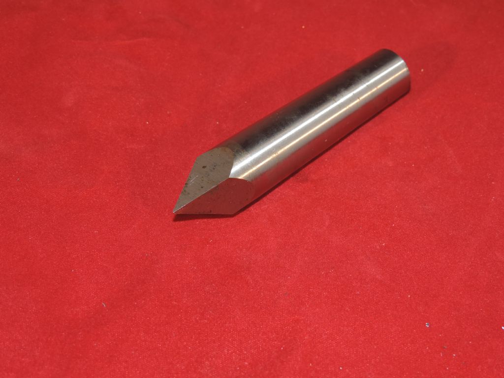

            I also have a square centre, which I'm sure someone will tell you is for optimal results when used in opposition to a four jaw chuck
            #344599
              Posted by Neil Wyatt on 05/03/2018 19:31:00:
              Only if it's a revolving one devil

                Skoda is my preferred live center…
                Ian P – I had the same problem. I turned up a button with a location pip on it then Loctited it in with some Loctite 601 if my memory serves me. It ejects without any problem. 👍
                Edited By Johnboy25 on 05/03/2018 20:31:18

                    Neil, works well I guess if you want to repair a damaged centre drilled hole.

                            Posted by Emgee on 06/03/2018 10:16:05:
                            Emgee
                            Goodell Pratt listed a square centre like that [in a small size]
                            It is, I believe, intended as a driver.

                                According to my 'Engineering Workshop Practice' of 1936 (1952 reprint):
                                Square centres D and half centres [this is one like a d-bit not with a small cone left on the end] are used for previously centre-drilled work [presumably with a normal drill]. They are not so efficient for this work as the "Slocomb"-type combination drill and countersink seen at F and consequently they are rapidly falling into disuse.
                                One potential use is making small centre drillings on models where a slocumb is not available in an ideal size or is considered too fragile/risky to use.
