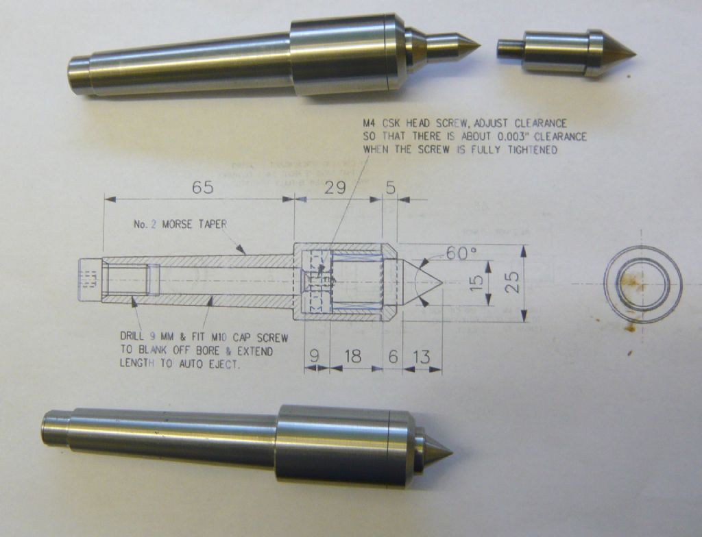

                                                    You could make your own centre
                                                    Alan
