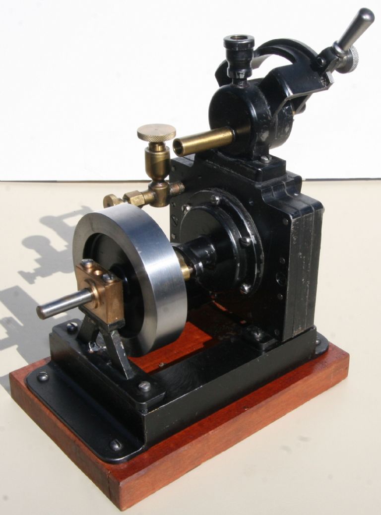

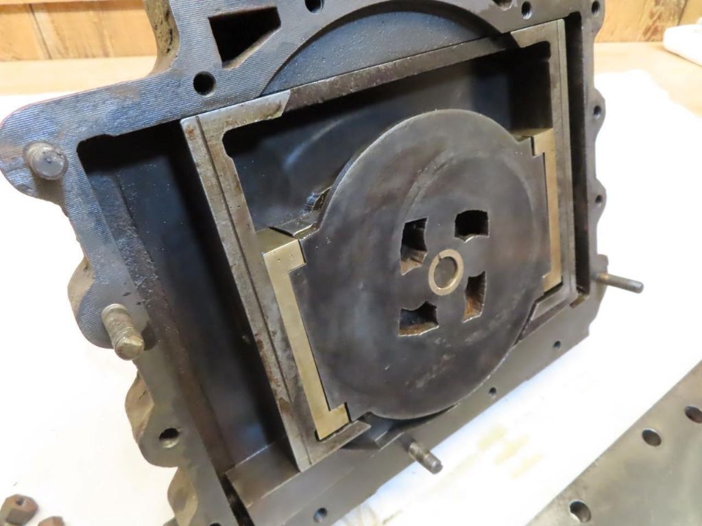

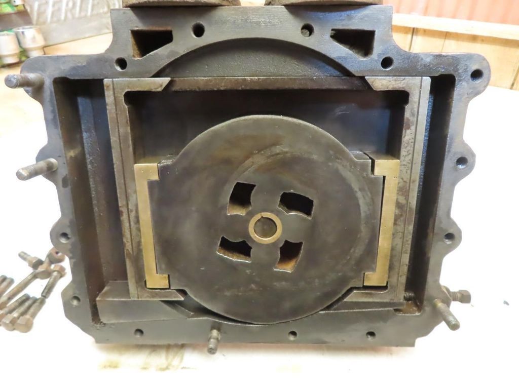

      My dad scratch-built a Dake many years ago, and it took me a long time to figure out how it worked.
      It is a twin-piston engine, with flat pistons like slices of toast, with one piece of toast riding inside the other hollowed-out piece of toast.
      Originally designed by Roots, and then 20 years later modified a bit by Dake and re-patented. Dake actually put the engine into production, and quite a few were manufactured.
      It was a very advanced engine for its time, and reverses almost instantly.
      Starts in any position.
      Used for hoists, steering engines, and other applications that can make good use of quick reversing and no dead centers.

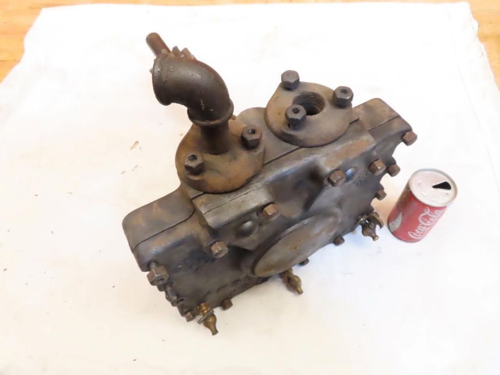

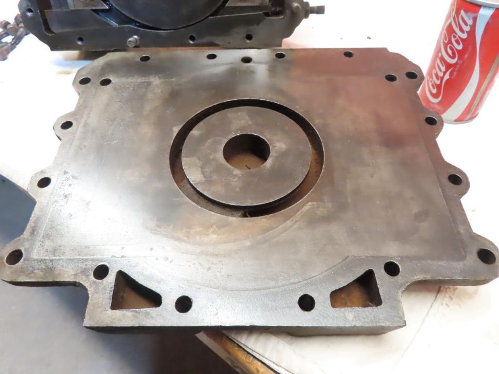

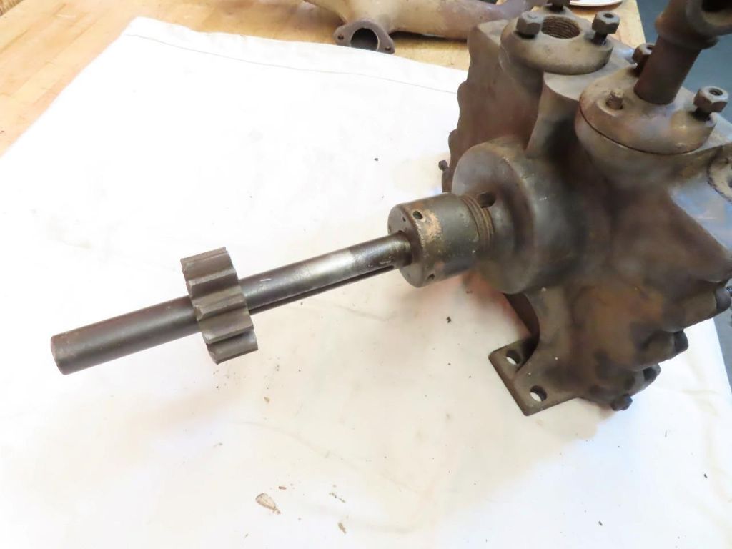

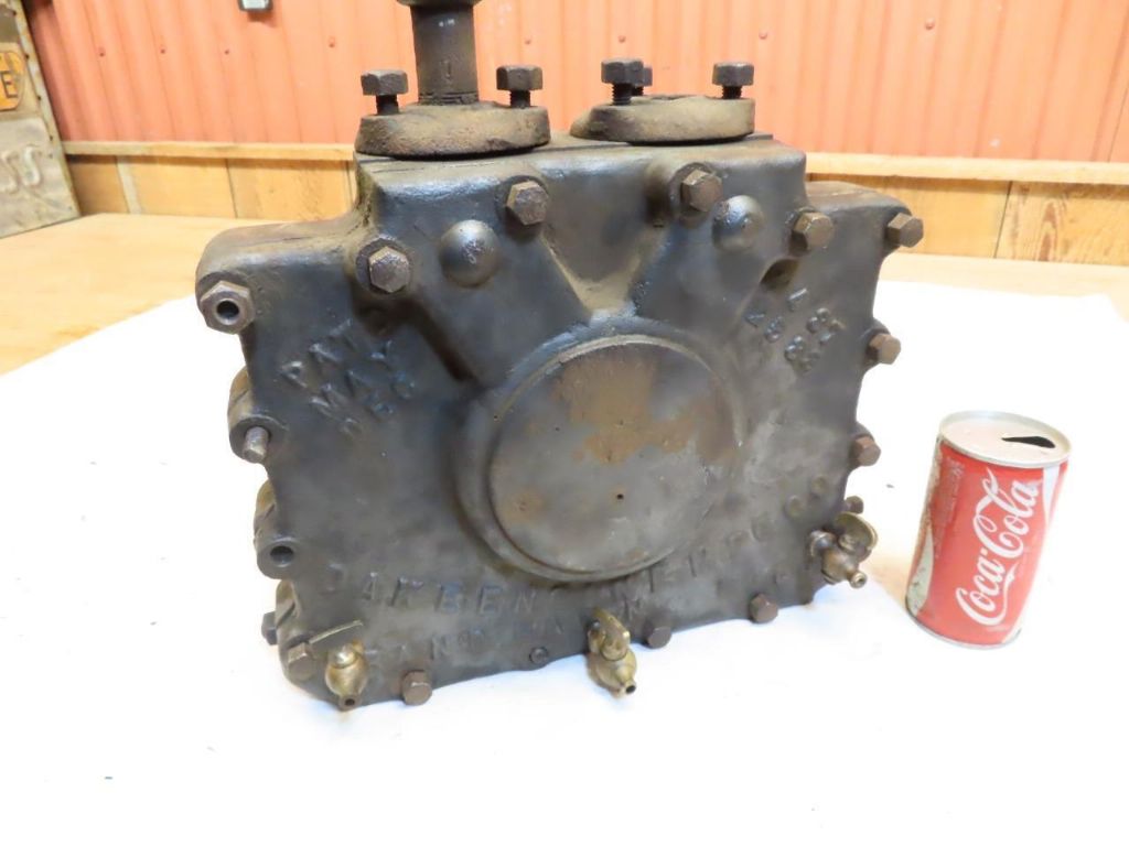

          So the other day I was surfing ebay, which I generally do every few months, and low and behold I ran across the only Dake I have ever seen for sale.
          Of course I had to grab it.
          Lets hope it survives shipping.
          This is one of the fluted crankcase styles, which seem to be rather rare.
          This one is set up for a remote reversing valve.
          Normally the reversing valve sits on top of the crankcase.

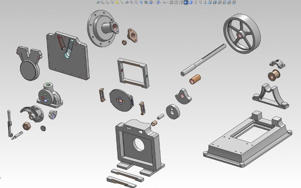

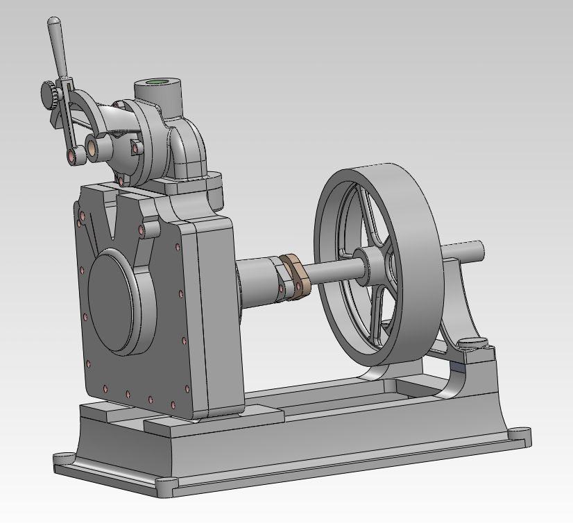

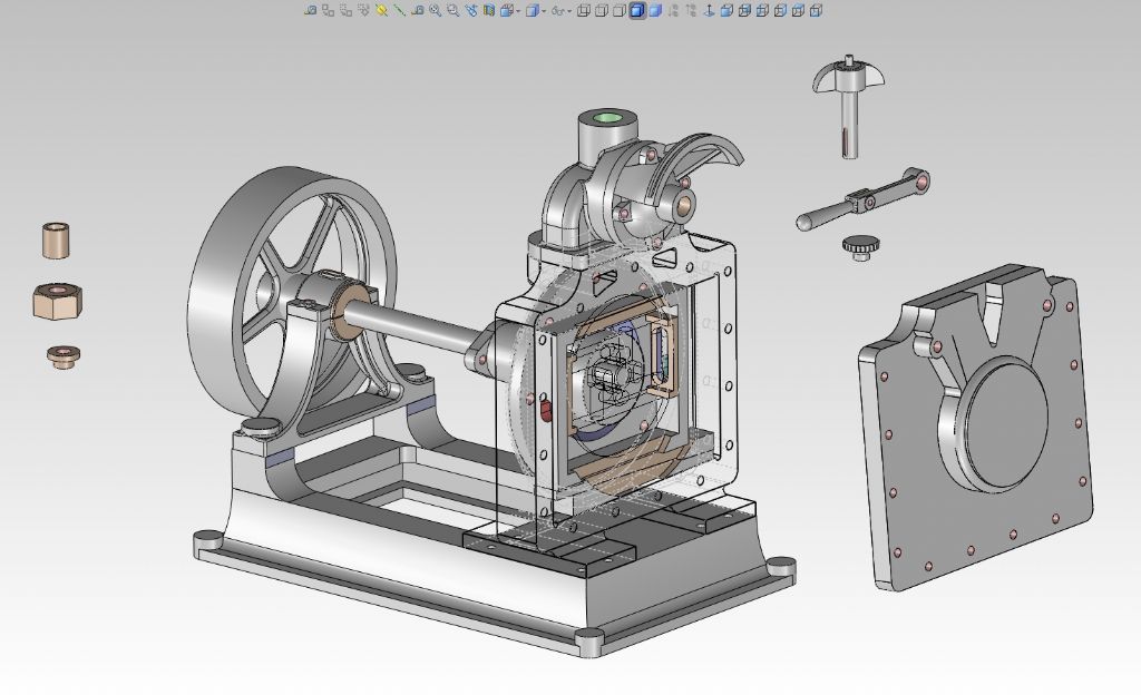

            This is the Dake 3D model I created a few years ago.

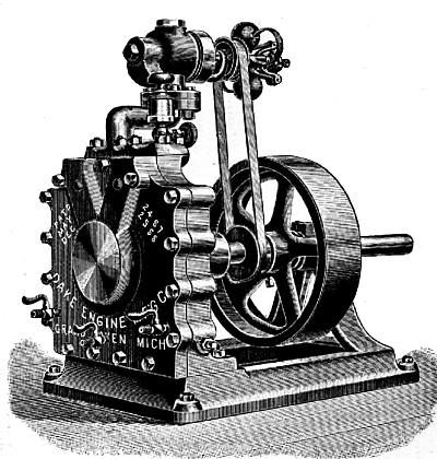

                dake_engine_photo.jpgAnd a Dake engraving that seems to be very close to the Dake I purchased.

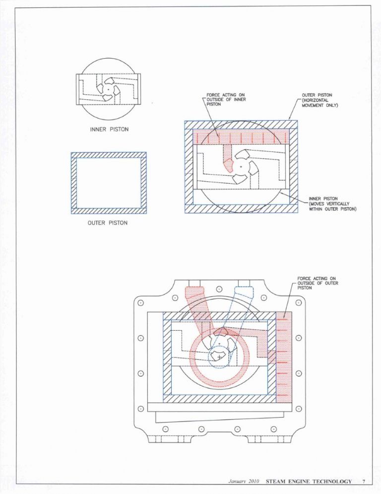

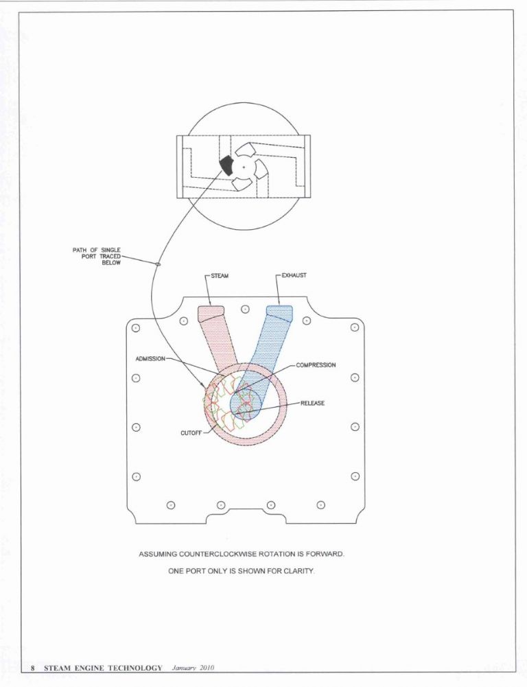

                  It took me a long time to figure out how this little engine works, and I actually had to disassemble my dad's engine and study it for quite some time.
                  Here are a few sketches I created in order to understand this engine.

                      Thanks for the explanation of 'how it works'. Still wrapping the grey matter round it but I'll get there.
                      I wonder what clue/need led the original designers to the engine layout? I now know it was compact and powerful, maybe suffered a bit from steam leakage and used about 100psi (…is that a typical pressure for the day?).

                            I have heard some describe this engine as a Wankel-type affair, but I think a Wankel had a single rotor, or perhaps a couple of rotors in line.
                            The Dake has a piston inside of another piston, but otherwise the pistons get pushed from the top and sides, similar to how a Wankel works, sort of.
                            The clearance between the crankcase cover and the pistons was controlled by using stacked gaskets, perhaps each at 1/1000 thick.
                            I don't think leakage was a problem.
                            There was no adjustable cutoff, and so this would not necessarily be an economical engine to run at full speed continuously, but as a specially adapted engine that required quick reverse and no dead centers, it is an exceptional design.
                            These engines run extremly smoothly, and make an odd slushing sound when they run.
                            No doubt they make perhaps a constant torque as they revolve, similar to a 3-phase electric motor.
                            They were advertised as having only three moving parts, which is almost true.
                            The flywheel, crankshaft, crank disk, and crank pin are considered on part (assembly).
                            The inner piston is the second part, and the outer piston and its two shoes are the third part (assembly).
                            From a parts count, it is an absurdly simple design.
                            From a theoretical functional standpoint, the engine is pure genius (the genius of Roots originally, modified a bit by Dake).
                            The inner piston is also a rotating multi-port slide valve.
                            I find this a fascinating engine, and for me to find one on ebay is sort of like finding the Hope diamond laying out in the front yard. I have never seen one of these engines for sale.
                            The totally enclosed design is a turn-off for some, who like to see the moving internal parts of an old engine.

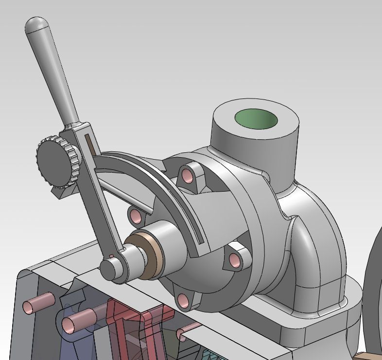

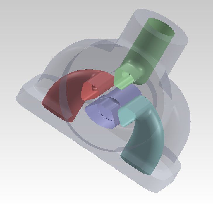

                                              The Dake reversing valve works similar to how a Westinghouse locomotive brake control works.

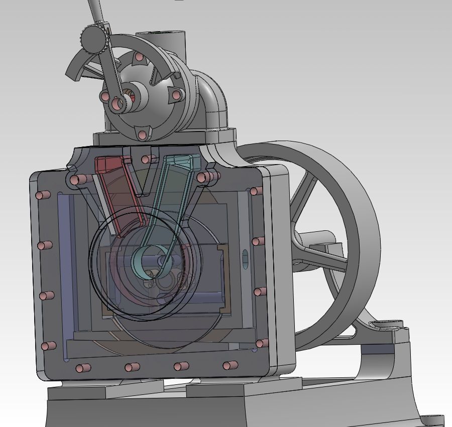

                                                  Here is the inside of a Dake.
                                                  This fellow is actually a decendent of the original Dake guy.
                                                  The way the engine works is that steam is pushing the outer piston side-to-side, and pushing the inner piston up and down.
                                                  The center piston has the crank pin through its center.
