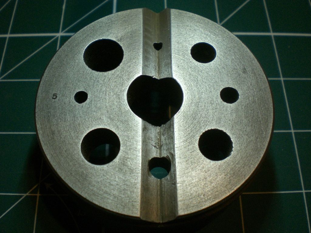

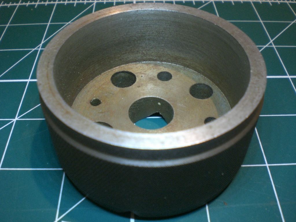

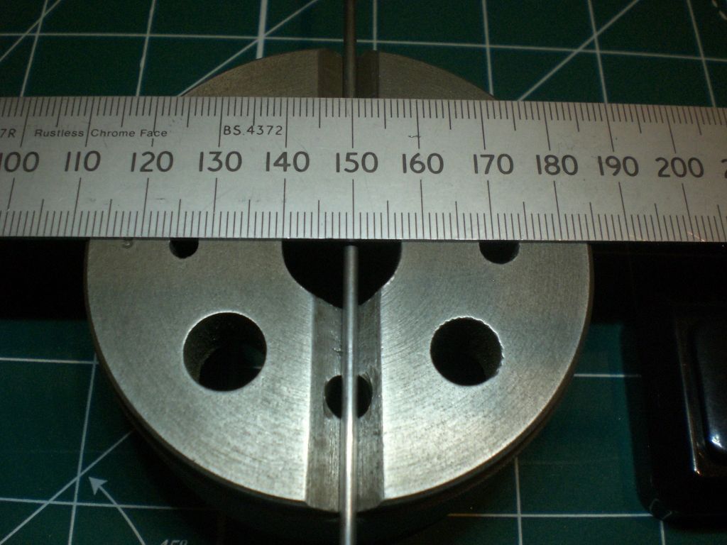

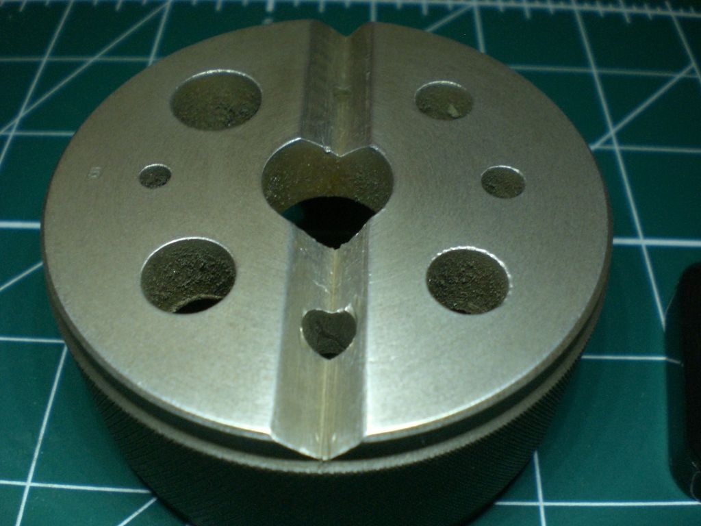

                                  Hi, the one I have was given to me by a work mate at my last day job, it was given to him by an old boy who made clocks, along with some other tools, he had no use for this block.
                                  The two holes in th V are in the centre of the crux, the V being 95 degrees inclusive with the side on the left being approx. 8mm deep and the side on the right being 7mm deep. The V is approx. 2mm offset to the right of the block by approx. 2mm and is approx 4mm deep and the large hole, for arguments sake, is in the centre of the block. I've found no manufacterers name on it but believe it to be a commrcially made item and there is a small number 5 stamped into the top face on the left hand side.
                                  As can be seen in the above photo, the block is hollow.
                                  Regards Nick.
                                  Edited By Nicholas Farr on 26/12/2019 09:53:29
                                  #443320
                                    Thanks for sharing the photos, Nick
                                    That looks entirely adequate for the general use that most of us would find for it. yes
                                    The Starrett one, however, does appear to be in a different league; being hardened and ground.

                                        The patent explains why the block is hollow – it's to trap knocked out pins. Good idea – I've spent many unhappy hours looking for small parts escaped on to my garage floor.
                                        I don't use my block often. Nuts and bolts, clips, rivets and spot-welds are my main challenges. Apart from model engines, I suppose pins and dowels are more common in firearms and jewellery than the stuff I play with.
                                        Ironic to find UK purchasers paying good money for offset hole blocks designed to facilitate dismantling Colt 1911 Automatic Pistols! Not many of them round here…
