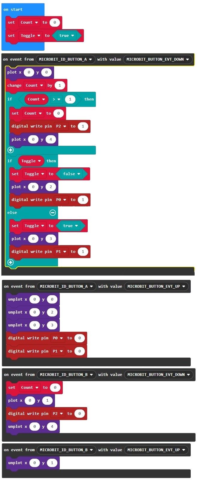

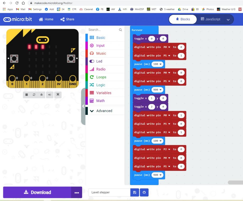

                                        Hi Dave
                                        The code is actually pretty trivial, especially when you see it in the "block code" format. It is printed in part 3 of the series (just out) but unfortunately it is a bit of an eye chart, so I have uploaded Photo 21 and Photo 27 (the two block code programmes from the article) to one of my albums so people can access it more easily. Also inserted below.
                                        In principle you could indeed extend the code to allow a digital display and I did consider doing just that, but as you rightly observe, the issue isn't displaying the current time, it is setting the initial time, which takes much more effort. Not clear to me whether this would tax the capacity (memory-wise) of the micro:bit but it could easily be off-loaded to a second processor if need be.
