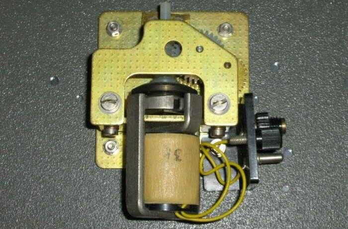

      Is the rotor 2 pole or 4 Duncan?
      #536276
      John Haine
        @johnhaine32865
        Another photo gleaned from the web.

          duncan webster 1
            @duncanwebster1
            4 poles as far as I can see, then 30 teeth on the white wheel gives 1:4*30 = 1:120 reduction to drive minute hand at 30 second intervals.

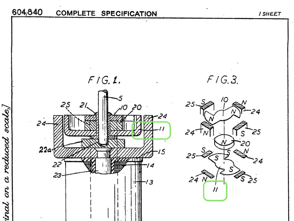

                  #536435
                    Gents [no pun intended] …
                    Did you look at the original French patent that I linked yesterday ?
                    Lines 18 to 20 on page 2 read:
                    Les fig. 8 à 10 représentent un petit
                    mouvement de récepteur horaire du type à
                    émissions inversées toutes les 1/2 minut;
                    … which translates to:
                    Figs. 8 to 10 represent a small
                    clockwise receiver movement of the type to
                    reverse transmissions every 1/2 minute;
                    … and I think those figures are worth a look.
                    Edit: __ here’s a bonus : I think this is Gent’s patent describing the essence of Duncan’s motor
                    https://worldwide.espacenet.com/patent/search?q=pn%3DGB604840A
                    Edited By Michael Gilligan on 26/03/2021 23:44:38

                      Posted by duncan webster on 26/03/2021 11:27:15:
                      Here's a couple of pictures of the Gent's, definitely 4 pole and 1/4 rev per pulse. The white gear is driven by a worm on the motor shaft. It is very quiet
                      Duncan – any chance of posting a dimension or two, for example the dimensions of the U-shaped pole piece or the coil, so I can get an idea of the size of the components?
                      #536463
                        Posted by Michael Gilligan on 26/03/2021 23:13:16:
                        **LINK**
                        As the saying goes : You can lead a horse to water …
                        Edit: __ Yes … it includes some relevant dimensions
                        Edited By Michael Gilligan on 27/03/2021 09:11:53
                        #536465
                        Tony Jeffree
                          @tonyjeffree56510
                          Posted by Michael Gilligan on 27/03/2021 08:59:29:
                          **LINK**
                          Yes, saw that, thanks, but no dimensions that o could see…?
                          #536466
                            Posted by Tony Jeffree on 27/03/2021 09:08:53:
                            Try going to line 10 on page 3, Tony
                            #536473
                            John Haine
                              @johnhaine32865
                              The magnet is a disc 5/8" dia and 5/32" thick. Everything should scale from that.

                                                    #536654
                                                      Posted by John Haine on 26/03/2021 12:48:48:
                                                      I’m having some difficulty interpreting the ‘perspective’ sketches in the patent …
                                                      it is reasonably clear from this photo, and from Fig.1, that items 10 and 11 are cut from a closed tube shape … but Fig.3 and Fig.4 [which purport to clarify things] appear to show them cut from flat plate.
                                                      Is this an over-simplified sketch, or an optical illusion ?
                                                      … what do they really look like ?
