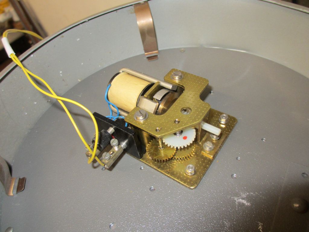

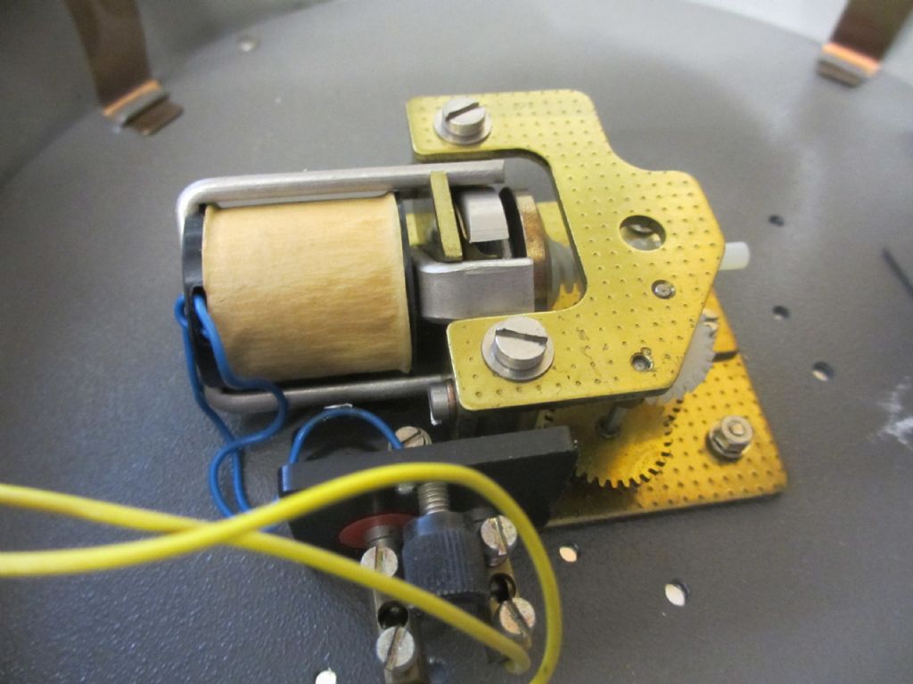

                                      Not easy to see without taking it apart but I suspect the gents has an axial magnet with steel pole pieces. This could be achieved using a number of small magnets rather than one polo mint. Can also give more than one pair of poles. A non magnetic axle through the middle would avoid short circuiting the field

                                                  Here's a couple of pictures of the Gent's, definitely 4 pole and 1/4 rev per pulse. The white gear is driven by a worm on the motor shaft. It is very quiet
