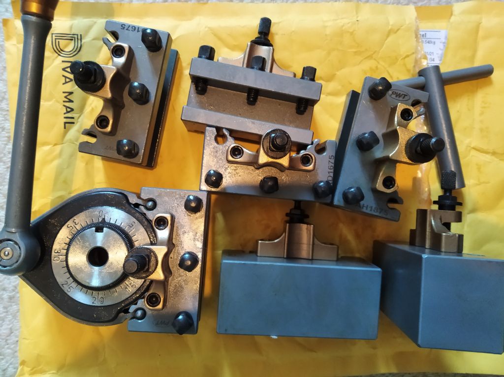

      The tool holders are all stamped with the W or M so this probably shouldn't be seen as a mark of age or originality.
      My understanding is that the 'W' holders were made by a particular sub-contractor in the south-west. I got mine in 1997, is there any chance that yours were old stock ?

        I was lucky that some kind soul at an exhibition alerted me to the fact that there were variations. Just having looked at my stock of holders purchased at least 20 years ago they are all marked with a "W" and fit perfectly. But I agree with Martin C., a vee and a flat has always been the way to go with lathe ways so why not with tool holders ? I can't agree with Bazyle, as to my mind, fitting on the inners or the outers of the vees creates part of a near cylindrical surface where positioning would be dependant on mating and angularity of very narrow flats. Quite easy to clamp down in a variety of positions. I await the protests!

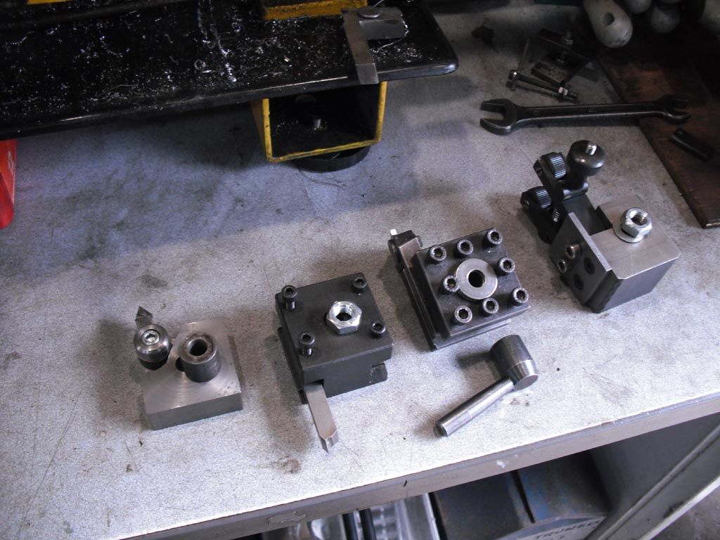

            When I purchased my Boxford Industrial Lathe it had the original Boxford branded Dickson tool post and 2 holders, one standard and one a part off tool holder.
            I had a look around for extra holders and came to conclusion that to buy OE parts I'd most likely have to source them individually on Ebay at £50 to £70 each with individual postage, so it would have turned in to a very expensive addition.
            I decided to just buy the Multifix size A tool post as any future tool holders could be bought new with a guarantee of fitting for less money than OE Dickson holders sell for second hand.
            My Multifix order was about £400, someone offered me £100 for the original Dickson and 2 holders, so it only set me back about £300 to upgrade to a Multifix set up.
            PeWe multifix
