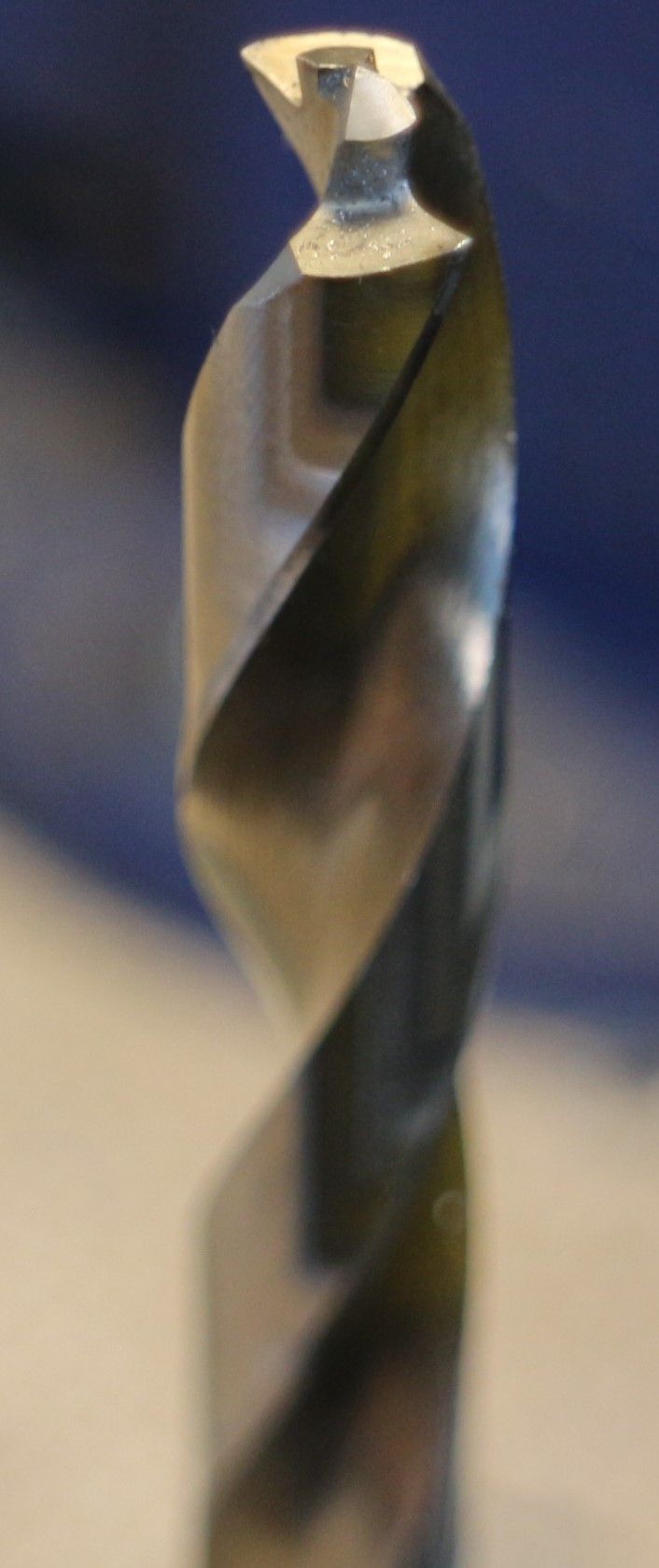

              Here's a couple of photos of the pilot point drills I mentioned earlier.
              A/k/a "proline bullet drill". Here on eBay. Power Tools Direct Homebase seem to have sets. DeWalt also have a version. You can see how the pilot point projects from the flat-ended cutting edges and is split to give a fine point for starting. The last significant job I did was a transverse on-diameter hole through 2 inch stainless bar, 10mm diameter, done in one go. A 10mm ground steel bar was a tight sliding fit in the hole afterwards. Highly recommended.
