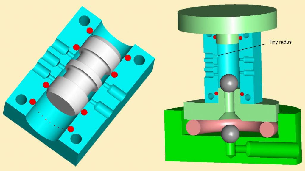

                                This posting could be titled – How I de-burred the tiny holes in the PMM valve bodies.
                                Just to back-track a moment, the inside bore of the PMM valves had a honed and highly polished finish. That was eventually my minimum standard. Where the five 1.0mm holes broke through however, the best result was a sharp corner, while the worst was a burr. Clearly, the PTFE spool would be damaged if this condition prevailed.
                                The solution was quite a simple idea really, and one which Pekka alluded to in his earlier posting above.
                                The solution – Use a particulate slurry, and flush this backwards through the holes.
                                But, what sort of equipment should I use to achieve this? What sort of particulate material would be most suitable?
                                I settled on tripoli as the preferred powder, and I presumed it was the same stuff found in liquid metal polish. It was cheap and could be mixed with water, so the PMM was safe from solvents. I added a very small amount of wetting agent to help to disperse the powder in the water, while avoiding a severe dose of the froths.
                                The mechanism was fairly simple too. I had an old washing machine motor and added a large ball race to the shaft with about 5mm eccentricity. This eccentricity was to produce my up and down movement. A couple of polypropylene (PP) adaptors suitably spigoted to locate into the bore of the valve body closed off the bore, one of which was drilled through to allow the slurry to pass. A simple ball valve sitting inside the bottom adaptor ensured a reasonable one-way flow of slurry. A stubby length of RPVC about 40mm diameter formed the body of the contraption, while providing a miniature priming tank for containing the slurry.
                                The tricky bit was still to come, ie. how to make the pumping action take place without too much leakage?
                                As I recall, this came in the form of a couple of rather chunky `O’ rings roughly the same diameter as the RPVC tube and about 6mm in cross section. Besides helping to form a seal between the tank and the outside world, there was sufficient `give’ in the `O’ rings and the rest of the contraption for the eccentric ball race to generate a pumping action. In other words, to squash the assembly up and down, forcing the slurry through the tiny holes.
                                Fifteen minutes of this while I carried on with something else, and the job was done.
                                It took a low power microscope to view the beautiful radii which had replaced the burrs and sharp edges on these largely inaccessible places. Although I’ve searched amongst my old samples to provide a picture, it would appear that they have all been dumped during successive moves.

                                      #70283
                                      Sam Stones
                                        @samstones42903
                                        Gentlemen,
                                        In response to a couple of questions about my de-burring technique, especially from Pekka, I cobbled together a couple of schematics from what I remember. It was, after all about 30 years ago.
                                        Michael Williams has reminded me also about the fluidics phenomenon, which I seem to recall involved Enots. However, I hadn’t realised that the valves mentioned could cope with liquids besides air.
                                        In my diagrams, you can see the basics of the valve, and the method I used to pump the tripoli slurry through the valve ports. The slurry was gravity fed into the bottom RH drilling, while the two balls controlled the direction of flow.
                                        However, while there are a couple of notes with this picture, I hesitate to go into specific detail unless anyone has additional questions.
                                        Regards to all,
                                        Sam
                                        PS My skeleton clock is now running well with previous over-night errors of about 2 seconds per hour fast. After todays adjustment, the last (three-hour) time check, revealed an error which was too small to record against my computer clock.

                                        #70348
                                        MICHAEL WILLIAMS
                                          @michaelwilliams41215
                                          Hi Sam :
                                          Looks like you’ve done some very nice work again ! It’s always a pleasure to see work which has actually had some thought put into its design and making .
                                          Fluidic devices can be made in principle to handle any fluid whether gas or liquid but the detail design of each device is different . Any one device can’t usually handle both . The main application was as you suggest with air systems . Don’t really know why Fluidics was pursued beyond the academic study level because though it’s a very interesting subject Fluidics doesn’t actually seem to do much that can’t be done by more conventional means .
                                          MW

                                            #70371
                                            PekkaNF
                                              @pekkanf
                                              Thank you Sam. I enjoyed the the diagram. I’ll definately keep thin in my mind, because I sometimes have to come up with a cunning plan to avoid getting into too big pile of er…fluiddynamics.
                                              I have some small trough cooled tools. I’m thinkking of using an old espressomachine pump and if that does not work I probably have to make peristaltic pump. Small flow, but few bars are needed.
                                              Those fluid dynamic components were primary designed before to conditions where silicon based electronics didn’t travel well. Like temperatures of few hundred decrees, nasty atmosphere, radiation, strong electromagnetic phenomenons…you’ll get the drift. Models were made out of plastics, but real world stuff was different.
                                              Now, there are radiation hardened IC:s and some that will manage a little elevated temperature, that sort of ate their lunch.
                                              Pekka
